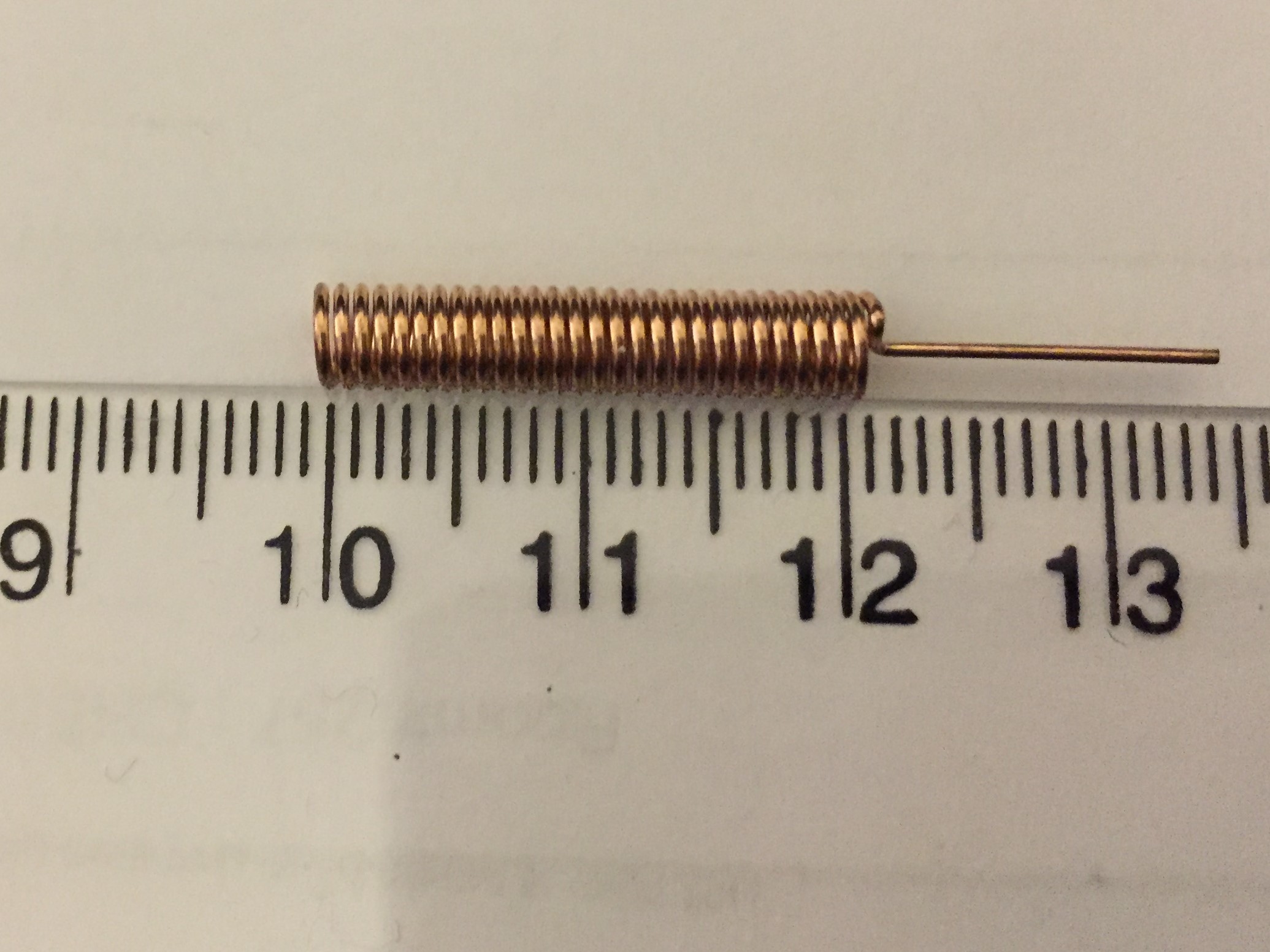

        @mfalkvidd thank you for quick reply. any chance of no signal after 20ish meeter (just outside the house) related to same issue?

            adding following line to sketch fixed the reboot issues for me, but signal problem is still here :(
            #define MY_RFM69_NEW_DRIVER```

                First Test:
                Gain:2dBi-3dBi
                Wire diameter:0.6MM
                Spring outer diameter:5MM
                Total Length include soldering part: 34MM
                Coil Turns: 28
                Range around 20 to 30m while gateway was inside house.

                  First Test:
                  Gain:2dBi-3dBi
                  Wire diameter:0.6MM
                  Coil Turns: 28

                  @pihome Whereas I understand the desire for physically short antennae for aesthetics or to fit within a specific case size, the trade off is always reduced performance even with a perfect ground plane. All my 433 MHz antennae are shrouded screw-ons of length 110mm, easily getting 50m+ comms from inside a RC/masonry building on standard power RFMs.
                  Your final question looks to tweak the transmit power to overcome this compromise, ignoring receive gain being unaffected.
                  Perhaps you might rethink at least the Gateway antenna to establish working comms at the hub, then figure out how to disguise it later.

                    i was expecting bit more range with 2dbi antenna, you are right i have to put better antenna gateway.
                    are you referring to
                    MY_RFM69_TX_POWER_DBM in sketch? on same note
                    what would be different between MY_RFM69_MAX_POWER_LEVEL_DBM and TX_POWER, i have tried MY_RFM69_MAX_POWER_LEVEL_DBM to 100u but made no difference in range.

                      @pihome I wouldn't hold much store by claimed/calculated gain, it is a minefield... eg the 110mm whips referred to earlier are commonly referred to as 2dBi, quite a bit shorter than the theoretical 170mm quarter wave.... But crucially, they work flawlessly, on standard power modules, to 50+m, through structures.... Have not yet tested one in the below ground pump chamber, but would not be surprised if it worked.
                      Although tempted to play with the auto-power facility on the RFMs when it was made available on the newer driver version, since the reduced erp would have limited impact on battery life, didn't pursue it.
                      I would suggest seeking to increase power to overcome receive limitations MAY lift the signal out of the mush, but would not make for stable comms..
                      Others here are better able to advise, but I vaguely recall a portable RSSI test setup having been outlined. So going back to a question from my first post, perhaps a couple of pro-minis so set up with differnent antennae would yield clues toward a solution.
