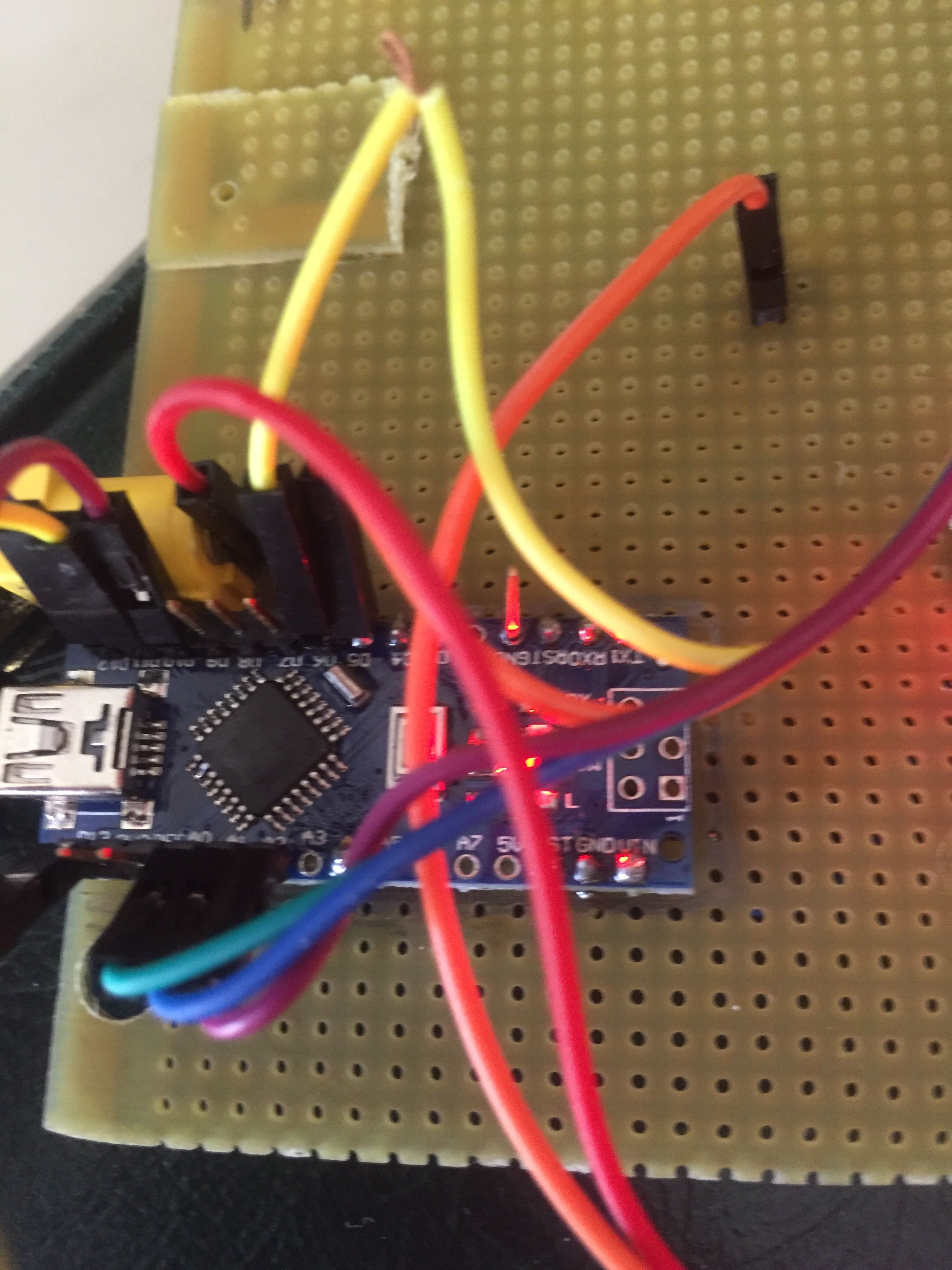

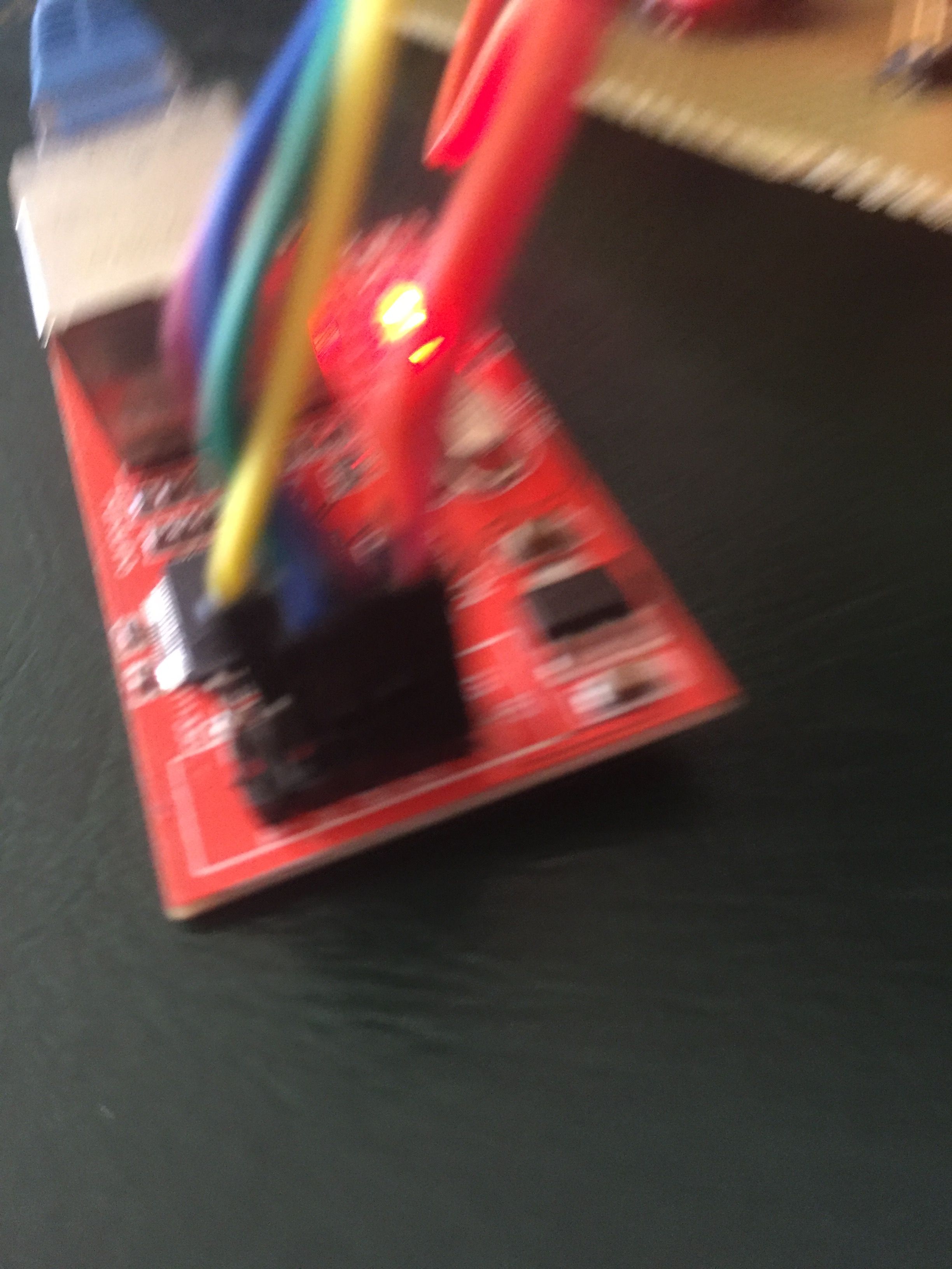

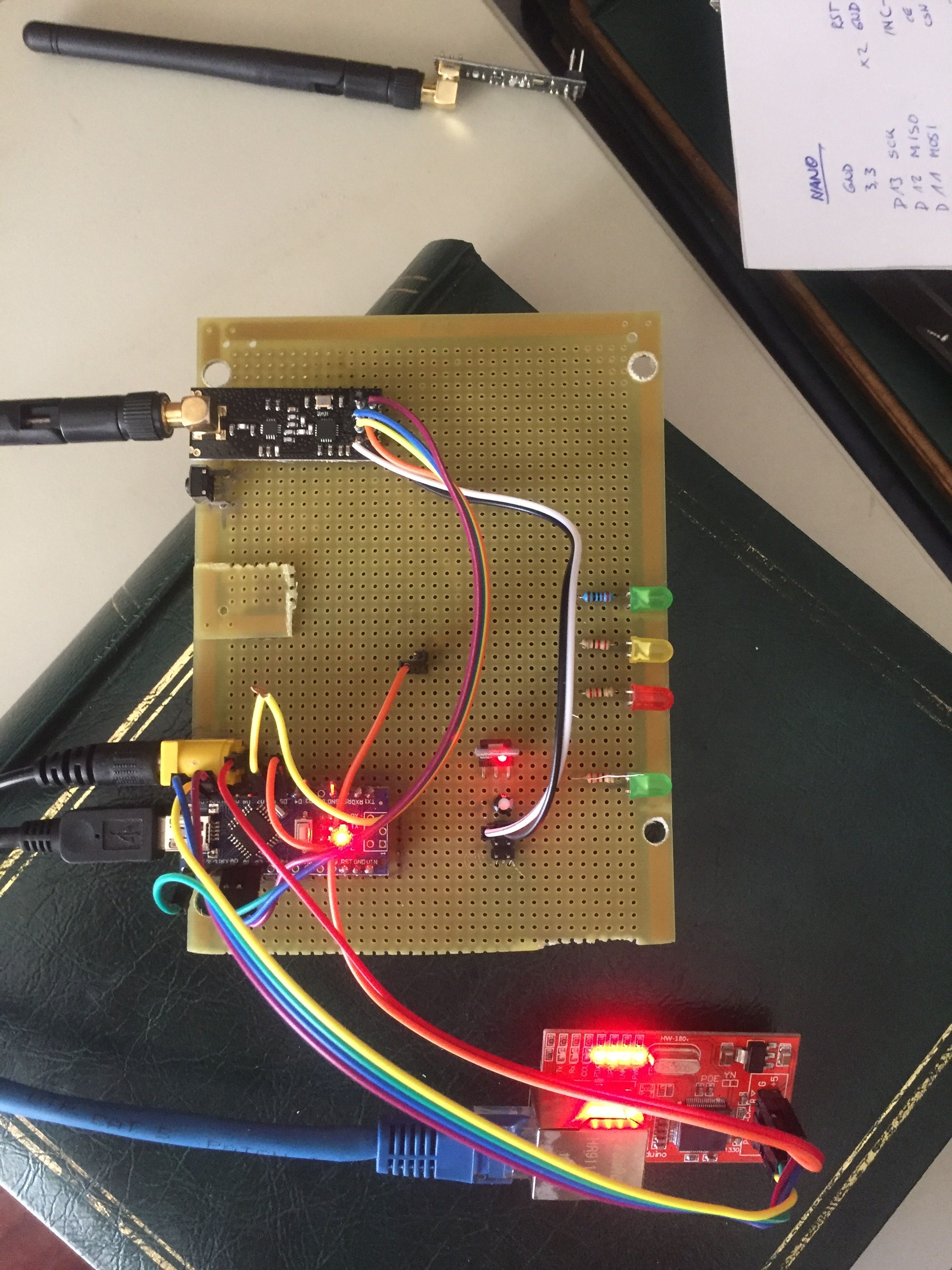

    i built the following:

    but nothing:
    • can't ping to it.
    • arp -a shows the address, but no the mac.
    ANy hint?

      For some reason the Gateway uses IP=255.255.255.255 (which is not a valid IP address) instead of the one you specified.
      There is plenty of free ram after compiling the sketch, so ram shouldn't be a problem.
      There have been a few similar reports earlier. https://forum.mysensors.org/post/82366 seems to be the only one that has a suggested solution.
      Which version of the Arduino IDE and which AVR board version are you using?
