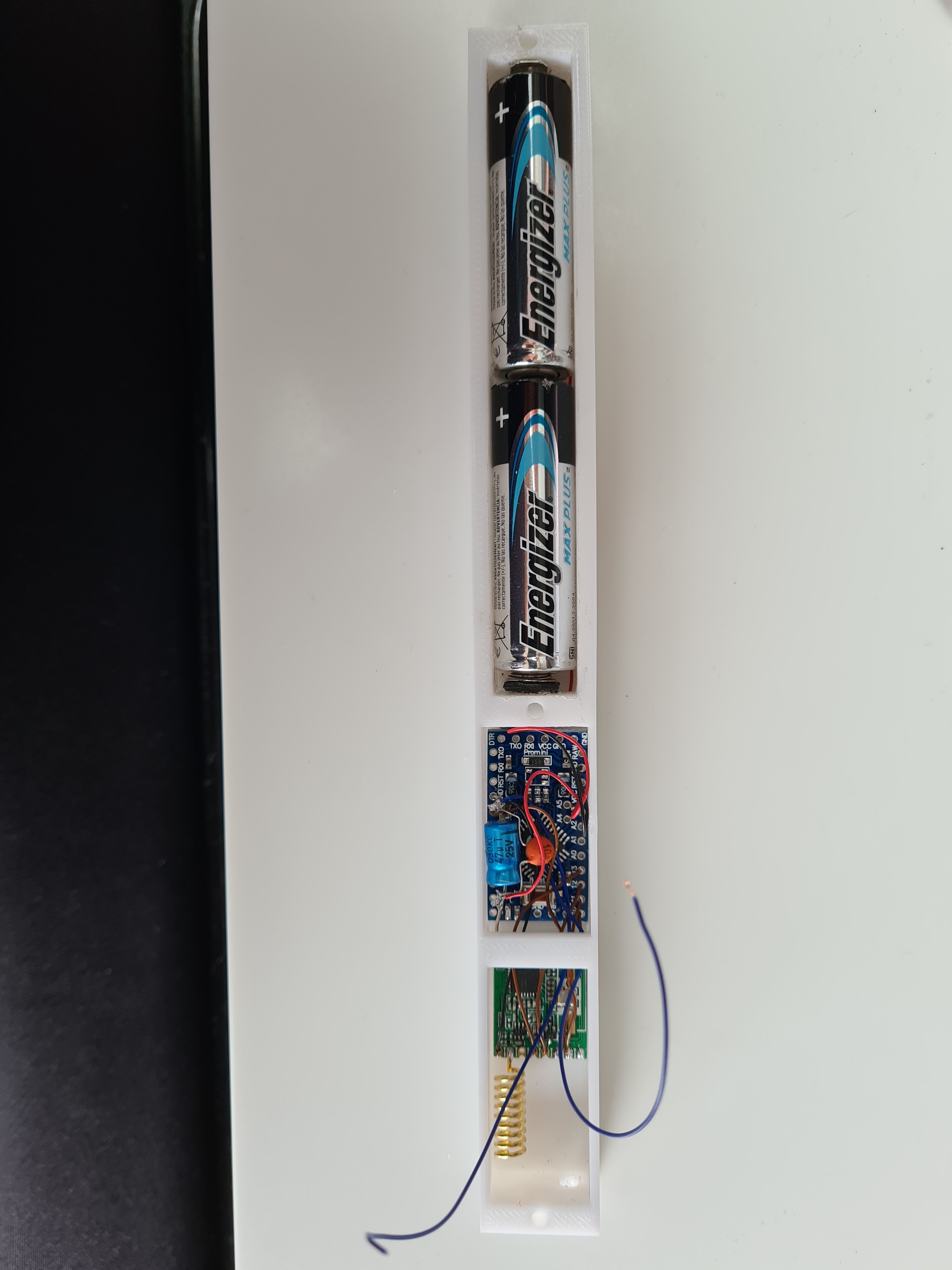

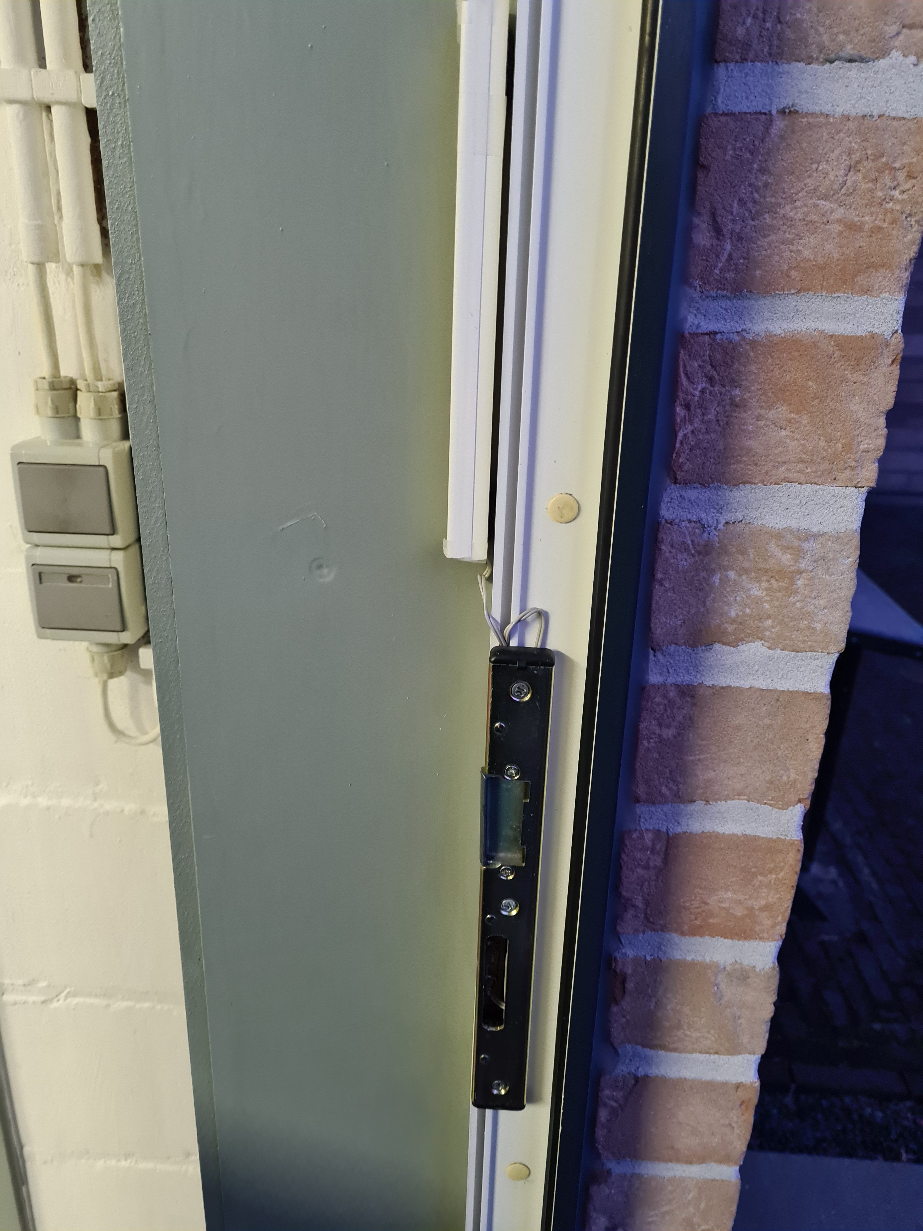

    The trigger to start this project was remarking, for the umpteenth time in the morning, that the door had been unlocked again all night.
    Replacing the mechanical locks on the 4 doors by electric locks was out of the question, too expensive and the need for electric cables that were not present.
    So, how to detect if a mechanical lock is closed?
    The internet is an incredible source of ideas:
    https://community.home-assistant.io/t/how-i-made-my-dumb-locks-a-little-smarter/55174
    https://community.home-assistant.io/t/i-made-a-simple-lock-sensor-with-xiaomi-door-sensor-some-battery-holders-and-a-soldering-iron/49445
    With this idea, let the bolt close a contact, I could use the standard window/door sensor node!
    So I made my version by using springs I found in my junk bin mounted on a piece of wood, namely the wooden stick of an ice cream 😊
    My first prototype was working, but not really a piece of art ☹
    Remember to always drill holes because the wood of the stick splits very easily.
    I did use battery springs for my other nodes, they are stronger and easier to use.
    The battery-based windows/door sensor node : hardware
    I had never built a battery based node before, so as a first step, I did read the site article on the MySensors site: https://www.mysensors.org/build/battery
    Luckily, I already had Pro Mini's and enough RFM69HW radios in stock.
    Today I know that I did probably the wrong choice by using the Pro Mini’s. They are good in low consumption, but a bare bone 328P used like in this topic https://forum.mysensors.org/topic/2067/my-slim-2aa-battery-node is still better...
    But we will see how far these Pro Mini’s will take us on 2x AA batteries!
    My first node was based on the idea to use the same enclosure as in the above topic. In Belgium these cable ducts are known under the name Legrand and I had a still a piece of more then 1 meter lying around, a surplus from the renovations.
    Because I used a Pro Mini and not a bare bone 328P, I was obliged to use 2 covers of the cable duct instead of a cover and base. The base of the cable duct was not broad enough for the Pro Mini.
    With the hardware tricks of the MySensor battery node site article on the Pro Mini, I could obtain a current consumption of 133µA in deep sleep (Modified Pro Mini, RFM69HW and the open contact).
    To minimize the current with a closed contact, I did not use the internal pull-up resistor of the 329P (internal pullup resistor value around 30KOhm), but an external 1M ohm resistor. With closed contact and deep sleep, I have now around 136µA.

    The sensor is fastened with Velcro strips to prevent damage to the door caused by using fixing screws.

      @evb I wonder what the lock mechanism looks like. Is it a key? Or some knob that you turn around?
      How long did it take you to design the case?
        E Offline
        E Offline
        evb
        @canique The lock mechanism is a standard mechanical lock with a bolt and a normal key.
        When you turn the key for closing the lock, the bolt comes forward and pushes the two springs inwards, shorting the two springs.

                  We are approximately 2 years later, a little follow-up :-)
                  I had already noticed for a week of so that my 3 oldest sensors (including my prototype sensor) were no longer sending their status consistently. After checking the reported battery levels of the sensors I saw that there were around 50%, so that was normal... (50 % of 3V is 1.5V :-) , below the BOD of 1.8V)
                  So the sensors with this design worked for about 20 months on 2 normal AA batteries of 1.5 V, not bad :-)
