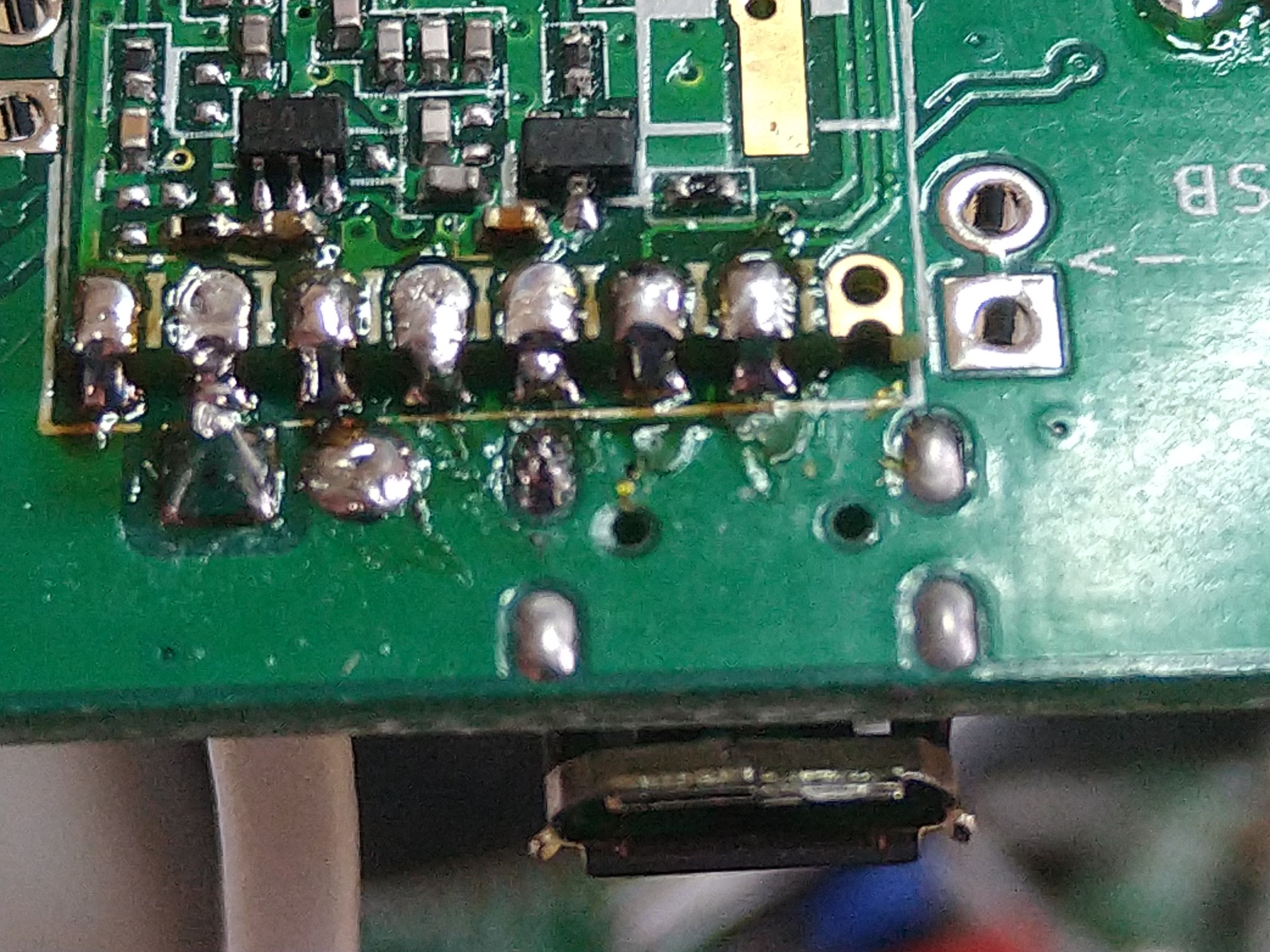

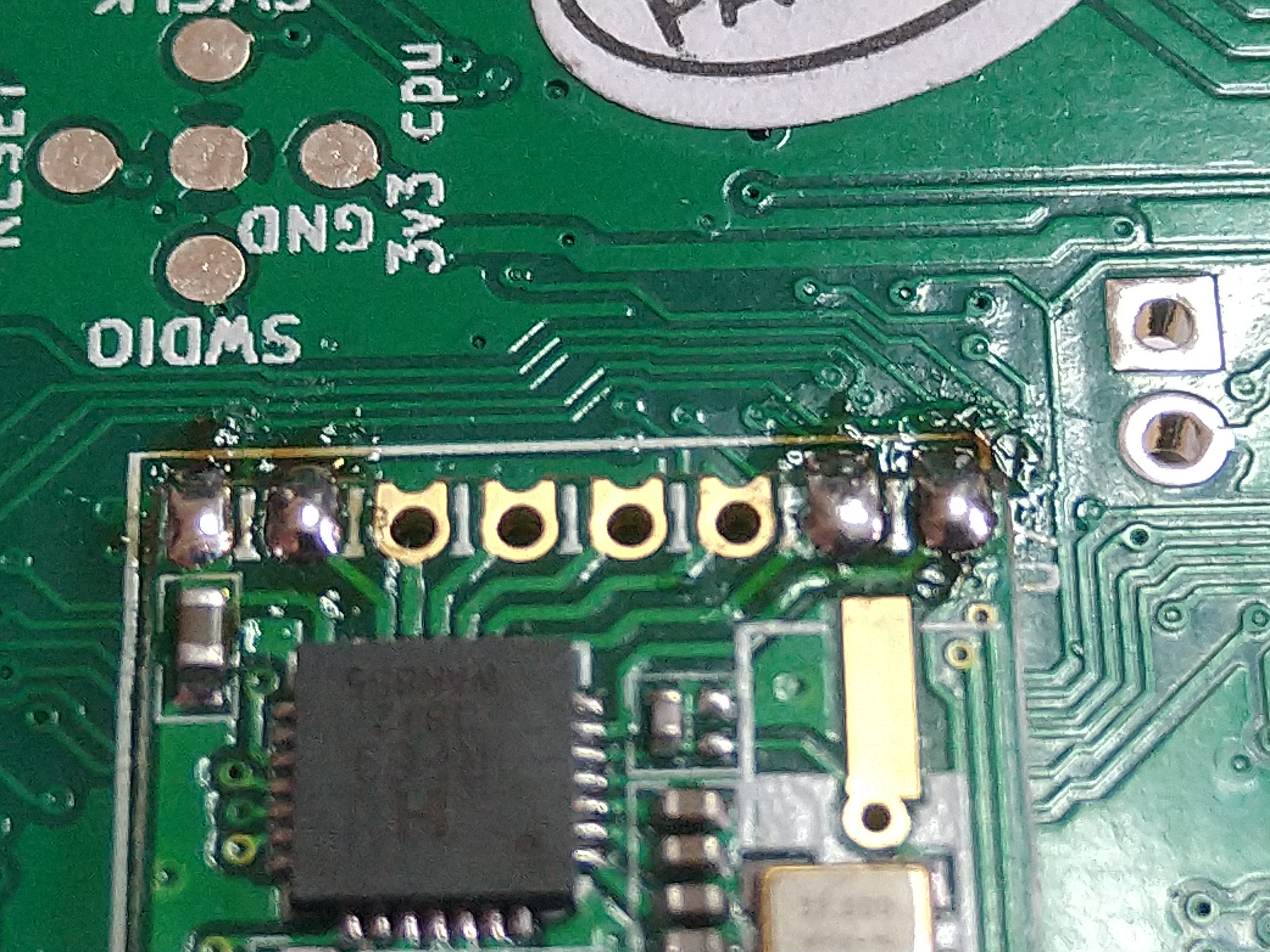

    Hi all,
    I have been using MySensors for 3 years now. I built my origional serial GW using a UNO, and utilising soft signing. All worked well for a few months at a time, but I ran into issues, as detailed here.
    I bought, built and installed a Sensebender gateway, and all was well for a while, However I seemingly killed it when I upped the MY_RFM69_TX_POWER_DBM (13) up to "20", in an effort to solve a troublesome node often not getting messages that were sent to it.
    I reverted to my home built UNO gateway, and ordered a new Sensebender Gateway, which has sat on a shelf for several months. I decided to assemble and make use of the "new" sensebender gateway today, fitting a new RFM69HW to the board.
    I have wiped it, personalised it, and uploaded the same GW sketch as previously used.
    It doesn't work! this is the output, which I put through the log parser, which also doesn't work?
    0;255;hu;0;hu;3 MCO:BGN:INIT GW,CP=RRNGSA--,VER=2.2.0
    0;255;hu;0;hu;3 SGN:PER:OK
    0;255;hu;0;hu;3 SGN:INI:BND OK
    0;255;hu;0;hu;3 TSF:LRT:OK
    0;255;hu;0;hu;3 TSM:INIT
    0;255;hu;0;hu;3 TSF:WUR:MS=0
    0;255;hu;0;hu;3 !TSM:INIT:TSP FAIL
    0;255;hu;0;hu;3 TSM:FAIL:CNT=hu
    0;255;hu;0;hu;3 TSM:FAIL:DIS
    0;255;hu;0;hu;3 TSF:TDI:TSL
    I reflowed the RFM69 Pads, incase there was a crack or otherwise faulty joint, to no avail, I joined SWC2, and that stopped at eprom.
    for completeness, here is the GW sketch. Arduino IDE is 1.8.13
    Suggestions?

      Use following for the log parser:
      SGN:PER:OK
      SGN:INI:BND OK
      TSF:LRT:OK
      TSM:INIT
      TSF:WUR:MS=0
      !TSM:INIT:TSP FAIL
      TSM:FAIL:CNT=hu
      TSM:FAIL:DIS
      TSF:TDI:TSL
      This will output:
      I would recheck the radio module connections...
      • N
        N
        Nigel31
        Solder sucked off all I could, have re-soldered, cannot remove the RFM69. Output still the same.

                      Nigel31
                      @evb
                      Sorry for the confusion, I mean the entire RFM69HW sub board.
                      The difficulty is that by the nature of the edge connections, and the "holes" the solder flows under the "pads" as well as to the sides, and given that there is no "flex" in the board, it isn't possible (at least on my attempts) to stop any pad from re-attaching to the main board. As I say, I had a go with the previous one, and damaged it beyond repair, removing the RFM69HW.
                      My solder station is a cheap temperature controllable one, with a circa 1mm round tip, solder sucking off the majority of the solder isn't able to freeup a pad. I have removed the solder and re-soldered this chip three times now, to ensure good connections, which is why you will see loads of excess flux, which I haven't bothered to clean off as yet, given the project isn't finished / working. I have tried getting the smallest, circa 0.5mm jewellers screwdriver under the edge of the RFM69 board, whilst heating the nearest corner pad, without success.
                      Photos below, as I say a bit of a mess with the excess flux, the continuity has however been proven to all the MCU pins.
                      The excess solder is due to the fact I attached wires to each pad, for the continuity checking, being as it is that the MCU chip is on the other side of the PCB.
                      The on sketch testing is definitely failing as mentioned above.
                      • E
                        E
                        evb
                        Sorry, but I'm afraid I can't help you any further.
                        If the tests in the sketch do not go any further, there is something wrong with the board itself...
