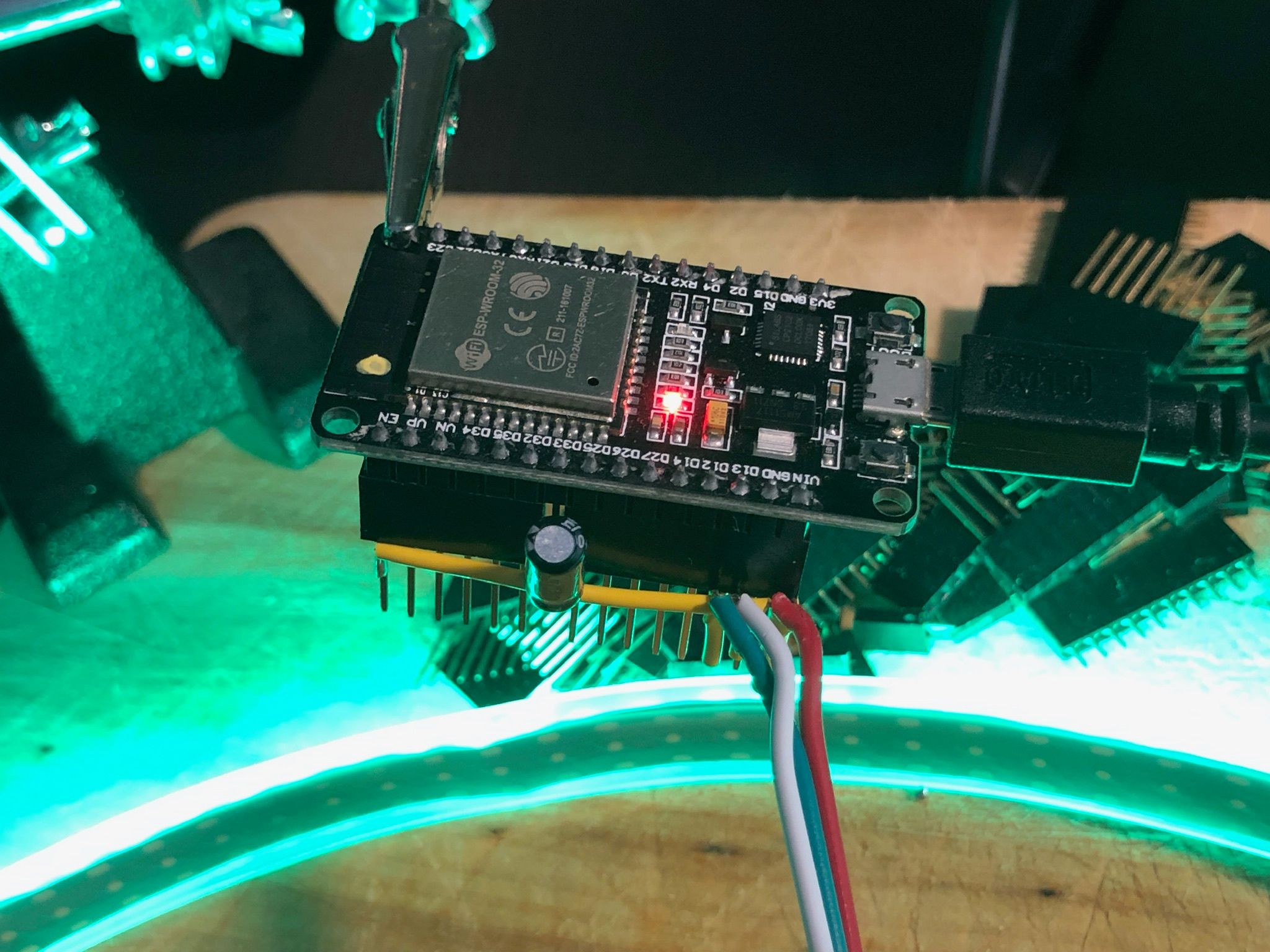

    My niece and I made a night light based on a halloween-themed candy jar. Color and brightness can be controlled by a mobile app. The app also has a "party mode".
    https://youtu.be/5taLjuKDS8k
    https://youtu.be/8ta27x0Obso
    The app looks like this:
    Hardware-wise, we used:
    • plastic skull with candy (eating the candy was a tough job, but someone had to do it)
    • esp32
    • rgb led strip
    • capacitor
    We put some fluffy cotton inside the skull to diffuse the light.
