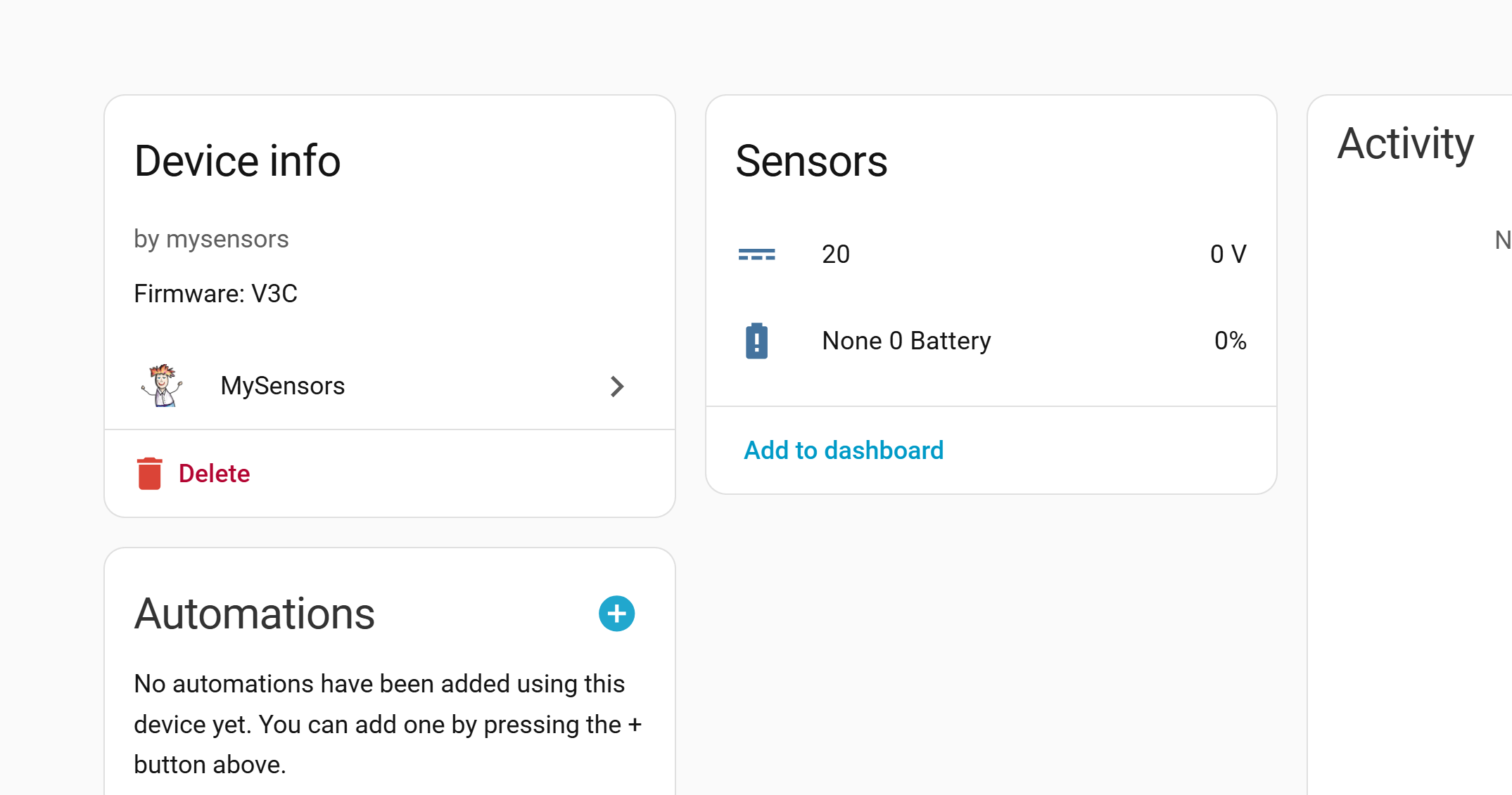

    I have built a HA rack mounted controller which consists of a mains psu which is connected to a 'psu pcb' which provides +5v +12v and 13.2v bat output. If the mains fails the battery will maintain all rails for about 2 hours. The 5v rail supplies the Raspberry Pi5 running HA and an arduino for the Mysensors serial gateway. I have built a similar system a few years ago with a domoticz controller and was able to monitor the supply rails using the A/D inputs on the gateway.
    Problem is that the sketch used in Domoticz doesn't work with HA so i have re-written it following the advice from the HA mysensors page https://www.home-assistant.io/integrations/mysensors/
    I have written this latest sketch to display 1 supply rail (not defined) and it appears in the Mysensors integration in HA only problem it is 0.00. see pic ('20' is the child ID)
    I am using an Arduino Mega for the gateway which works fine and hope to add an LCD display later (the earlier domoticz version also has one)
    Can someone clever see where i have gone wrong?

      Update. Duh. I see you are getting the voltage to HA (20 0V ). So maybe ignore my original post.
      In your presentation function, you present CHILD_ID twice. I think you just want to present it as S_MULTIMETER. Delete the V_VOLTAGE from presentation. Your MyMessage msgVolt declaration tells it that it is a V_VOLTAGE.
      Not sure if this is the fix, but it is probably not correct as is.
      • nagelcN
        nagelcN
        nagelc
        wrote on last edited by nagelc
        That None 0 Battery is the battery percentage from sendBatteryLevel(), which you aren't using in your sketch. You should be seeing an entry for the voltage you are sending besides that one.
        Your message output indicates you are sending 0.00 for the voltage. Check the output of float batteryV = sensorValue * (4 / 1023) * 2; with a printf. If it comes out as zero, double check the sensorValue. Also check 4/1023. It would be zero if processed as an int. try 4.0/1023.0 and see if that helps. Even as a float it is a very small number. sensorValue would need to be about 128 for it to register as a 1.
        I've had some challenges with floats and ints in the past -- admittedly not an expert. I should actually learn how arduino handles them : )
        Update: Duh I see it. 20 0V. So ignore what I said about None 0 Battery. You are sending 0V however. See below.

            Thanks for the quick response, I have removed the second V_VOLTAGE and added the .0 to the sensorValue line, this did not fix the problem. I took your advice and serial printed the lastVolt, batteryVolt and sensorValue. I need to work out why but the lastVolt reading is correct so i have sent 'send(msgVolt.set(lastVolt, 2)); ' this to the gateway and this now works. Need to think about this a but more. By the way that parsor is really useful i never knew it existed. Thanks for all your suggestions!
