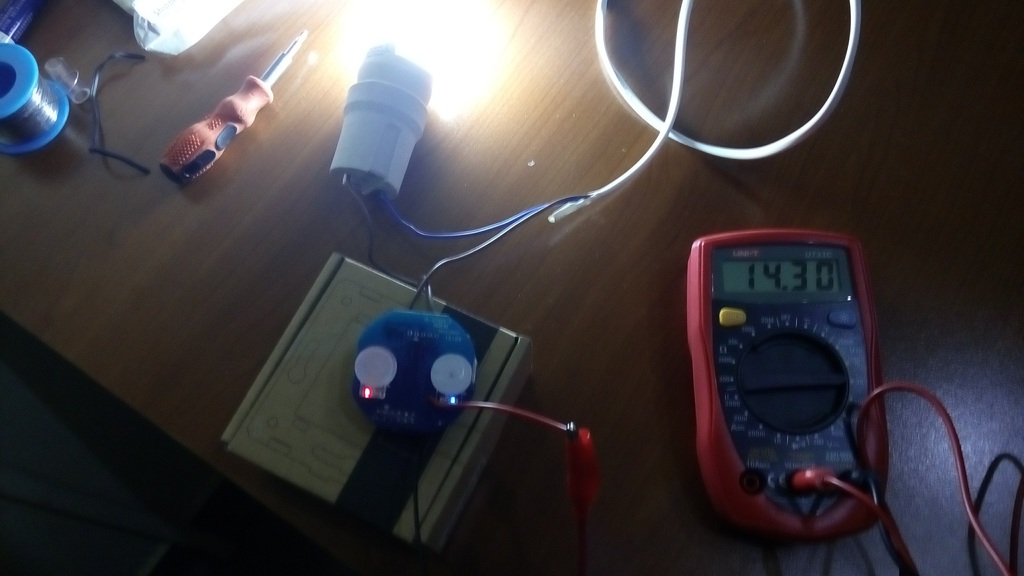

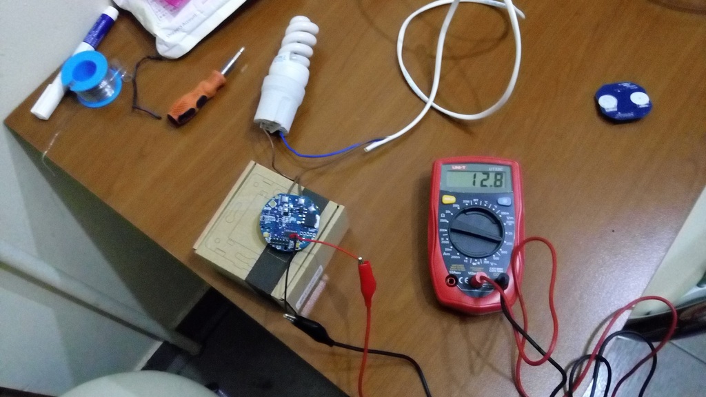

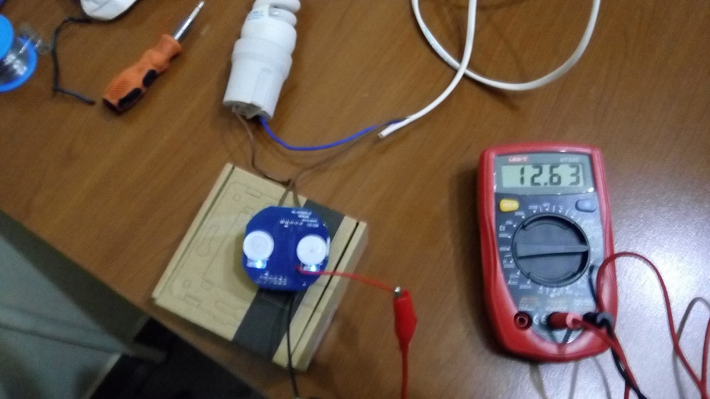

    Ok some updates to follow:
    performed first tests on the switch power supply/relays board and the results are very promising so far as you can see here
    1. switch is OFF: the so called 12V line gives us 12.63V
    2.switch is ON: the so called 12V line gives us 14.3V
    1. switch power supply/relays board ONLY(without the front plate): 12.8V
    2. a closer look at the switch power supply/relays board and wiring for the unregulated 12V input
    3. switch power supply/relays board with attached dc-dc step down converter for ~3.3V output
    The above scenarios were tested with and without the front plate and I achieved the same and constant results on the dc-dc step down converter output: a steady 3.25V(as I managed to get by adjusting the on board trimmer). The DC-DC step down regulator is a cheap one bought from aliexpress which does the job pretty well.
