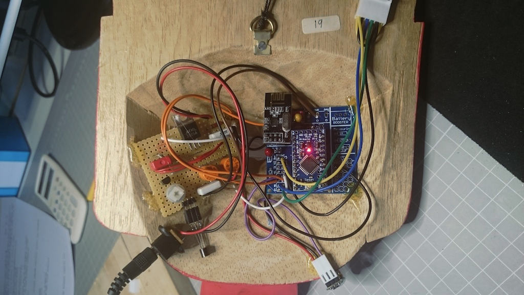

    I have built an intrusion detector that also measures barometer pressure and indoor and outdoor temperatures.
    The pressure and indoor temperature is measured by a BMP280 and a number of DS18B20 sensors can be connected to measure the temperature in remote locations.
    When movement is detected two red LEDs flash during 20 sec.
    Everything is built into a frightening wooden mask, bought in Indonesia. The LEDs poke out through the nostrils.
    Here is the sketch:

    and here are a couple of photos, front and back:
    ![alt text](0_1487498680609_upload-7deee0a5-263a-42b0-989a-55d1aae32cf4 image url)DSC_0669 (1).jpg
    ![alt text](0_1487498717047_upload-cd76f838-04f6-4fab-a4b8-e37823a7419c image url)DSC_0668 (1).jpg
    I have never been so busy since I retired!
