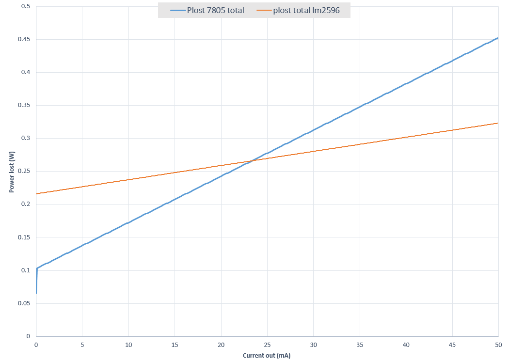

      I think you might have left out the LM2596 since the Nano linear regulator should be able to cope with 12V.

      @pansen I've burned out a couple nano's and pro mini's by supplying what was supposedly 12v from a wall wart.
      So I would advise using a linear voltage regulator

        @micah @gohan Yeah I could imagine nasty spikes from a cheap power supply can fry the regulator. I still find an LM2596 overpowered for this. At least take a 7805 :P

              @pansen Agree and price is one thing but I would prefer a linear regulator for its stability and noise.

                but linear regulator would waste a lot of energy/heat, wouldn't it?

                  @gohan maybe, I don't know, I only pretend to be an electrical engineer in my spare time... Lol
                    well for powering a Nano there should not be that much heat dissipated, being a low power device

                      @AWI Was about to say that ;) For a hobbyist it doesn't matter that much but switching regulators are quite nasty when it comes to EMI.
                      @gohan: A good rule of thumb is to assume that the voltage difference from input to output of the linear regulator will be converted to heat. So if you have a high current application or a high voltage difference a switching regulator is better. In case of running an Arduino (let's say it consumes 80mA@5V which is quite high) it's negligible: P=U*I=(12-5)*0.08=0.5W which should be dissipated without heatsink easily.

                        @pansen To add to that... these step down Power converter(boards) are not really suited for low power applications. Their efficiency is likely (much) worse than a linear regulator.

                          @AWI Ha, I forgot about that...I remembered that you actually need a minimum load on the output of the switching regulator for it to even run. I created a spreadsheet just taking into account the quiescent currents and assuming 70% effciency for the lm2596 (a "bit" optimistic. Datasheet says 80% at 3A load for 12V-5V operation). Quiescent current for the LM2596 is much higher.
                          Considering the mini pro takes about 12-20mA running, I am sure to opt for the 7805 or LM317 from now on ;) (If there is nothing else drawing current). I think nano etc are comparable but the FTDI USB to serial converter probably adds some current that the mini pro is missing.
                          0_1491471717305_upload-90fd958b-83f1-4af4-abbc-f4103ec1e2fc
                          0_1491471734938_analysis7805.xlsx
