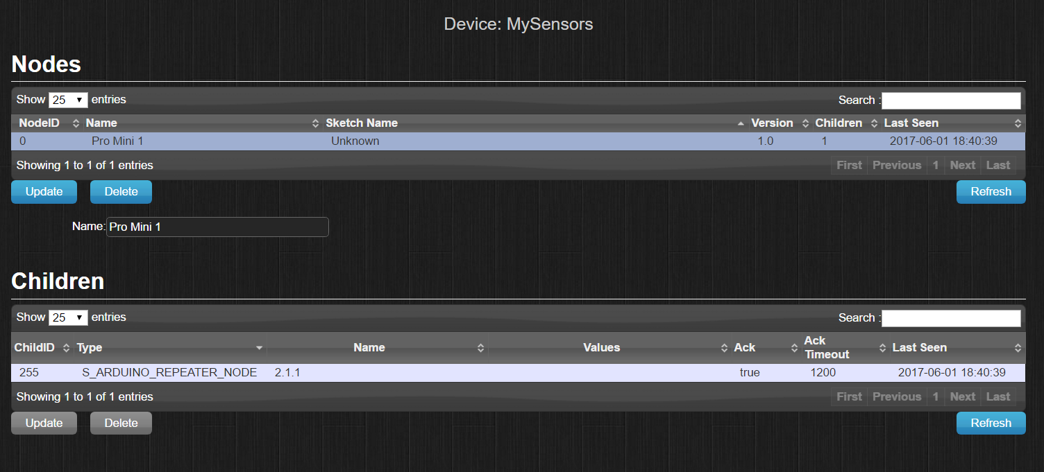

    Something seems to be getting through to my RPi gateway, though, because Domoticz shows the following:
    0_1496356930318_upload-e38cf963-c71e-44f1-838a-506ca9e1c9d4
    Any suggestions would be very welcome. I've tried adding a capacitor across the power supply as suggested, as well as changing the transmit power levels on the Arduino radio, to no avail.
    Thanks in advance!
      Thanks in advance!
      @egfku - I would say its a range or power issue. I would start here: https://forum.mysensors.org/topic/666/debug-faq-and-how-ask-for-help and go through that. Also you can parse your code into this: https://www.mysensors.org/build/parser and get more info out of it.
        Thanks in advance!

                  Am I missing a step? I am running "sudo mysgw -d" on the RPI, followed by "sudo service domocoticz.sh restart", then pushing the MotionSensor example to my Pro Mini.
                  Thanks again for everyone's help!
