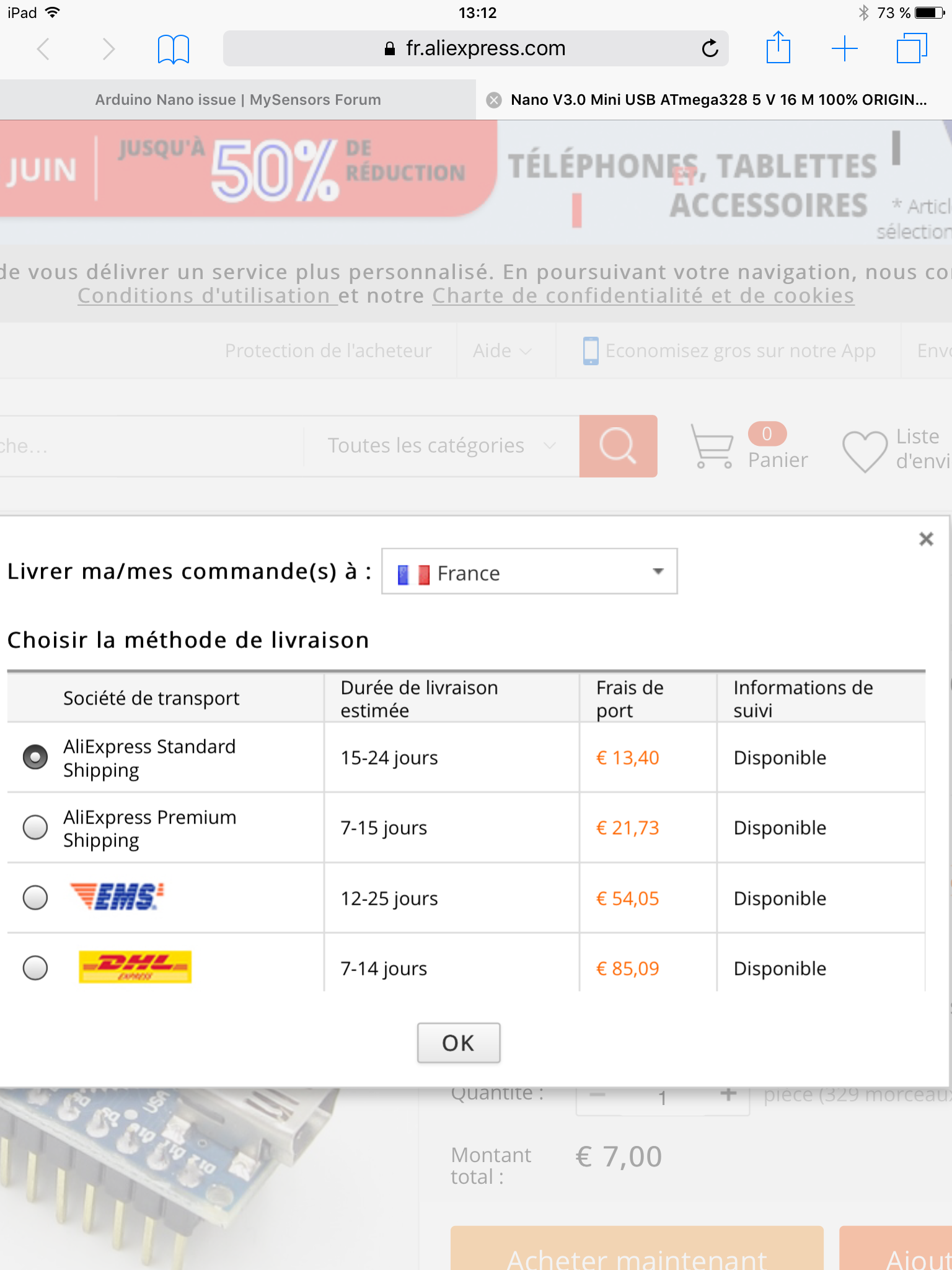

                  But I have checked the Nano proposed by the "Build" section of Mysensors (this one), and..well, 13,40 € of shipping to France ;)
                  But you may have some other reference ?
                  mfalkviddM 2 Replies Last reply
                  • qqlapralineQ qqlapraline
                    @gohan May be I was wrong.
                    @qqlapraline interesting! I've never seen that high shipping costs, but it seems like France is crazy expensive.
