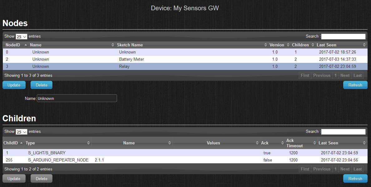

    Topic originally posted in Domoticz section, nut no luck:
    I'm quite new to MySensors, but not to domoticz, I already deployed mysensors based sensors (temperature, etc...) but I'm having a problem my the relay sketch: the relay shows up in domoticz in mysensors gateway setup page, but not in "Devices". I've read that a node should send data in order to show up un devices, but I don't know how to code that. I'm running last version of mysensors library. Please help!
    Thanks in advance, Thierry

        I have not checked the log of the gateway but shouldn't the output of mysensors gateway setup page tell me? As you can see it shows up properly (picture attached, you can see that the "last seen" is yesterday, that's because I didn't leave it plugged as I couldn't get it to work.).
        I've checked in "not used" => nothing, even after hitting the "allow new sensors" button.
        I'll try and plug the gateway to my PC tonight and see if the logs tell me more.
