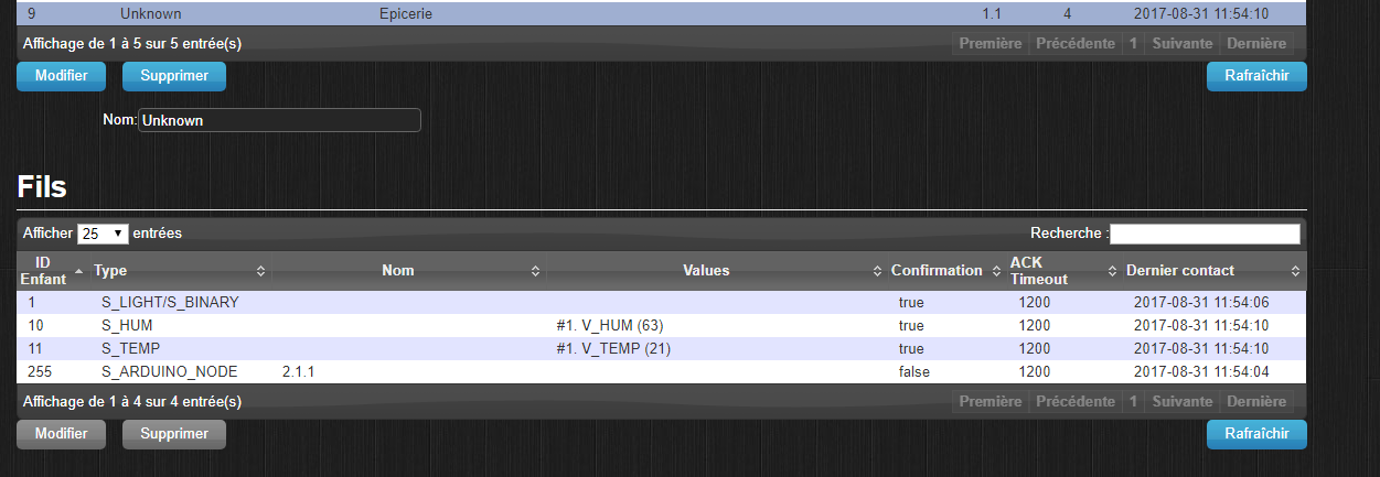

        Hello everyone
        Thanks for the information, I followed the tutorial point by point.
        The televersement went well. I am very familiar with the new material in the list of MYSENSOR devices. See attached photo, there is the LIGHT BINARY, HUMIDITY, TEMPERATURE. In the list of devices of DOMOYICZ there is only the sensor humidity and temperature, LIGHT BINARY is not present.
        The scketch of the temperature tutorial is not quite identical to the last version of the site.
        If anyone had an idea about my problem.
        Thank you for your help.
        Daniel

          here is the photo
