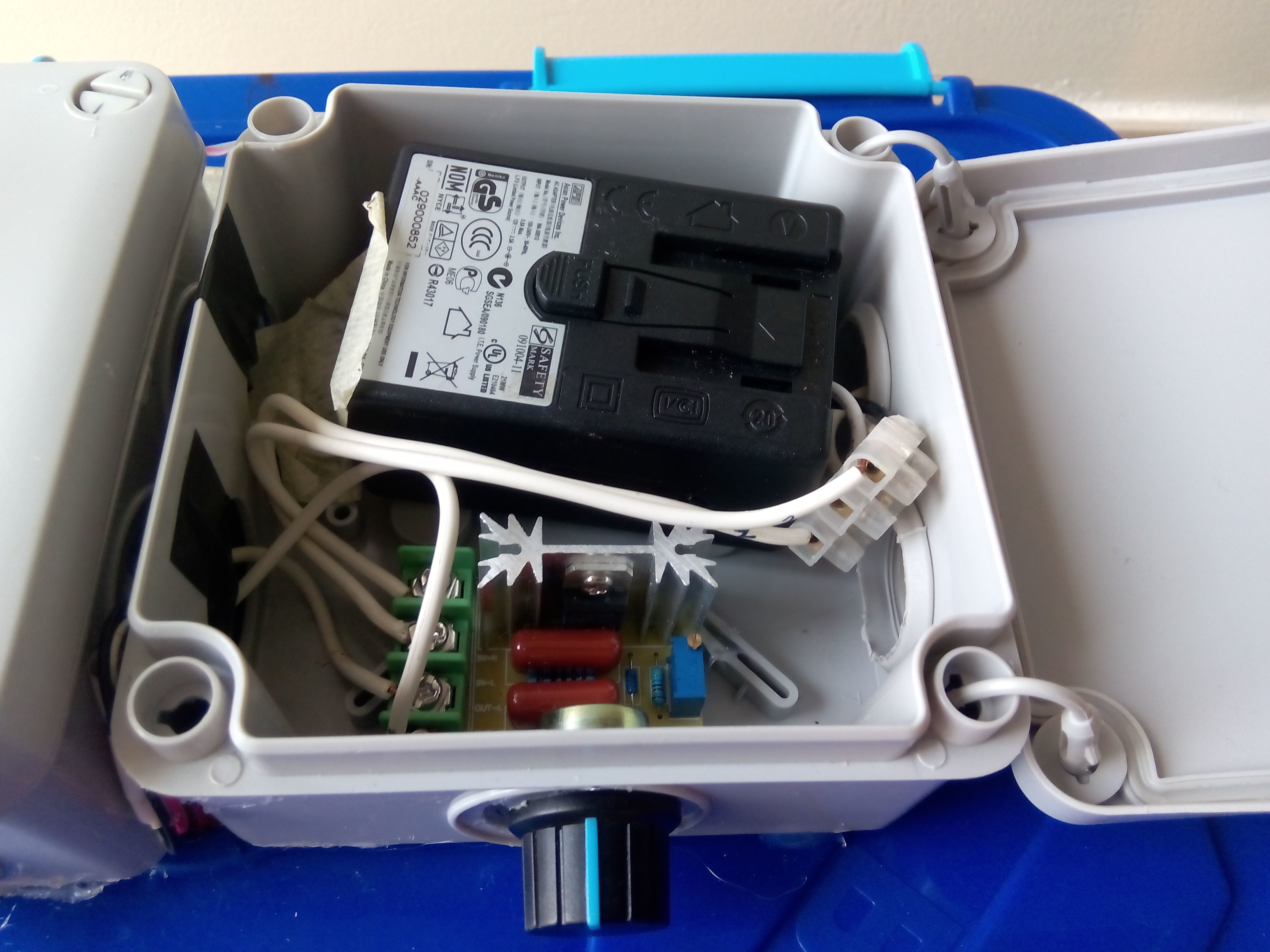

    Do you think you've seen all kinds of projects here? So ..think again. :)

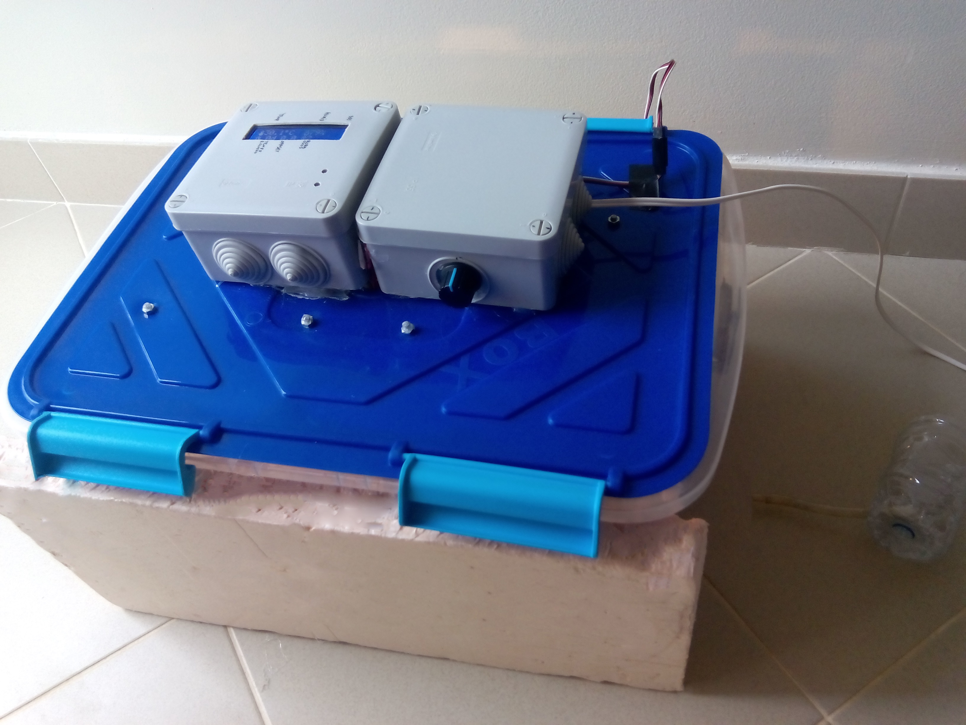

    There it is my chicken eggs encubator .
    Made from a 25 liters plastic storage box and some foam outside to prevent heat loss.

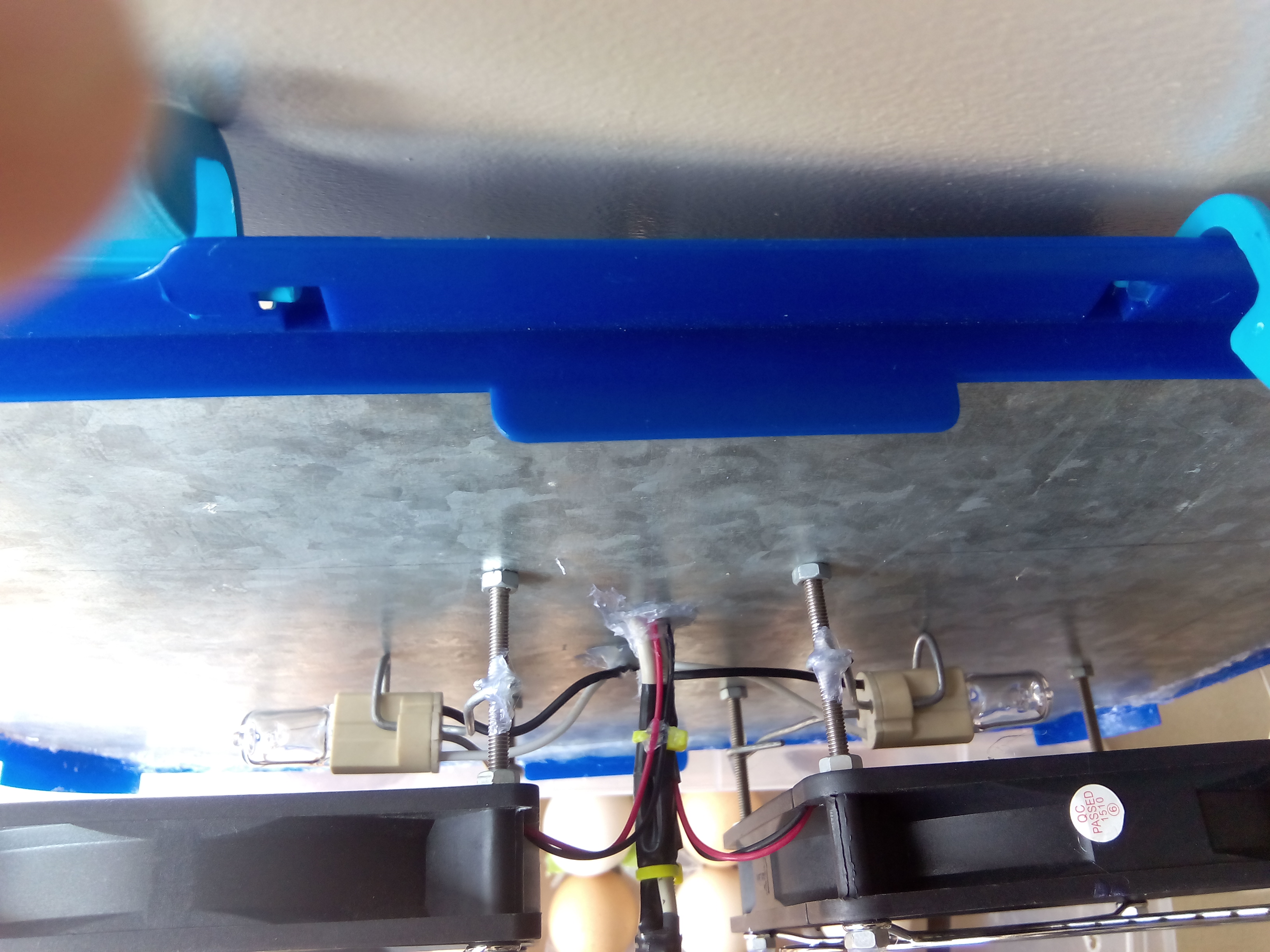

    i used 2 X 18w halogen g9 bulbs and a 230v dimmer to decrease light brightness.

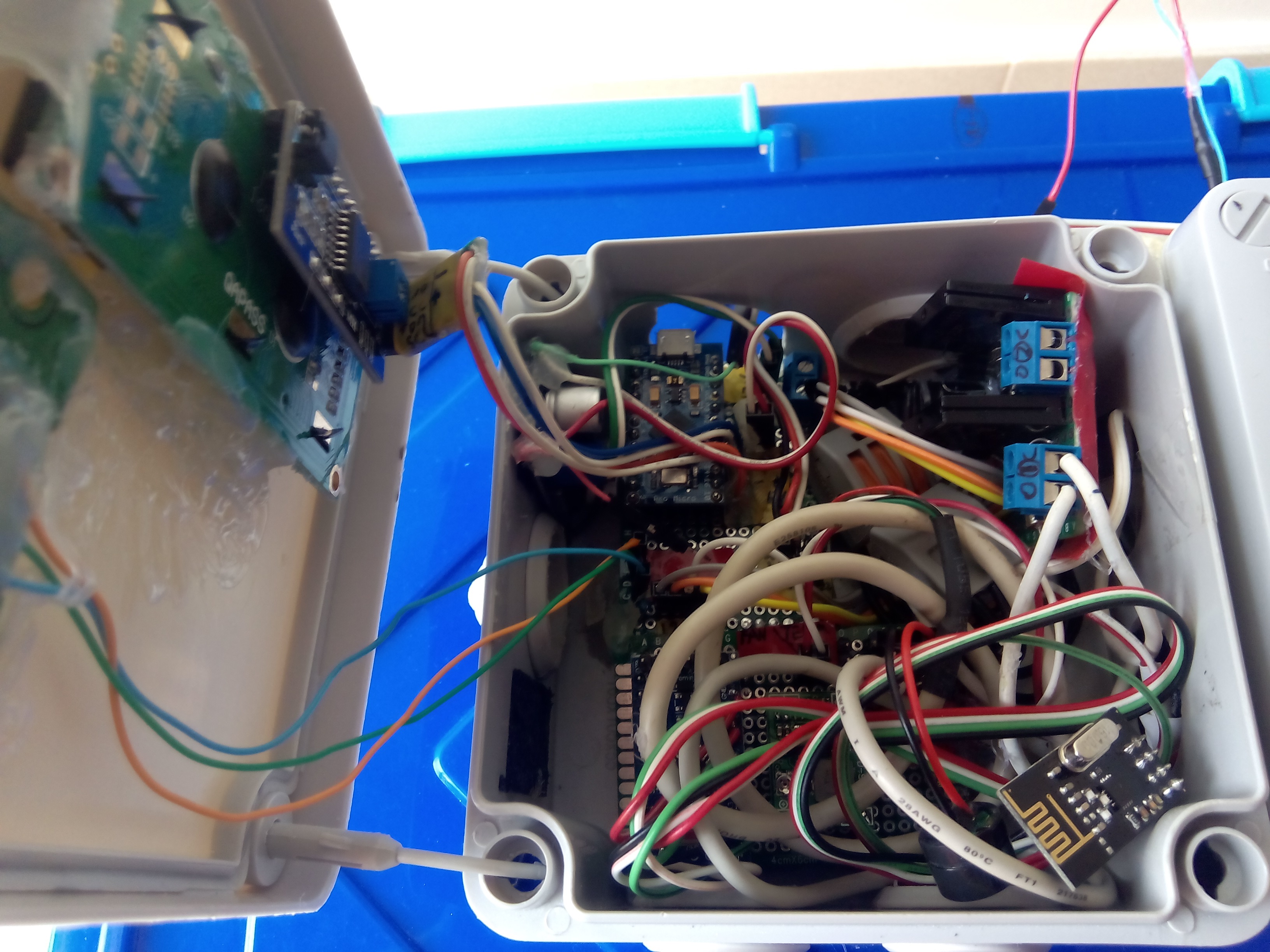

    There is a diagram above from fritzing. I uses an main arduino that controls a SSR relay for controls halogen light bulbs. this light bulbs are dimmed to half(in my case)
    for hold temperature much time as possible without decrease temperature.That makes SSR stay on for some minutes before goes off again. if halogen light are to powerfull makes the SSR goes on and off many times in short period. the ideal situation is having the dimmer controlled by arduino and hold temperature without turn ligh off ,but i didn't got this dimmer yet(is there any one ready for try it? :P ).
    this is the 3rd version i build and all the other version hatch almost all eggs(+/-80%) even with some issues on controlling temperature.i only had 1 fan and that caused some zones that overheated (more on coners).

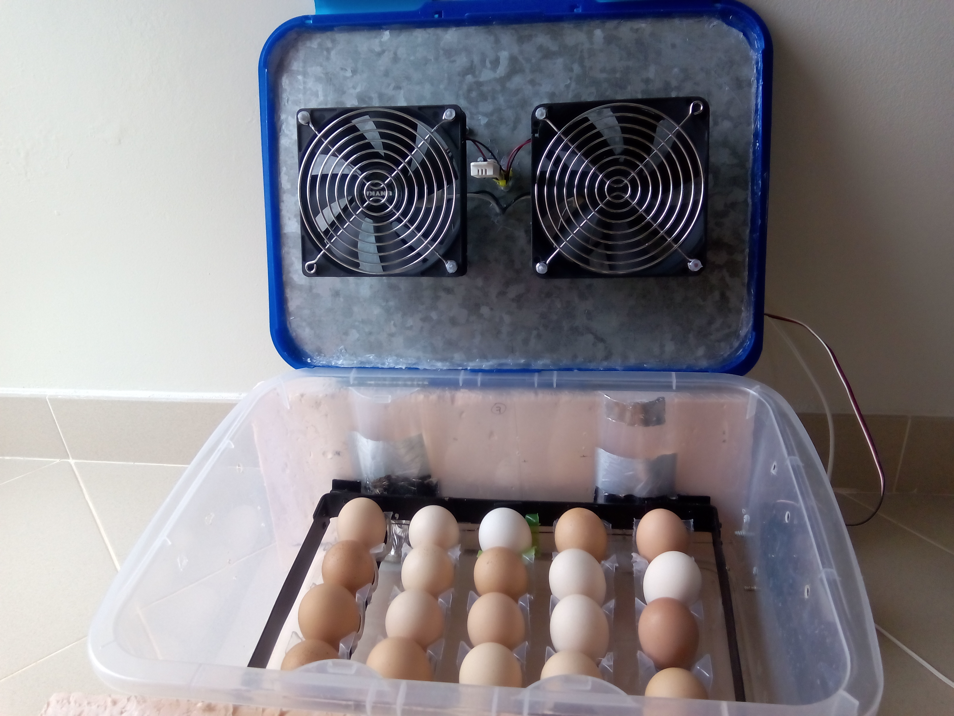

    Now i have 2x120mm(0.10A) pc fans that can spread hot air the same way in all this box.
    Then i have a secondary arduino that it's for safe features. it controls an alarm buzzer(pc speaker) ,its connected to an temperature sensor (ds18b20) and send temperature to emoncms.com through an nrf24 wireless board
    If temperatures goes over 39ºC or below 30ºC it sound an noisy alarm.Just in case main arduino or DHT22 fail.
    Egg roller its made os aluminium and plastic egg racks cutted and glued with hot glue(screws were better but this is enought to hold eggs).it makes 45º each side.
    An High torque servo roll every 60 minutes. Note that an regular servo does not have enough torque should be an high toque version.
    eggs ready to start hatching! note the ds18b20 sensor in the back of the DHT22 sensor.they will stay same height than egg rack.
    2x18w halogen lighs
    lcd screen is configured for simplicity . code have hours and days passed and remaining ,but i decide use just passed days, temperature manual offset and time for next egg roll(minutes),and of course temperature and humidity on first line.
    its a mess of cables ...i know. It's what happening when we always improve our project until it be a final version :P
    I used usb cables from computer cases for wire sensors, it work really well .
    There's 2 solid state relays on picture but we only need one.

        2x18w halogen lighs

        1x AC 220V 2000W SCR Voltage Regulator (overkill for 36W i know, but it cost 1.50€ on ebay)
