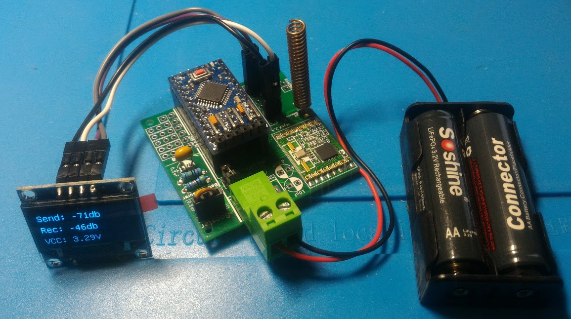

    Just wanted to share my tonight creation
    0_1508188047036_upload-ad843227-d291-4f19-874f-5437afd020c8
    It shows Send and Receive RSSI and vcc (that btw is measured via voltage divider and is spot on with my multimeter)

      Nice job! Looks very dapper.
      Alternatively, you may (?) be able to plug your screen directly into the I2C connector used for the TH sensor on:
      https://www.openhardware.io/view/268/Arduino-Pro-Mini-Shield-for-RFM69HW
      Depends on the pinout, of course.
        I thought about it but Vin and GND are swapped

            Yes, I'm using latest version in dev branch. I also figured I can show both power level and power percentage ( I removed the "VCC" from lcd as it is not really necessary :) )
              Here is the new code that uses the TX power readings. I think that RSSI values and tx power values could be useful to be reported by nodes every once and a while, at least to provide a feedback on how they are doing.

                Nice clean signal scanner build! I must have one.
                Is that an open source proto board you used? I couldn't find it poking around a bit.
                Thanks for sharing it!

                  @grubstake I think it is an earlier revision of https://www.openhardware.io/view/389/EasyNewbie-PCB-RFM69-HWW-edition-for-MySensors
                  G 1 Reply Last reply
                    G
                    G
                    Grubstake
                    wrote on last edited by Grubstake
                    @mfalkvidd
                    Thanks, it looks like the Rev 9?, where the older pic you posted looks like a smaller version. I didn't realize the board was rearranged between Rev9 and recent R10.
                      Yes, that was Rev 9, but the sketch would work with anything you have
