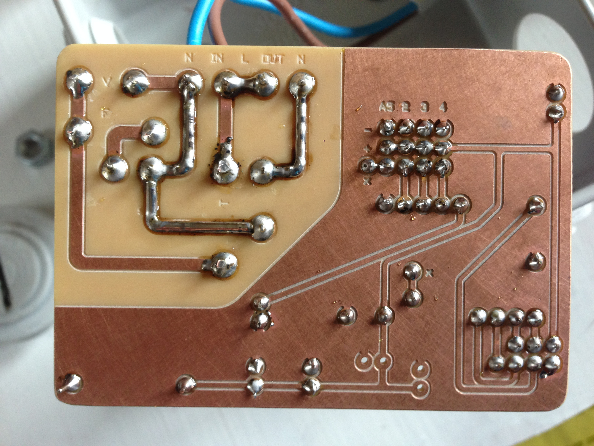

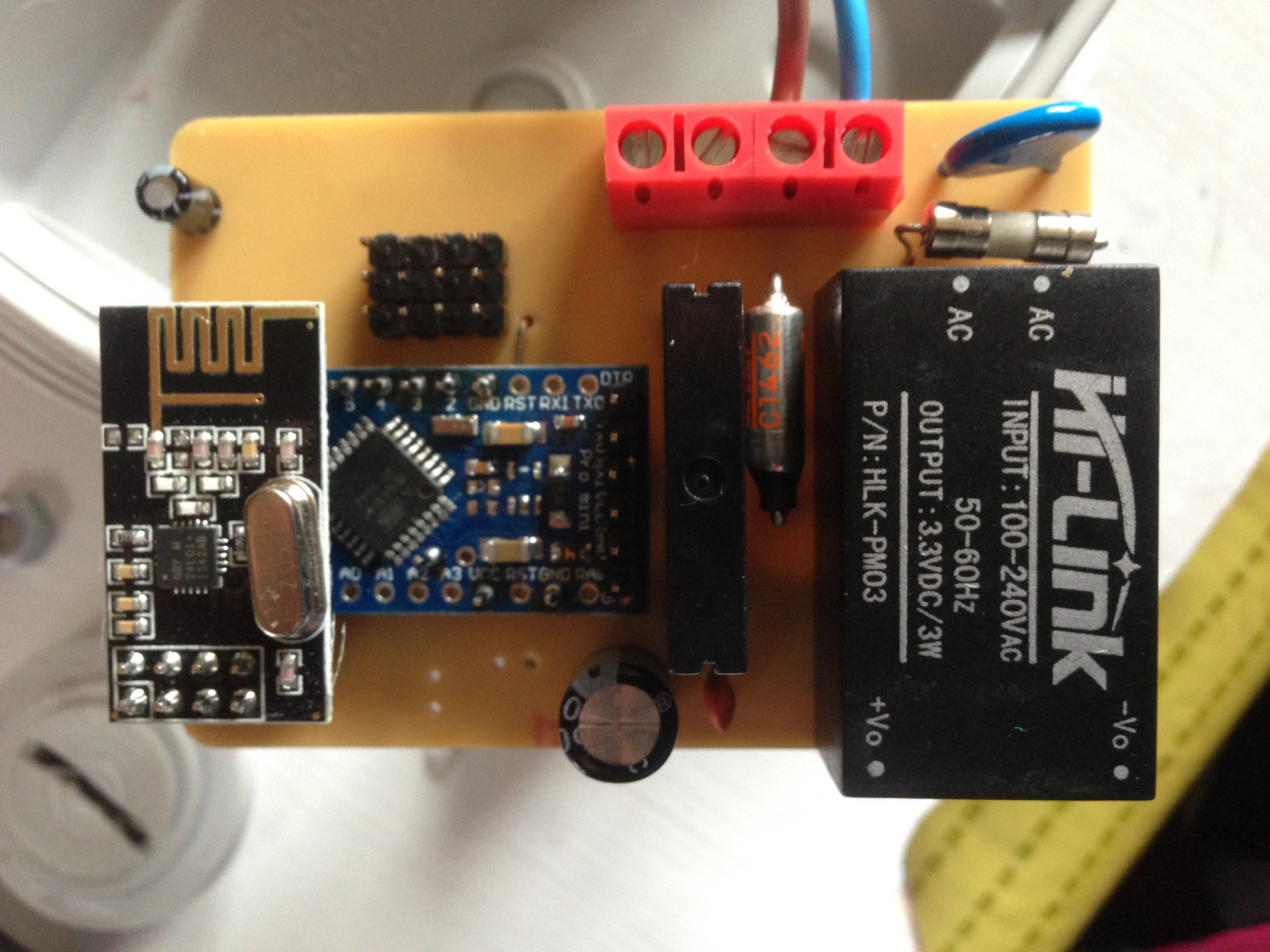

    Hi guys
    A new project came on top of the others : ceiling light
    The wife kinda likes the idea behind MySensors and openHab, as home automation and security system
    But i had to hit hard to get it fully accepted. So here comes the "cat shaped ceiling light" !!!
    (Ok I know, ceiling is not finished yet... it has to be spotless as this kind of light reveals everything...)
    LED strip is glued on the edge of the board, powered via a 12V power supply which is controlled via an OMRON SSR relay
    Some AutoCad and CNC later... :
    This is highly inspired by Aproxx's work
    https://www.openhardware.io/view/77/AC-DC-double-solid-state-relay-module
    What I want it to do :
    • switch on the light when motion (PIR sensor)
    • switch itself off with delay (PIR kind enough to do that as well)
    • measure room light level so as to switch light on only when needed
    • have 3 modes controlled via openHab : fully automatic, always ON, always OFF
    So far i have managed to create a 3-state selector in openhab with this:
    • ".items" file: String HouseMode "House Mode [%s]"
    • ".sitemap" file: Switch item=LightMode mappings=[ON=1, AUTO=2, OFF=1]
    Now I am having some trouble with the sketch...
    I guess I should be using S_CUSTOM and V_CUSTOM (instead of S_BINARY and V_STATUS) as the "LightMode" variable can take up to 3 states...
    How do i then retreive that value?
    int lightMode = message.getInt();
    Thanks for your input and comments :)

        • ben999B
          ben999B
          ben999
          wrote on last edited by ben999
          Guys
          Based on
          • ".items file:" String lightMode "lightMode [%s]
          • ".sitemap" file: Switch item=lightMode mappings=[ON=1, AUTO=2, OFF=1]
          I would like to retreive the value of "lightMode" at the node side
          This is what I am doing at the moment :
            if (message.type == V_VAR1) {
              char lightMode[MAX_MESSAGE_LENGTH];
              strncpy(lightMode, message.data, MAX_MESSAGE_LENGTH);
          Compiles and uploads fine
          But state of lightMode doesn't change in node serial monitor...
          Nothing is returned (empty field) when doing a Serial.println(lightMode)"
          Could you please point me towards my mistake ? Am I (one more time) mixing data types (int and char and so on) ?
          Thanks a lot for your time :)

                          @ben999 Nice CNC work on the PCB.
                          ben999B
                          ben999B
                          ben999
                          @dbemowsk said in Automatic LED light - high WAF inside :):
                          I have some neat little tools in my workshop:
                          3x1.5m working area
                          500x300mm working area
                          dbemowskD 1 Reply Last reply
