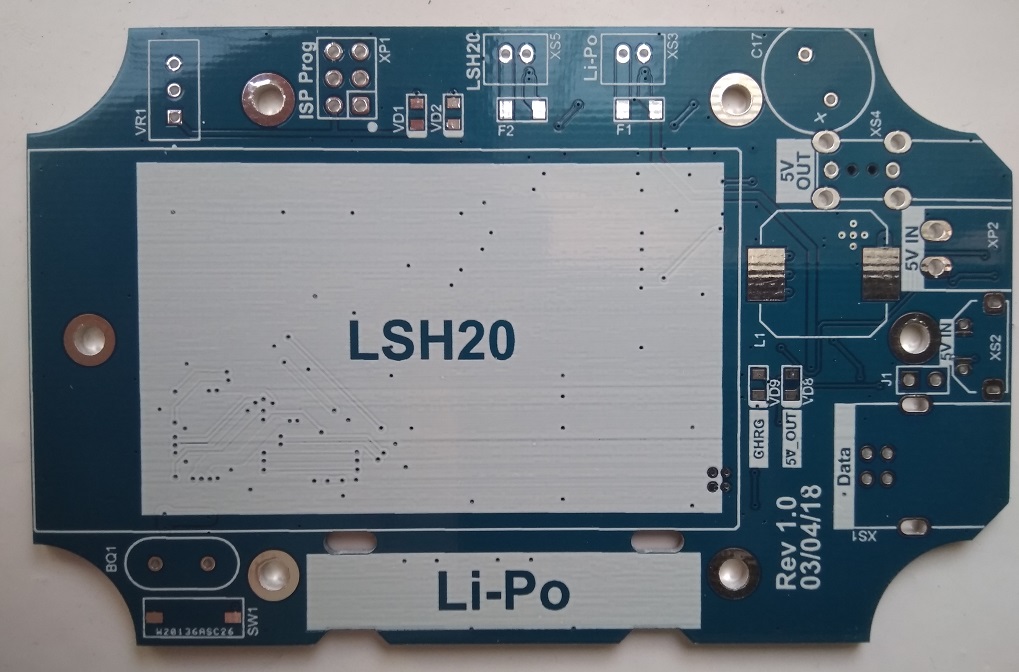

          I have received pcb from PCBWAY today. 11 pcs were in the box instead 10 :grinning:
          As always, quality is excellent for little money! In a few days I'll assembly the boards.

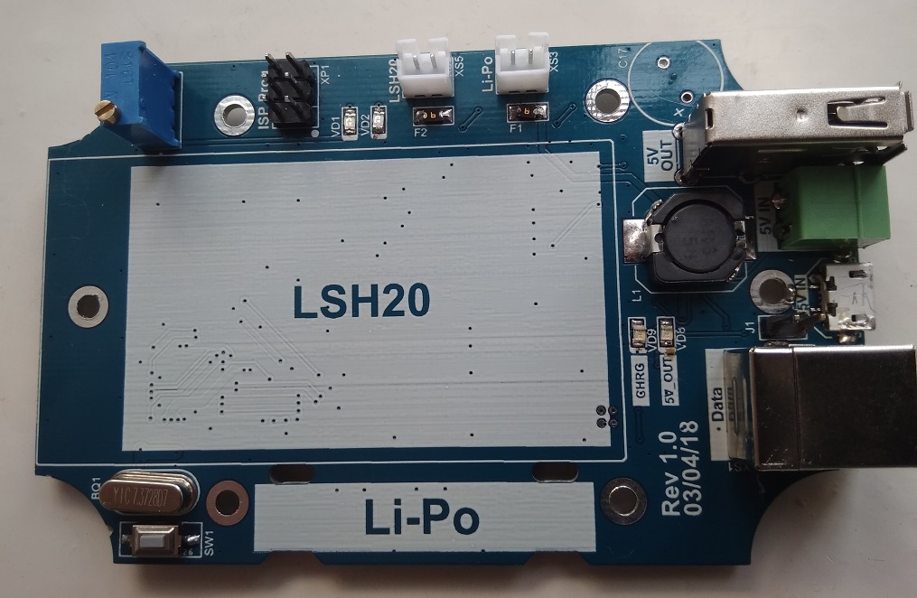

                Some photos of soldered device...
                5_1525528221710_UPS_06.jpg 4_1525528221710_UPS_05.jpg 3_1525528221709_UPS_04.jpg 2_1525528221709_UPS_03.jpg 1_1525528221709_UPS_02.jpg 0_1525528221708_UPS_01.jpg

                          I tested this device yesterday and found some issues. Now, I want to share results.
                          1. The analog comparator circuit must be modified. AIN0 should left floating (unconnected) and to this pin need connect the internal 1.1V bandgap reference. The 5V_Fail signal must be connected to AIN1 pin.
                          2. VD7 must be removed and DC-DC will be works all time except power save mode.
                          3. Need to add the MOSFET for manage LiPo charger, because this IC interrupts accumulator detecting signal (this signal always near 4..5 volts).
                          4. Need to add the 5V (external) detecting signal to the microcontroller .
                          5. Many of the components values should be revised.
                          All these remarks will be taken into account in the new revision.
                          Everything else works perfectly!
                          For the first revision of the device, I'm completely satisfied with the result.

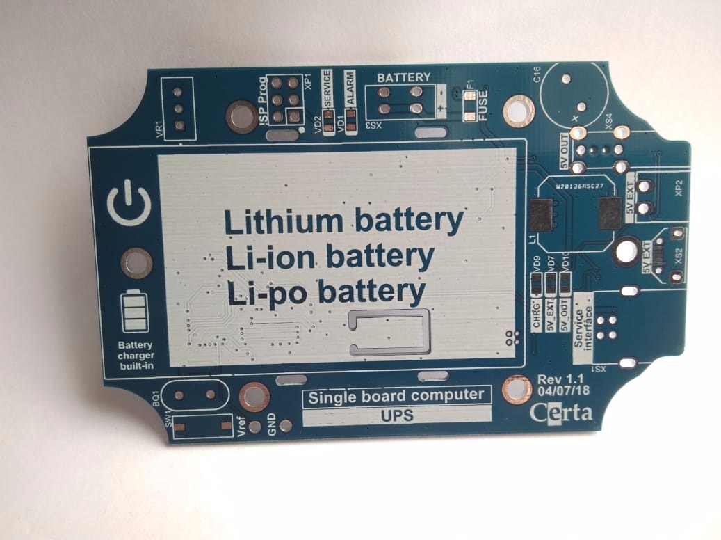

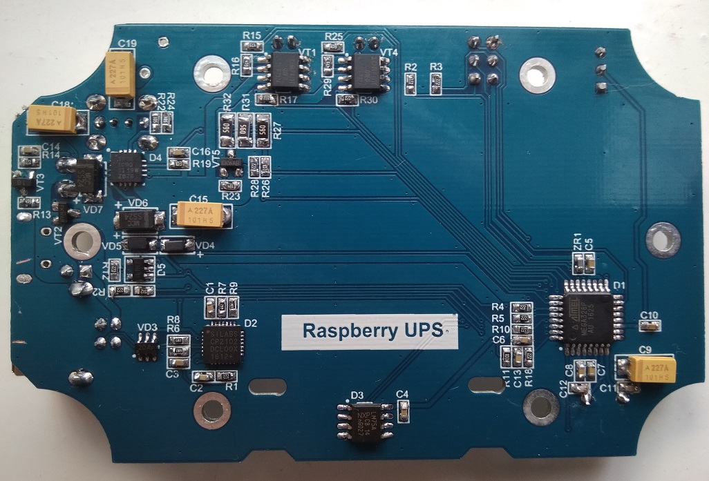

                            The second revision of "Raspberry UPS" which now called "Single borad computer UPS" was received yesterday from PCBWAY.com
                            berkseoB 1 Reply Last reply
                            • kalinaK kalina

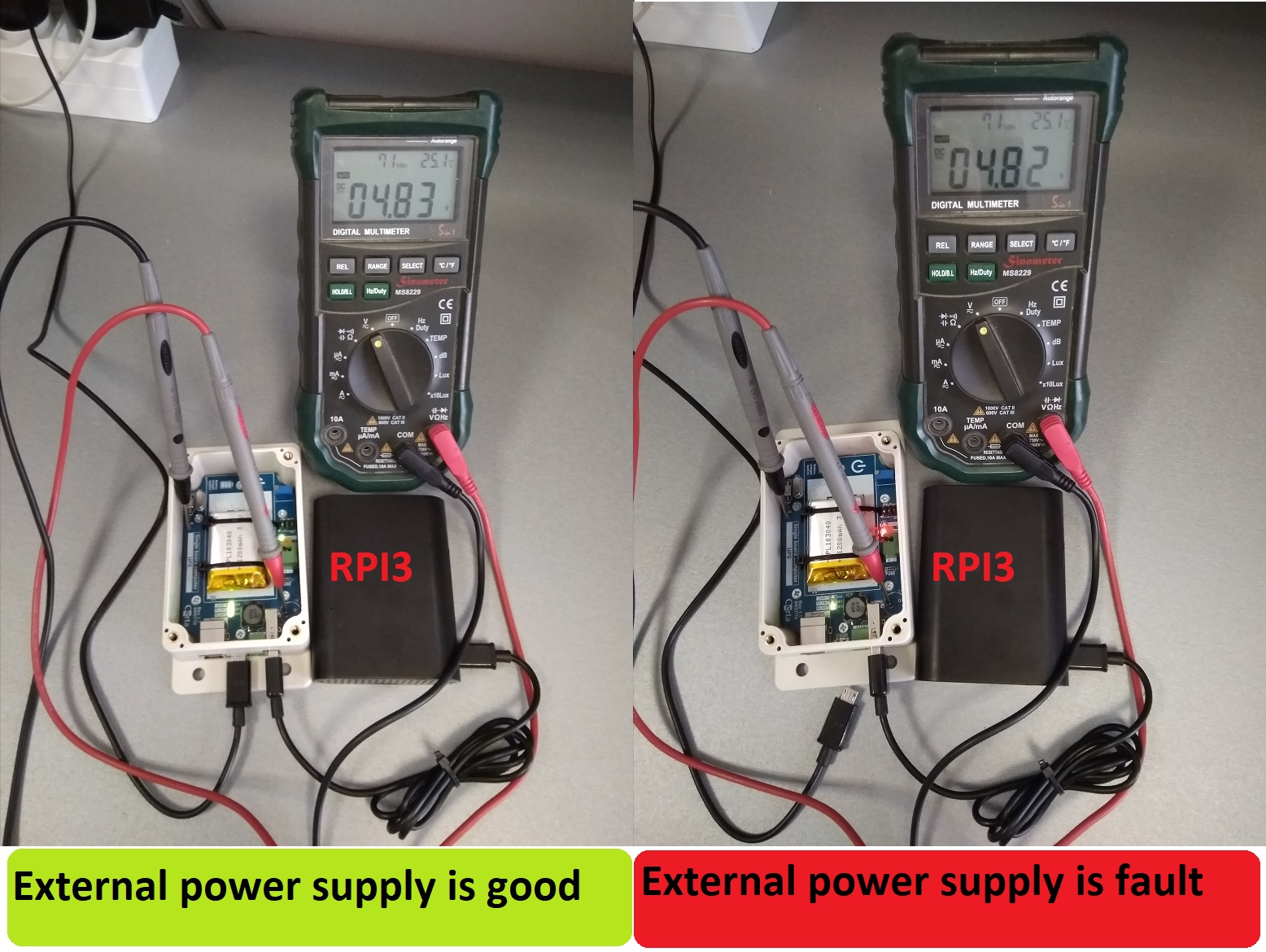

                                  wrote on last edited by kalina
                                  #22
                                  First soldered device:
                                  And a small test:
