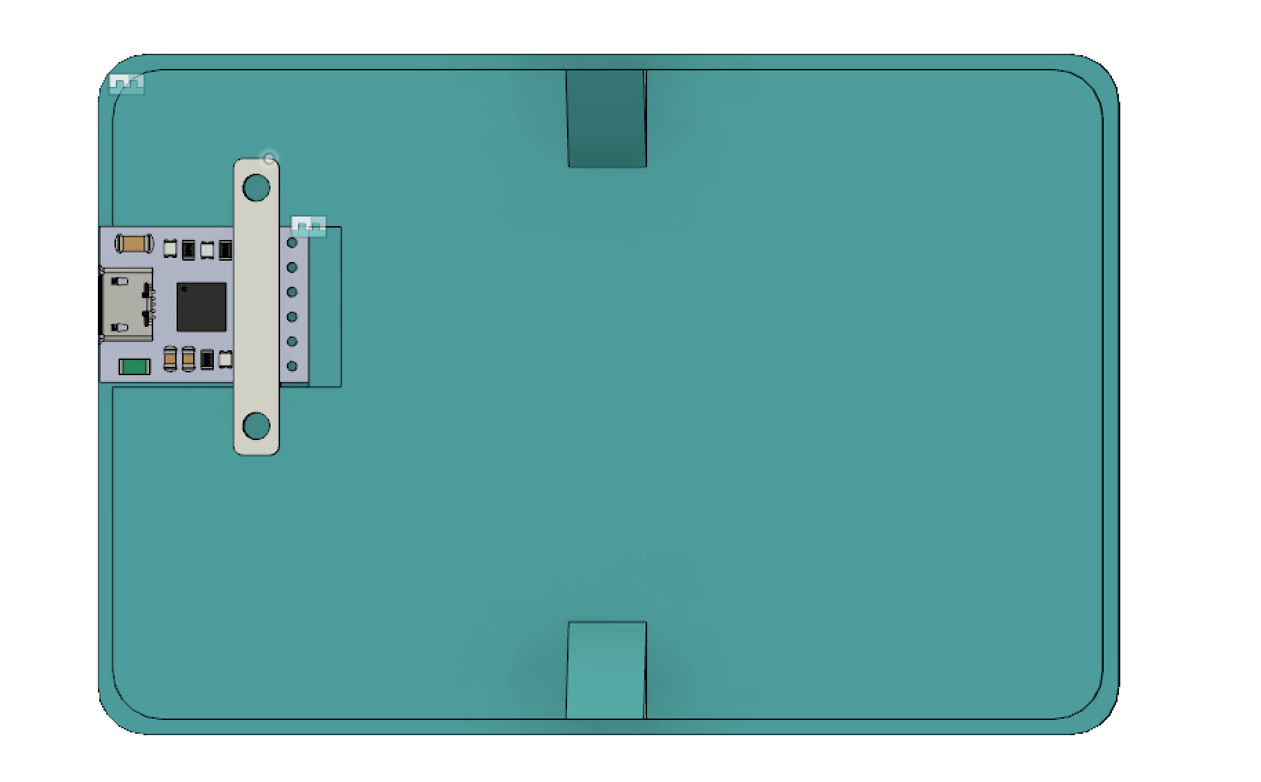

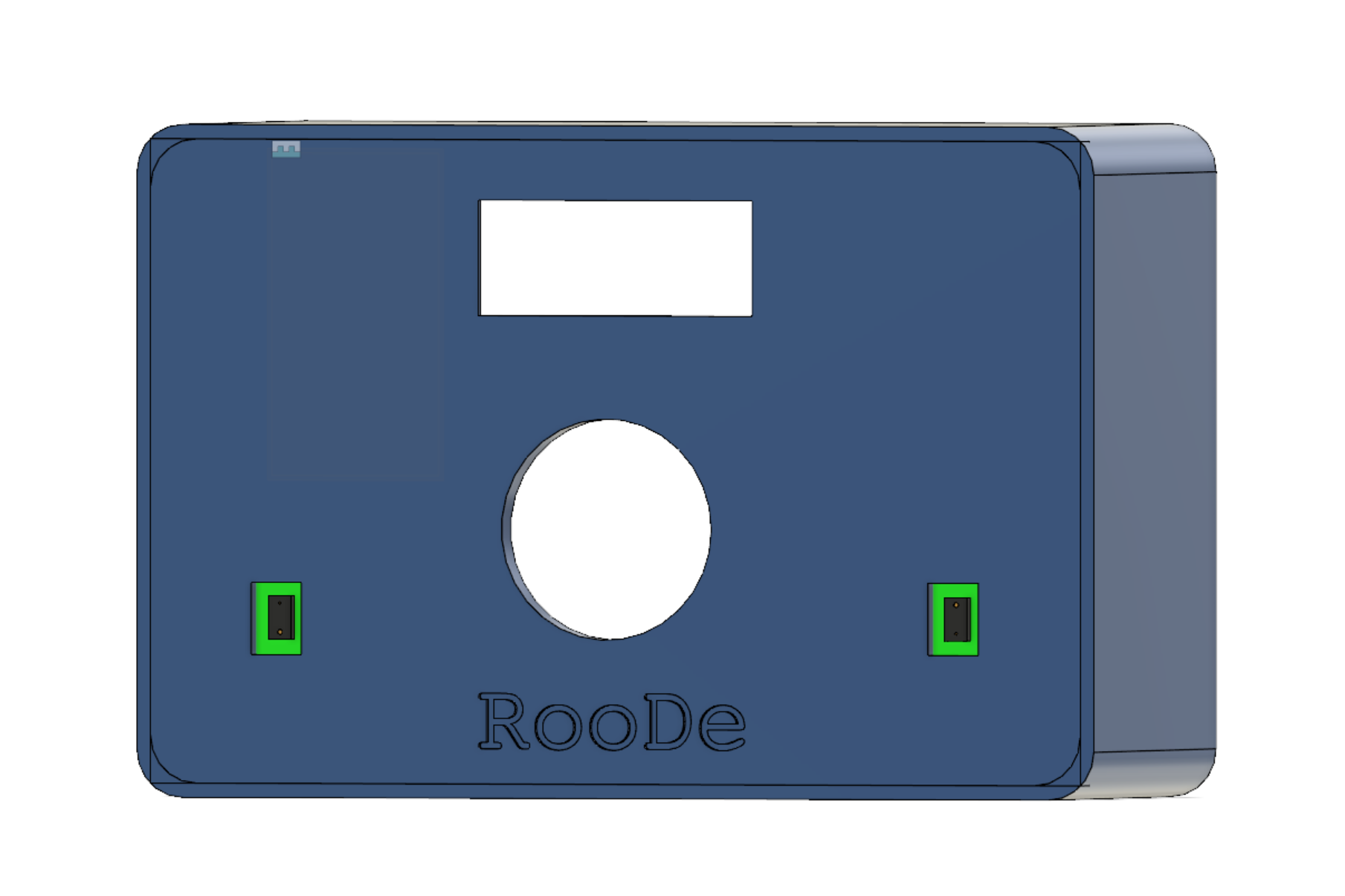

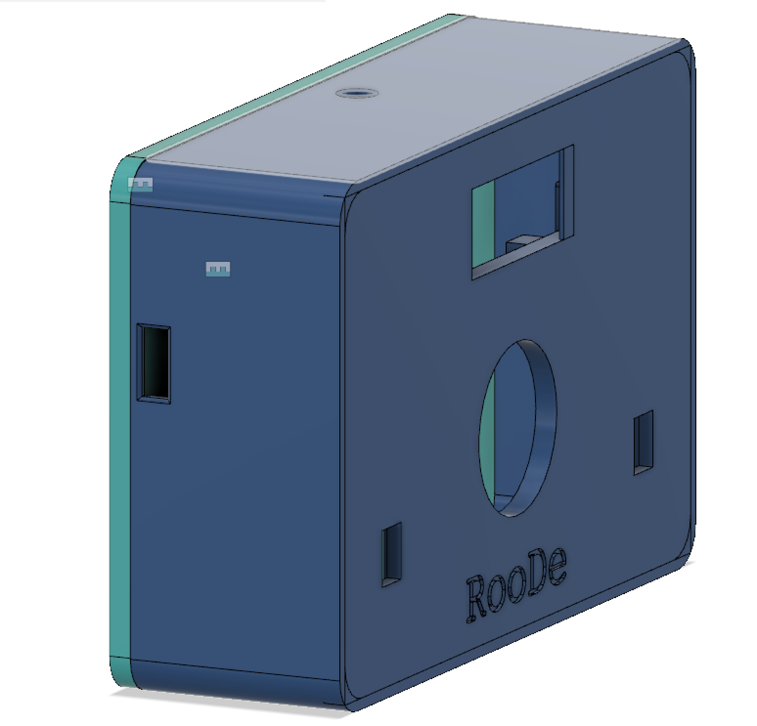

                      I was very productive this weekend and i have some pictures of the new enclosure for you guys. The enclosure is made to use an Arduino Pro Mini (top right), an NRF24L01+ with adapter (top left), OLED Display (top center), PIR, center and two VL53L0X
                      2_1543782371321_WallMount.png 1_1543782371321_Inside_with_electronics.png 0_1543782371319_Complete.png
