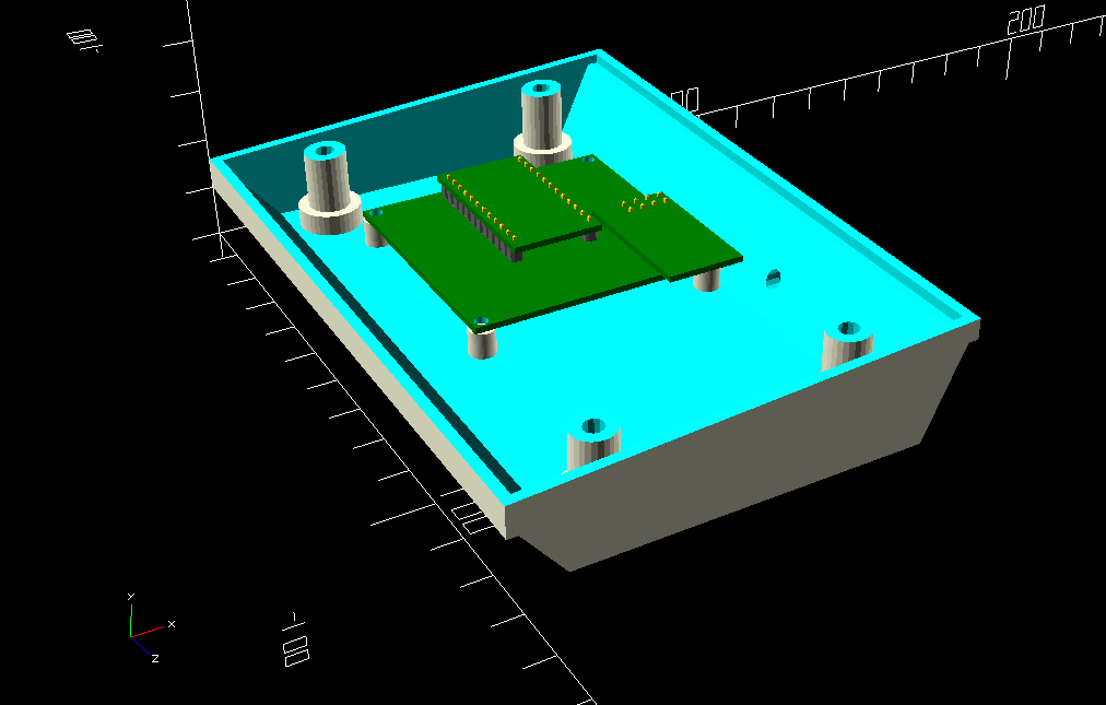

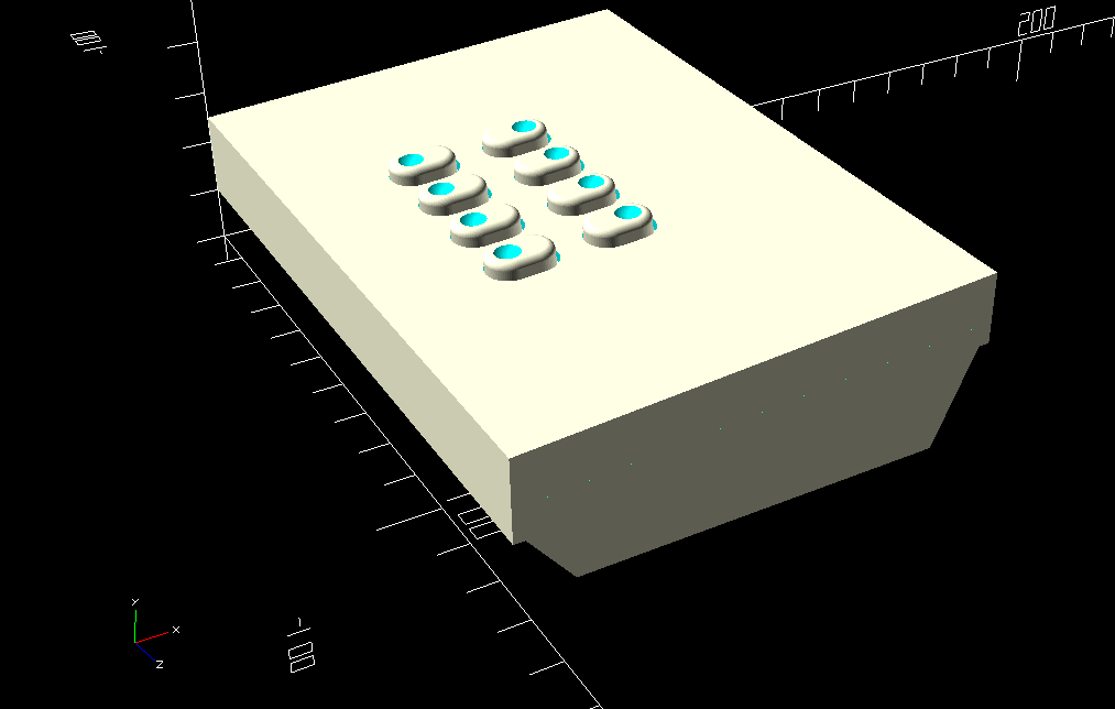

    My wife loved the fact that she had control of the light and ceiling fan right next to the bed. When I switched over to MySensors control of the room with my Vera controller, I was no longer able to use the old X10 controller. I had thought of gutting the controller and rebuilding the electronics, but that seemed like more work than designing my own controller. I started mocking up a design in OpenSCAD and here is what I came up with.
    This is the full mocked view showing the 8 buttons.
    This is with the cover off and the mock of the Easy Newbie Board by @sundberg84 in place to see how it would fit. The hole in the back of the case is for a DC power cable. I figured rather than have to design in a power supply, I figured I would just use a 5 volt wall wart power supply.

    This is the underside of the top cover showing the mock up of the 40 x 60mm proto-board with switches mounted to it, again to size up the fit.
    I currently have the first revision of the case on the printer. I may at some point add an OLED or LCD display to a future revision for feedback, but for now just to see if the idea is sound, I am keeping it as simple as possible.

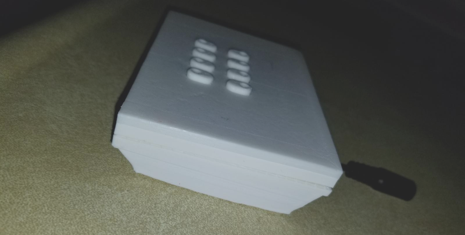

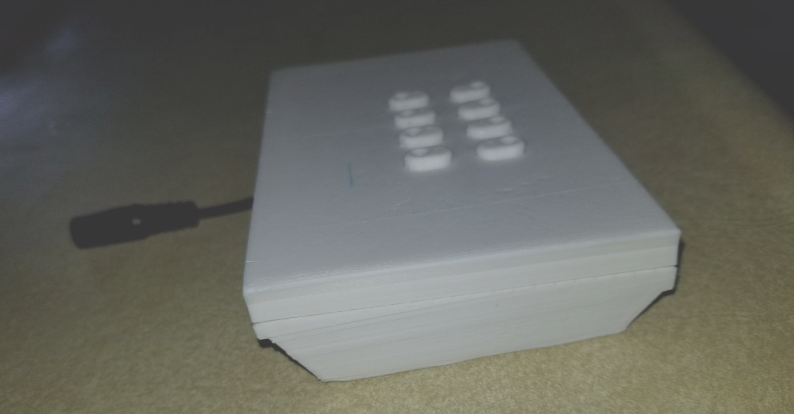

                    So I tried collapsing the polygon by the edge radius size in all directions and that appears to have done the trick. I kept the hollowed out inside with the square corners, and my worry with that was that the square corner was going to come too close to the rounded edge making the edge weak, but that doesn't appear to be the case. Here is the result with a cutaway corner.
                    Here are some pics of the first run of the case with the non-rounded corners. I printed it in ABS, and on the bottom in the third pic you can see where I had some slight lifting of the bottom corners. I had some trouble getting my bed temp where I wanted it, so I ended up running the bottom at 95c, which is probably why I got the lifting. I ran the top at 103c and didn't get any lifting there. They say ideal bed temp for ABS is around 110, but I can never get mine that high.
                    I have the switch board in place to test the functionality and feel of the buttons, but I don't have anything wired just yet. I figure I should be able to use the same code that I use for my in-wall scene controllers as it is just wired as 4 rows and two columns which is what those switches use.
