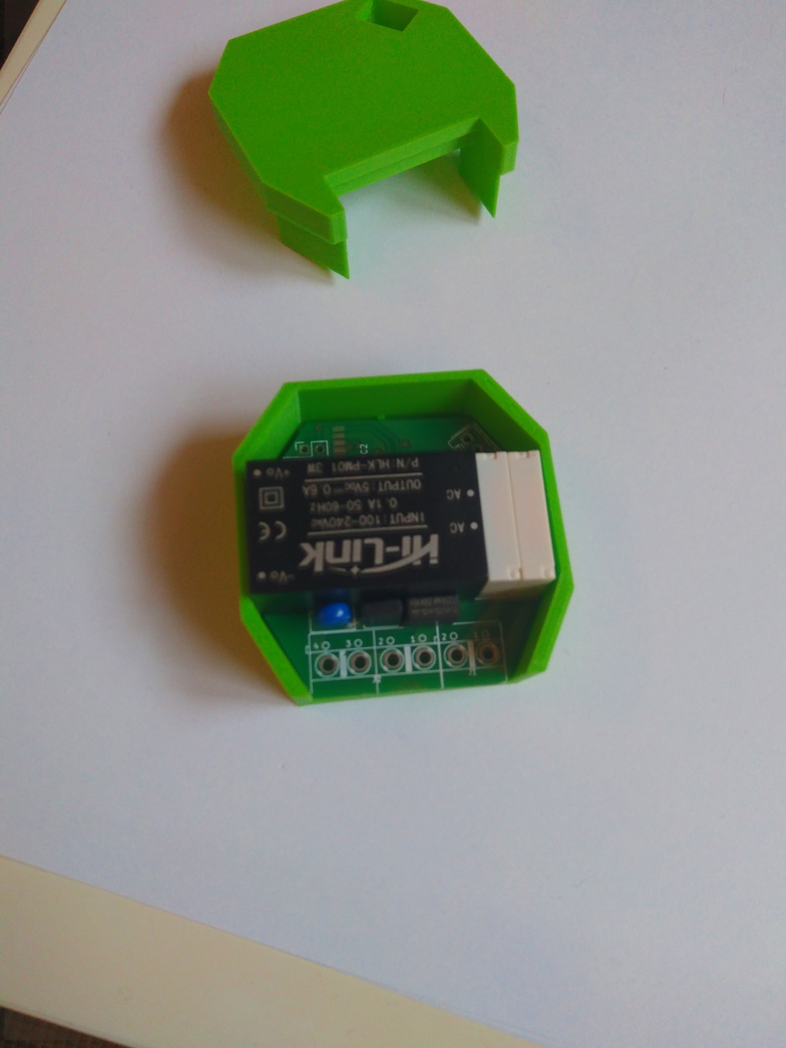

                    EDIT 3: The radio
                    For future revisions of the pcb, add some 0.5mm space between the radio and the Hi-link. It is really tight fit today. Almost to close together.

                      3. The radio
                        I know about it, but it is really no more space on PCB for do this.
                        And I think make PCB bigger to add free space is not good idea.

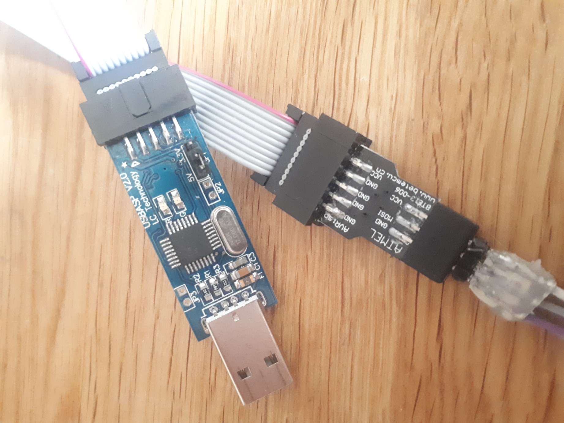

                                @rolandow To burn a bootloader you need an ISP. I have used a cheap Chinese clone like this one
                                0_1564575276379_20190731_100612.jpg.
                                I have used Arduino IDE to burn the bootloader, but you can use other things too, like AVRDUDE.
                                A word of warning when using the Arduino IDE is that it also sets the fuses. So, you have to select the correct board type when you set the bootloader with this program (or change the fuses in the boards.txt file).
                                I bricked two atmega328 before I realized this.
                                In this post you can read a little about the flashing, or atleast it has links to other pages.
                                You can probably skip the bootloader all together and just upload the sketch with the ISP instead, but you wont be able to upload with serial in that case.
                                After the bootloader, you can upload with a FTDI. I also use a cheap clone like this one
                                I also use the Arduino IDE to upload the sketch, just select the correct serial/com port in the IDE.
                                The "InCan double light switch" does not auto-reset when upload starts, so you have to reset it manually. The white/yellow cable is connected to RESET on the ISP connector, and after I choose Upload in Arduino IDE and the build output in the IDE window is finished I touch the white/yellow cable to GND on the FTDI device, and the leds on the FTDI starts blinking.
                                Device is now programmed.

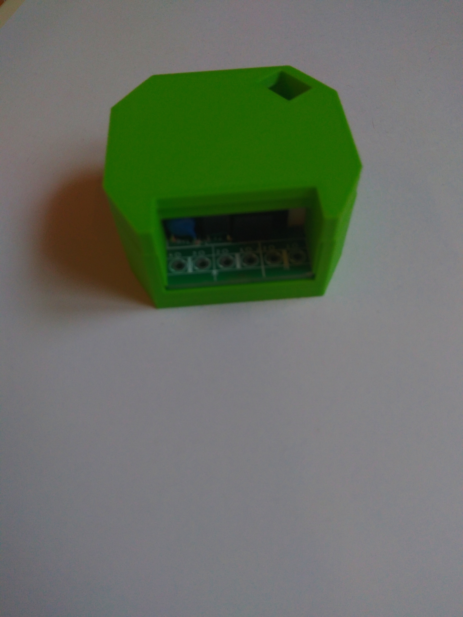

                                        Hello !
                                        I know that some time has passed but the problems with the heating diodes may be due to the wrong location in the drawings - they are there the opposite than they should be !!! (they should be directed to the inside with minuses as shown in the schematic and on the drawings they are outside) - I had the same thing until I checked
                                        I also designed the housing for 3D printing - if Stormy is interested I can send it for sharing2_1578002815693_op20191224_112454_HDR.jpg 1_1578002815693_op20191224_112425_HDR.jpg 0_1578002815692_op20191224_112140_HDR.jpg

                                          @insectteam I did not understand what you mean about the diods. Could you please clarify or show with pictures?
                                          I have not used the device since it does not feel saft to put in an enclosure if the diods burns hot.
                                          And also, please share your stl files for the enclosure, here or on thingiverse
