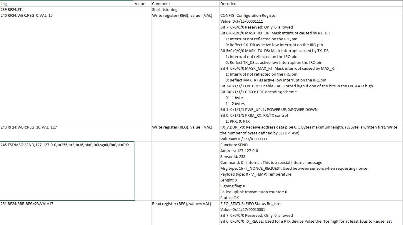

    I discovered a timing issue with MySensors 2.3.1 and NR24 "standard" (non PA, with capacitor and good power).
    The gateway is a Nano with standard gateway. Signing is turned on. Basic debug is turned on.
    All is working perfectly as long as the nodes are also on Nano.
    However, this is not the case with Mega 2560.
    This seems to be linked with the radio ACK of node PING request at startup. The gateway properly receives nonce request form the node, and answer to it, but always get radio NACK. Here's the node trace:

    I'm thinking about timing issue as everything is getting well if I turn RF24 debug on on node. Here's gateway log (node log is too large to be included, but available on request):

    I didn't found any help on this forum, but tried to compare MySensor's RF24 code and Arduino's standard one, and found some differences on timing (the most significant one being after setting CE high or low).
    Before starting modifying the code to (try to) find a solution, it may be clever to ask the forum first ;-)

      @flyingdomotic there was a change between 2.3.0 and 2.3.1 that addressed a similar problem (not related to signing though): https://github.com/mysensors/MySensors/pull/1193
      But since you're already using 2.3.1 it is probably something else.
      • F
        F
        FlyingDomotic
        @mfalkvidd Yes, I saw that, and already back ported the 2.3.1 change to 2.3.0, with great improvement in 2.3.0 reliability.
        However, there's still something in timing with 2.3.1, at least when micro-controllers are not the same.
        YveauxY 1 Reply Last reply
        • F FlyingDomotic
          YveauxY
          YveauxY
          @flyingdomotic it's likely this issue : https://github.com/mysensors/MySensors/issues/1134

                    @Yveaux: I fixed the issue. I removed all delayMicroseconds in RF24.cpp (except those in RF24_standBy), and added a delayMicroseconds(1500) on very top of RF24_stopListening. I tested with a Nano gateway + Mega node, a Mega gateway and a Nano node, and a Nano node and a Nano gateway. Everything is running smoothly.
                    Modified file is available (I tried to upload it on forum,, but "Upload file" was returning an error on file type, only allowing images.
                    Does someone know how to propose the change for a new version of MySensors (sorry, I'm something new on that kind of process ;-)?
                    In addition, I wrote a small Excel tool to decode MySensors log, mainly on TSF:MSG and RF24:* (see example of output here under). If someone is interested, I can push it by mail, but I would prefer making it available more widely. Is there any already existing way to do this (other than putting on my personal github account)?

                        @flyingdomotic I agree with @mfalkvidd. The delays follow the original nrf24 datasheet closely. If it works for you, it might break operation for many other users.
                        Your changes likely mask the real issue.

                          @mfalkvidd: thanks for the pointer. For sure, I only did limited testing. However, I carefully read before the NRF24L01+ data-sheet, analyzed chronogram and tried to understand what may happens. But anyway, I must admit that I'm just a newbie in MySensors, and probably had wrong in the approach. Concerning Google spreadsheet, it's not able to understand VBA, and my code dirty code use it hardly ;-)
                          @Yveaux: I'm interesting by the reference in RF24 datasheet that may explain the delays I suppressed, to learn about my error, as I miss them. As of now, I'm thinking that RF24 with auto ACK is properly designed, with symmetrical switch delay of 130 us, except if you turn CE down before sending ACK of the just received message. As the ACK may be repeated, I choose to use the same delay as ARD, even if the probability is not so high. However, you're probably right telling that will break operations for other users. I'll let you decide if adding some delay at top of stop_listening function may help or not. And yes, I tried to apply your reco first, but it didn't worked. I suspect the other delays influencing the issue I had, but removing them all won't worked too. It only worked after adding delay before turning CE down.
                          Anyway, thanks to all for your help.
