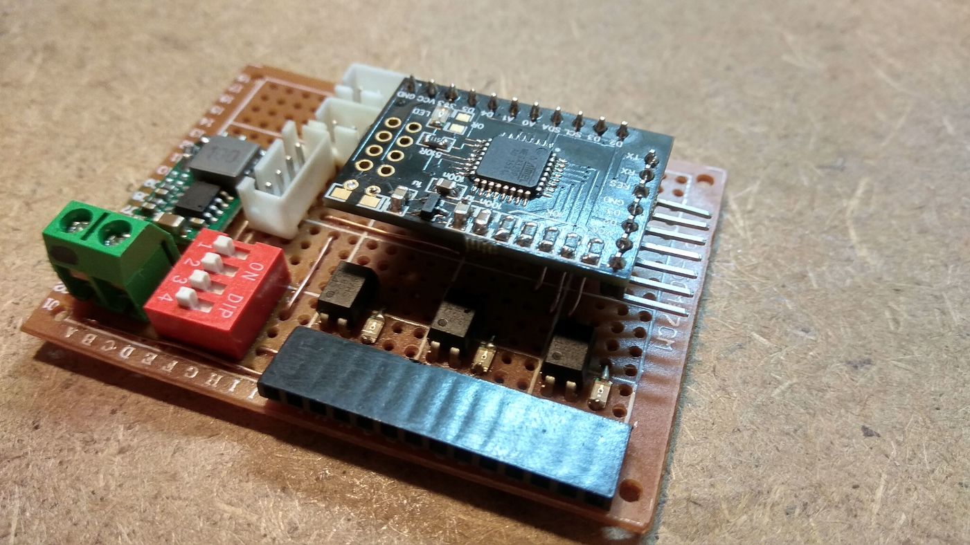

              I am use switching DC-DC the same as you to get 5V from 12V and LDO XC6206 to power NRF24 module - all work good.
