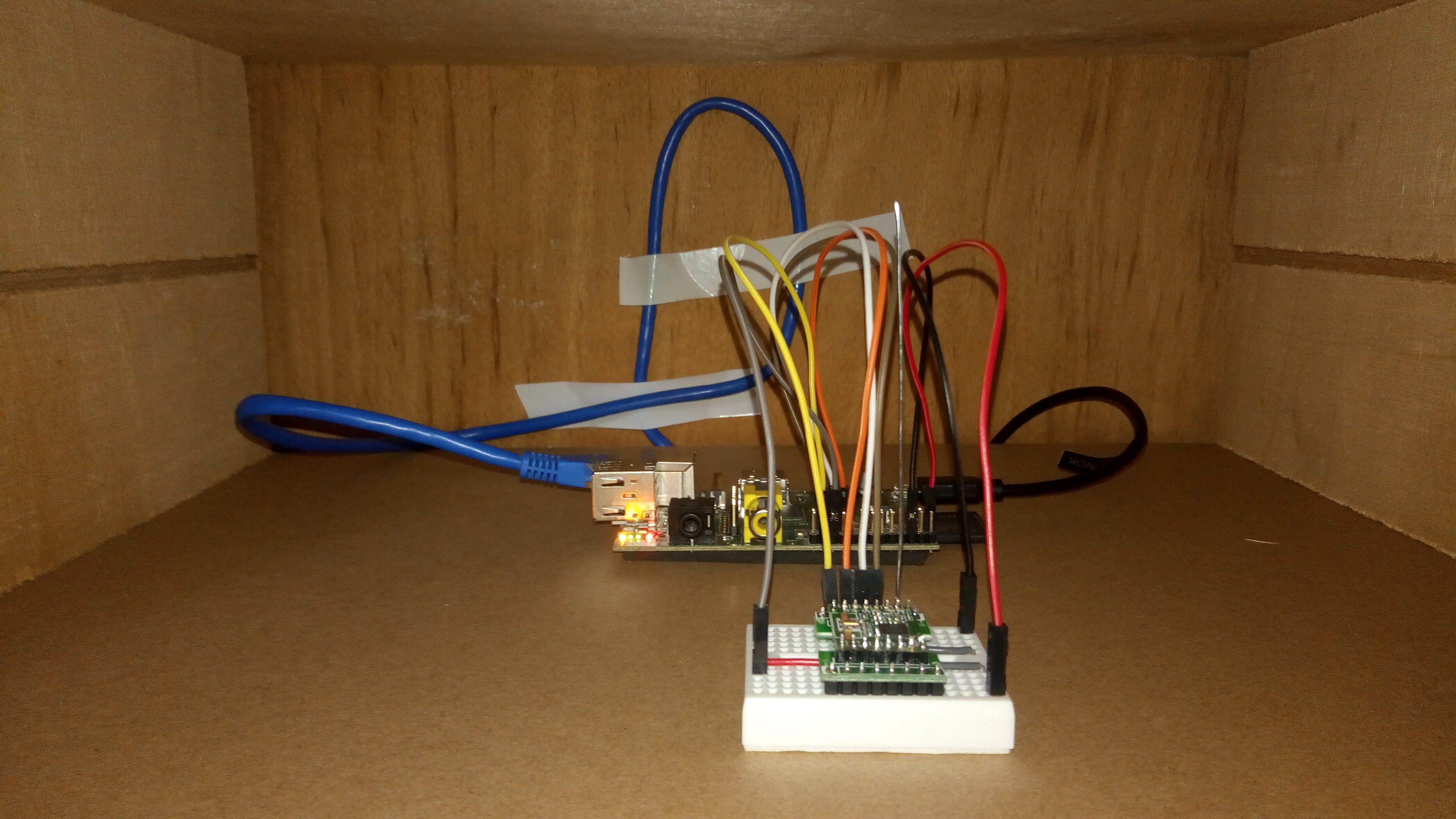

    Hello everyone!
    I am experiencing issues with my "pilot wire" node (controlling one of my heaters) since a few days.
    At 8:00 a.m., the MySensors gateway is supposed to send a V_PERCENTAGE message to the heater with "0" as payload, so that it goes into comfort mode and starts heating.
    At the opposite, at 10:00 p.m., a V_PERCENTAGE message with "3" as payload is sent to the heater so that it goes into "eco" mode.
    All communications are encrypted on my MySensors network and the pilot wire node requires signed messages. Everything was correctly set up (after long discussions here :stuck_out_tongue_winking_eye:) and it has been working well for months.
    However, I'm starting to get "!TSF:MSG:SIGN FAIL" messages on the MySensors gateway and the heater therefore fails to change of mode. Here are relevant logs:

    As you can see, when I noticed that the heater was cold at 10:10 a.m. this morning, I changed the mode back to something else ("Off", which failed) and changed again to comfort (and this time, it worked).
    Do you have any clue why this is happening? Note that I haven't touched to the hardware.
    Is there a way to tell MySensors to re-send a message if it fails? Or maybe I could do something on the HomeAssistant side?
    Also, note that the radios used are RFM69W modules. Regarding location, the node is at the basement, the gateway is upstairs and if you drew a line through the walls, the distance between both is approximately 15 meters, I'd say.
    Thanks in advance for your help!

          @encrypt the only things that comes to my mind is that your rf environment has shifted slightly or the noise level of the supply to the radio has increased to cause intermittent failure in the transmissions.
          You could try to switch channel for the radio and see if it helps? Or measure the stability of the power supply to the radio when the node(s) are communicating.

            Hello @Anticimex, thanks for your answer!
            You're right, since nothing changed on the hardware side, it may be a noise / power supply issue.
            Also, I should really finish making clean MySensors PCBs for that project and not rely on breadboards and stuff like that which is very likely to degrade the signal.
            I'll keep you updated with my progress, thanks again :)

              @encrypt for sure, going pcb will give the radio supply a better power signal (just remember to not make the trace too thin).
              But as you have had the rig operational for a long time, it might be worth checking other radio channels as well as perhaps some neighbor got some dirty rf toy or similar that mess with the rf environment.

                Well, I'm using RFM69W radios running on the 868MHz band.
                So, there should be a very low traffic on that band (compared to Wi-Fi).
                I'll probably add a capacitor near Vcc pin of the radio, I've just seen on the datasheet that it's recommended , although it seems there is already one on the board.
                Also, regarding the gateway, I plan to make a dipole antenna, since I don't have any space constraint.

                  @encrypt 868 MHz is not unique so there could be interference. But yes, decouple the hell out of it. You cannot go overboard with decoupling so if you have the space, go for both electrolythic and ceramic caps. Perhaps even a tantal to try to catch as many frequencies as possible.
                  Antenna will also help a ton if it is properly matched.

                    As you can see, the node finished starting at 12:13:25 but my first command at 12:13:25 failed.
                    If it was really a noise / power supply issue, I would expect presentation to fail, considering that it's a long process taking more than 5s and using the radio quite intensively.
                    I've read that people here got range issue with MySensors 2.3.x, isn't that linked? Here for instance:
                    • https://forum.mysensors.org/topic/9321/rpi-ethernet-gateway-with-rfm69h-c-w-very-poor-range/9
                    • https://forum.mysensors.org/topic/7912/rfm69-new-driver-delay/56
                    @tekka: It seems you were working on that, was it supposed to be fixed in version 2.3.1?
                    I can't enable radio logging easily but I suspect it could be caused by the auto-adjusting RSSI feature...

                      A Offline
                      A Offline
                      Anticimex
                      @encrypt noise sensitivity could be temperature related if the radio runs "hot"
                      Do you feel secure today? No? Start requiring some signatures and feel better tomorrow ;)
