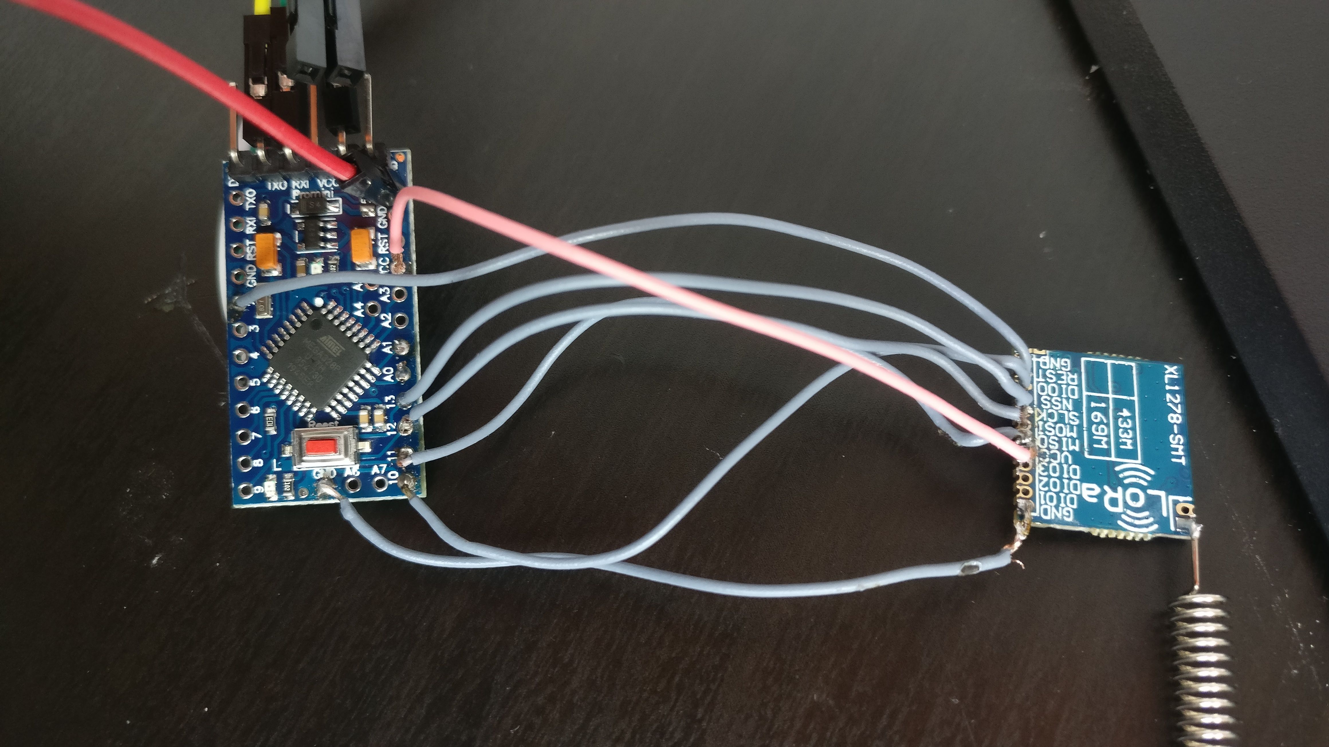

    Hi all,
    I am trying to read the soil moisture and send it via radio. Therefore I bought a SX1278 radio chip but can't get it run.
    It is connected to my 3.3V arduino pro mini like described in the documentation:
    SX1278 ->  Arduino Pro Mini 3.3V
    GND    ->  GND
    VCC    ->  VCC
    MISO   ->  MISO (D11)
    MOSI   ->  MOSI (D12)
    SLCK   ->  SCK (D13)
    NSS    ->  SS (D10)
    DIO0   ->  INT0 (D2)
    Everytime I fire the arduino up, I see the following messages (debug activated):
    208 MCO:BGN:INIT NODE,CP=RRNNA---,FQ=8,REL=255,VER=2.3.2
    335 TSM:INIT
    350 TSF:WUR:MS=0
    419 !TSM:INIT:TSP FAIL
    442 TSM:FAIL:CNT=1
    462 TSM:FAIL:DIS
    481 TSF:TDI:TSL
    What does that mean and how can I fix it?
    Thanks and regards!

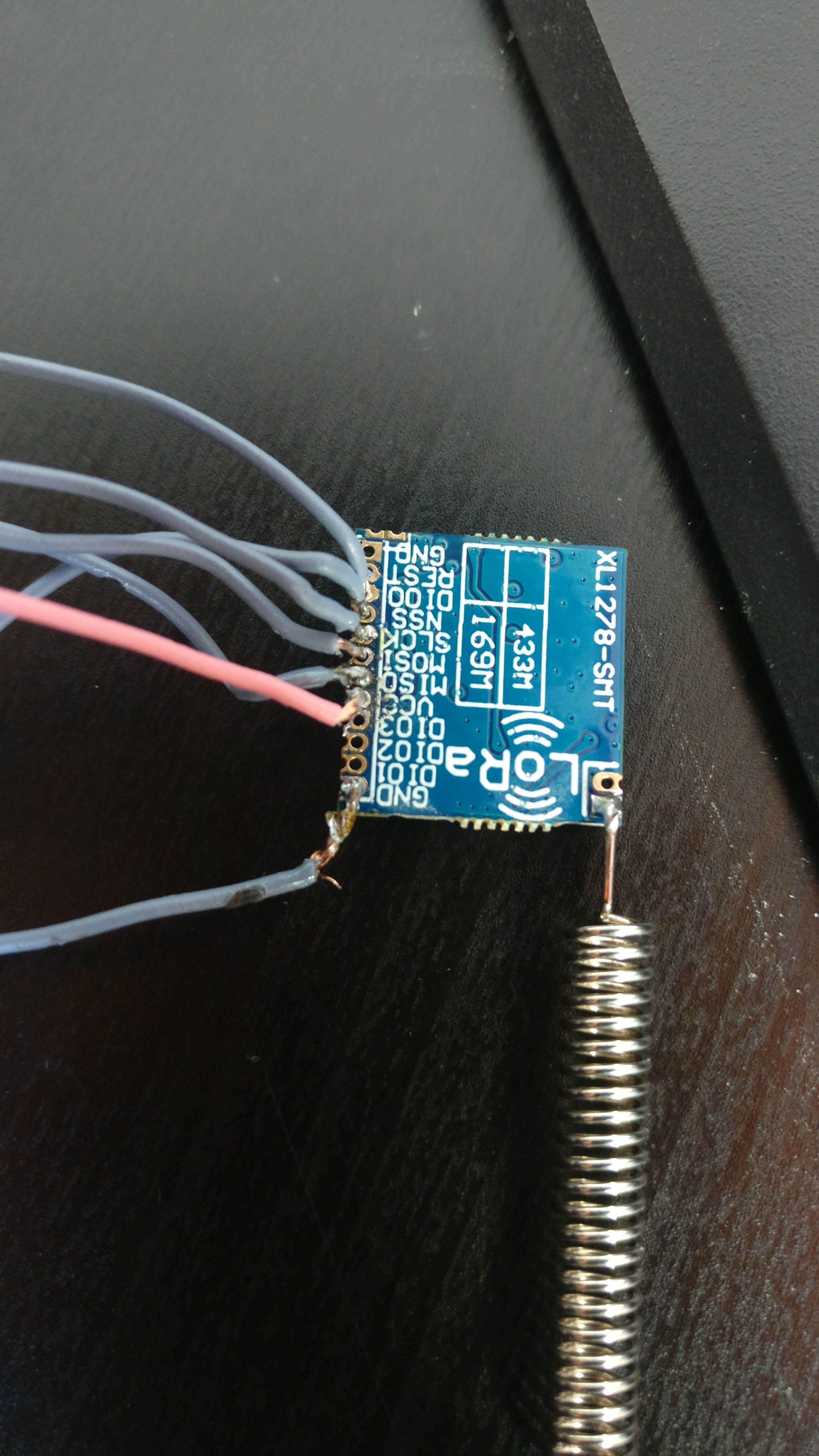

          Hi mfalkvidd,
          thanks for the welcome :upside_down_face:
          You're right, I should use RFM95 and I changed it. However the same error:
          208 MCO:BGN:INIT NODE,CP=RLNNA---,FQ=8,REL=255,VER=2.3.2
          335 TSM:INIT
          350 TSF:WUR:MS=0
          378 !TSM:INIT:TSP FAIL
          401 TSM:FAIL:CNT=1
          421 TSM:FAIL:DIS
          440 TSF:TDI:TSL
          Also I tried the log parser earlier but it just tells me "Transport device initialization failed". I need to figure out why it can't initialize that device. I quadrouple-checked the wires and can't see any issues :unamused:
          However here are some pcitures of it, maybe you find an issue? (Sorry, wiring is a bit messy :alien: )

            So do you see anything odd in my wiring or do you have any idea why this isn't working?
            • C cYnd
              @cYnd my guess would be insuffcient contact, or shorts between two or more pins. Learning to solder well takes some practice. You could use a multimeter to check if there are any shorts. Measuring good connectivity is trickier.

                @mfalkvidd I tested shorts with my multimeter and didn't find any shorts. However I should receive next week some new of these chips and I will try to solder them new. Let's hope that that's the issue!

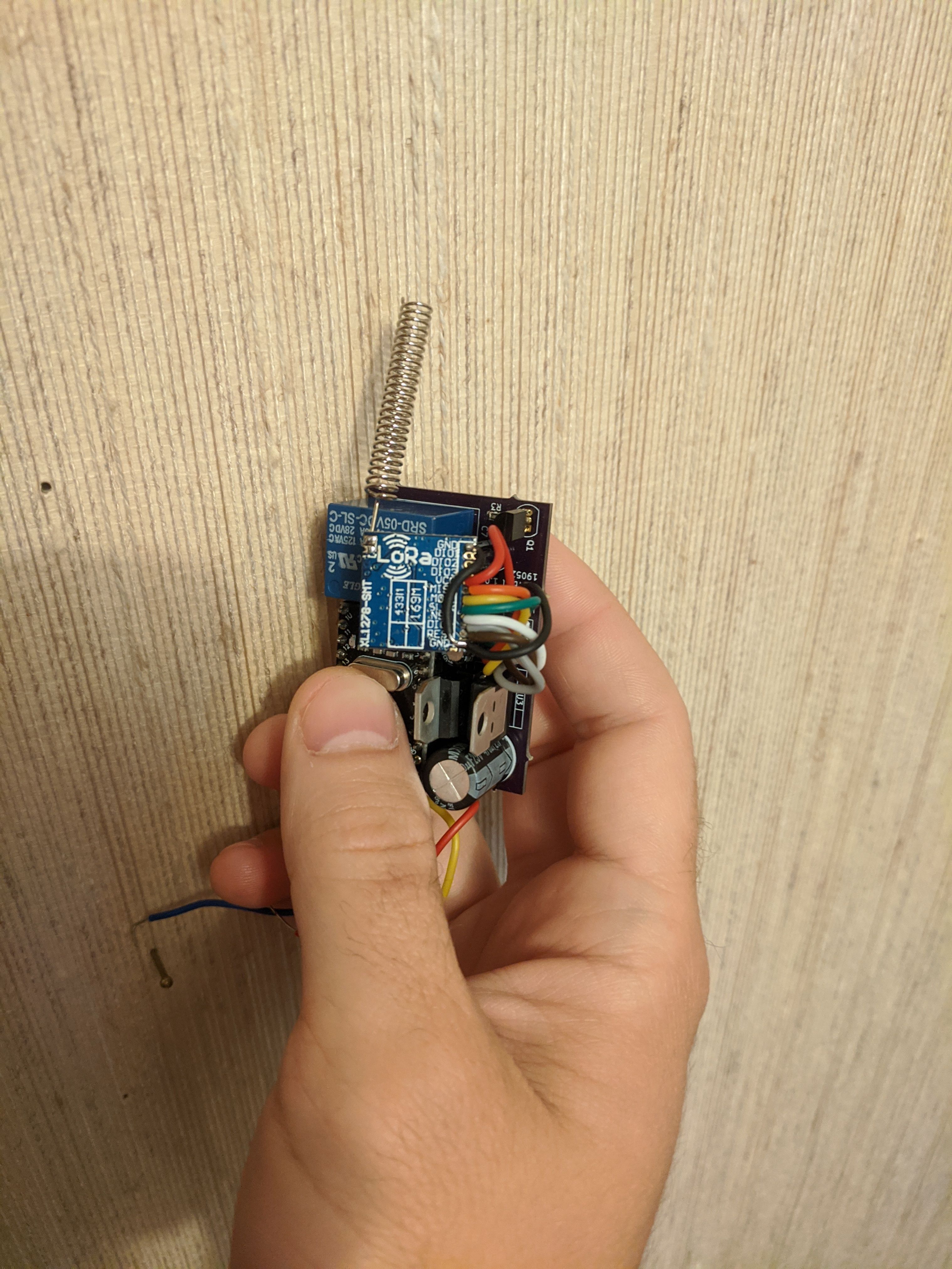

                                  Found a picture of my node. I hooked up both the GND pads. Can't remember if it was necessary.
                                  Still no luck with your module?

                                    @niclas Still no luck when connection both grounds. Also measured them and they are both connected, even without soldering an cable to it.
                                    I just ordered the RA AI02 modules so let's hope that these will arrive soon and will work (still didn't receive my replacements).
                                    A real pity that I can't get these to work :(

                                      @cYnd Well I'm out of ideas. Could be a hardware issue, perhaps you shorted something when handling the module or you exposed it to 5V?
                                      Is the VCC output from the Mini 5V or 3.3V? If you supply the mini board with 3.3V you should connect the module VCC to 'raw' if i remember correctly.

                                        Looking at the images, the wires might not be properly connected, a few wires look like they're just plugged in. In that case even the slightest movement could cause issues.
                                        C 1 Reply Last reply
                                        • A Avamander
                                          C
                                          C
                                          cYnd
                                          @Avamander The cables are solder from the other side and I just took a picture of the side with the writing so you can trace if it's correctly wired.
                                          A 1 Reply Last reply
