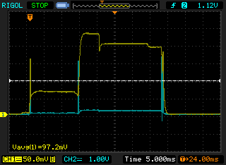

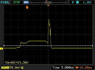

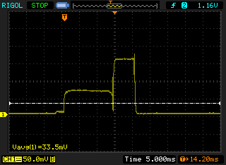

                  I finally got around to measuring power consumption, with some good results. I made two nodes that were identical except one with a CC1101 and the other on an RF24 network. The nodes had a single SHT31 temp/humidity sensor and woke up every 10s to transmit a single temperature value.
                  I measured power consumption with an oscilloscope across a 10 ohm shunt on the battery line, so current is v/10. For both nodes, sleep current was near identical, around 4.5uA.
                  Values for TX over a 60mS window:
                  • On the CC1101 without MY_PASSIVE_NODE, average current draw during TX was 9.7mA.
                  • When I enabled MY_PASSIVE_NODE, this dropped considerably down to 3.3mA.
                  • For RF24 both with and without MY_PASSIVE_NODE, current was 2.2mA.

                  The use of MY_PASSIVE_NODE helps on CC1101, as the node does a 'fire-and-forget' on TX. Without this, it listens for an ack from the gateway, drawing RX current. For RF24, the ack is handled in hardware which is considerably quicker.
                  Some graphs! The ~12mS hump before TX is the SHT31 acquisition.
                  RF24 transmit (not sure what the initial 4ms bump is, radio coming out of sleep maybe?):
                  CC1101 active mode (blue curve is CC1101 CLK line):
                  CC1101 passive node:
                  So yeah, interesting results, in summary the CC1101 is a bit more power hungry than the RF24, but results in only around 10% drop in battery life if used in passive mode (or 50% in active mode).
