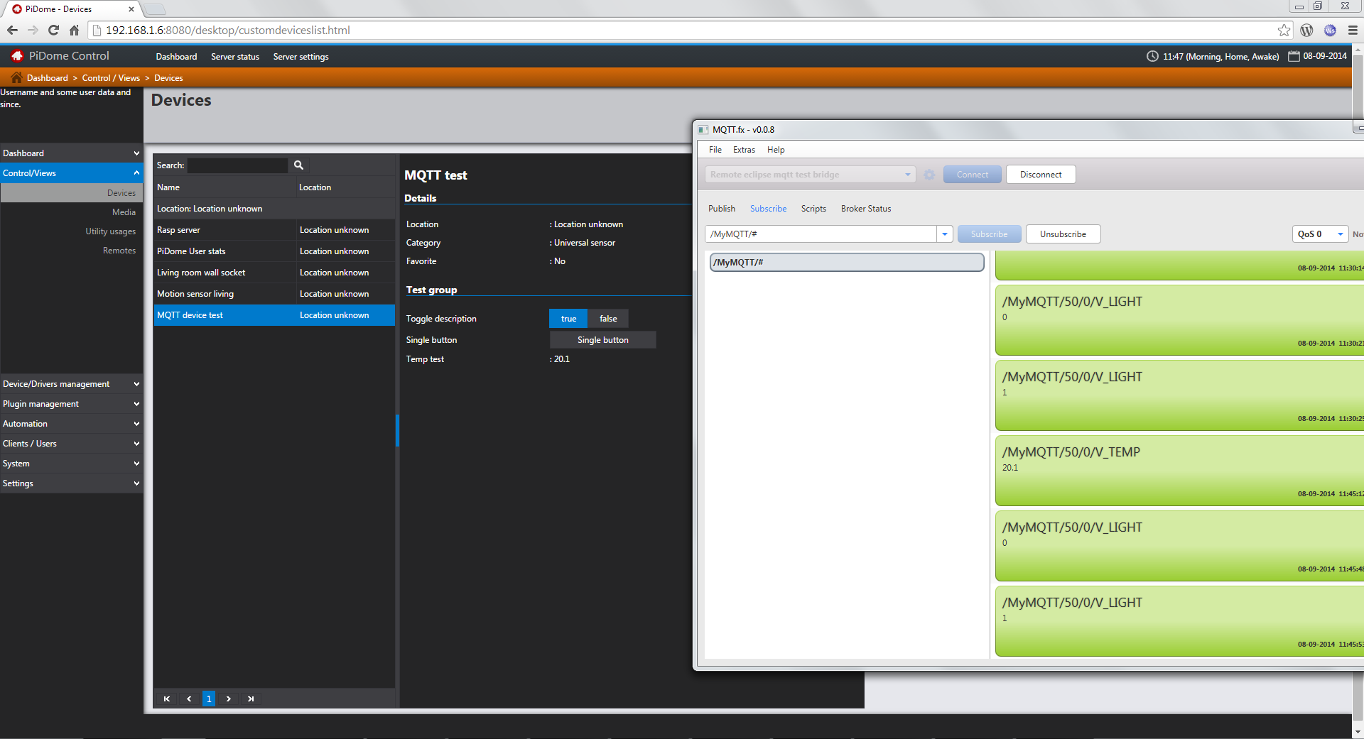

    I have added an MQTT bridge for MySensors based on the gateway/broker created by @Damme .
    I was only not being able to test it on the real gateway but have tested it against a regular MQTT server. So if there is someone willing to test it i will be very thankful :). The tests i have done was with iot.eclipse.org, so i'm also not exactly sure if the data is implemented correctly
    iot.eclipse.org test method
    It has been implemented as a plugin which has the possibility to execute device mutations, so to add this plugin go to "Plugin management > Device Plugins". Click "Add new plugin". Choose the "MySensors MQTT bridge".
    Fill in a name and description, use the MQTT gateway ip address. leave the port and prefix as the shown default if you have not changed it.
    To create devices for the MQTT gateway refer to the first post and instead choosing the MySensors serial device, choose the MySensors MQTT device.
    The plugin's view shows devices reported by the MQTT gateway, it shows the device address and sketch information. Adding devices shown on that page is exact the same as done with the serial version.

  • @John Hi I am back again. I now can see the MQTT node sensor. When I want to add the node sensor the custom devices don't show up in the "Select device to use" Why will that be?
    Custom device adde
    upload-c9a0b7b8-0e8a-4b1b-8d98-0bd9584820e9
    Custom device not show.
    upload-245527f8-f376-400c-96d2-b46432d82a93
  • Plugin Developer
    Device skeletons are limited to their driver/plugin and can not be interchanged (yet). When you are using the MQTT plugin you should create a MySensors MQTT custom device/skeleton. The first listing above shows these devices as a device for the serial version.
  • @john Mysensor MQTT is now working. Thank for all you help 🙂 👍
