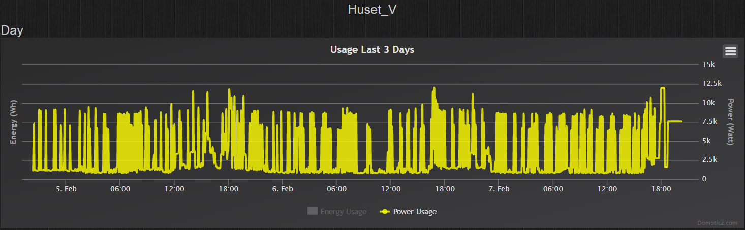

    I except it to report every 20 second but it can be 2 minutes or 20 seconds and right now it was 15 minutes ago.
    Am I right if the Watt needs to be change otherwise it will not send Watt update?
    Same for kWh, also need to change before updating.
    This Meter is for my heating system and right now it is not working so much.
    I also have a second Nano measuring my whole house, that one is sending every 5 minutes as I expect. But there will almost never be same Watt and kWh is changing much quicker.

      @flopp could you post serial output from the node, including the startup phase after a reset?
      F 1 Reply Last reply

                              There must be something wrong with my code. Since 1 February my Arduino is 3 kWh before the real energy value for my house.
                              My second Arduino is measuring kWh on my heating system and that one is running correct.
                              For my house I use Nano(clone) for heating system I use UNO(original)
                              Can the hardware be the bad guy here?
                              It should be same code in both Arduino but tomorrow I will use an UNO(org) for my house and wait 1 week.
                              Y 1 Reply Last reply

                                    I changed to a UNO now my Watt is showing the same value!!
                                    EDIT: this was because the WATT was above 15000 and then it didn't send any data to Controller. I had values up to 110000.
                                    It must be something with the Watt calculation. Anyone seen this before?
                                    • F Offline
                                      F Offline
                                      flopp
                                      I think I found it.
                                      if (interval<10000L) { // Sometimes we get interrupt on RISING
                                            return;
                                      It seems to be that my interrupt is to quick. above code is default if I change to
                                      if (interval<35000L) { // Sometimes we get interrupt on RISING
                                            return;
                                      it will calculate Watt as I think it should be.
                                      I will let it run for a week and see if kWh is OK now.
