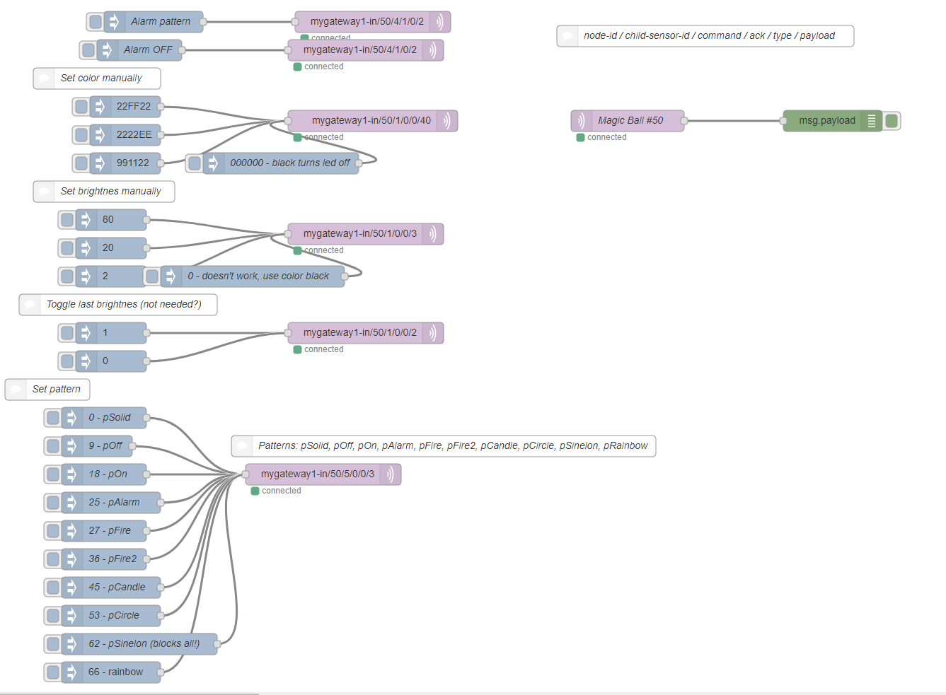

    I made a few changes to my Wall mounted 'mood light' and translated it to MySensors v2.
    0_1474615675050_upload-71b7410c-eae1-43a3-abf8-d074aff5058a
    The sketch shows an example of using a Domoticz selector switch attached to a dimmer (V_PERCENTAGE) to switch between the different light patterns (line 413). I'm pretty sure you can use this trick for more controllers.
    0_1474615943349_upload-f05ed149-c991-4e54-84df-ef1585d32ed9

  • If someone still needs it, I managed to control it via mqtt (node-red). I am about to integrate it into the openhab, it might be easier to start that but I wanted to have good control over it (and understand mqtt a bit better).
    In sketch I had to change
    } else if (message.type == V_DIMMER) { // if DIMMER type, adjust brightness
    to V_PERCENTAGE for latest api/mqtt
    and I am still struggling a bit to turn all LEDs off completely. Only way I could achieve this was to set color to black (000000). code as it is always leaves my LEDs to 1% or something. But that might be due to node-red implementation, as I do not have response from node-red on "questions" from the node (at some point in code node will ask controller about some values (color if I remember correctly), but I just send the color and brightness manually via injectors). I guess this can be fixed on the controller side, and most likely works with openhab implementation.
    Here are the triggers in node-red
    Here is the node-red code
    [{"id":"8f6785a0.874838","type":"debug","z":"8cfe95c3.331248","name":"","active":true,"console":"false","complete":"false","x":1210,"y":180,"wires":[]},{"id":"a300f395.f6e59","type":"mqtt out","z":"8cfe95c3.331248","name":"","topic":"mygateway1-in/50/5/0/0/3","qos":"","retain":"","broker":"9daccc99.b6c71","x":490,"y":680,"wires":[]},{"id":"45adf375.e59b6c","type":"inject","z":"8cfe95c3.331248","name":"9 - pOff","topic":"","payload":"9","payloadType":"str","repeat":"","crontab":"","once":false,"x":170,"y":640,"wires":[["a300f395.f6e59"]]},{"id":"859588e.a1bec78","type":"mqtt out","z":"8cfe95c3.331248","name":"","topic":"mygateway1-in/50/1/0/0/40","qos":"","retain":"","broker":"9daccc99.b6c71","x":560,"y":180,"wires":[]},{"id":"39b0ef0e.94ef","type":"inject","z":"8cfe95c3.331248","name":"","topic":"","payload":"22FF22","payloadType":"str","repeat":"","crontab":"","once":false,"x":210,"y":160,"wires":[["859588e.a1bec78"]]},{"id":"9dabd8f3.6033b8","type":"inject","z":"8cfe95c3.331248","name":"Alarm pattern","topic":"","payload":"1","payloadType":"str","repeat":"","crontab":"","once":false,"x":250,"y":40,"wires":[["3a117d06.451d12"]]},{"id":"3a117d06.451d12","type":"mqtt out","z":"8cfe95c3.331248","name":"","topic":"mygateway1-in/50/4/1/0/2","qos":"","retain":"","broker":"9daccc99.b6c71","x":560,"y":40,"wires":[]},{"id":"e3c2d218.e92dc","type":"mqtt out","z":"8cfe95c3.331248","name":"","topic":"mygateway1-in/50/4/1/0/2","qos":"","retain":"","broker":"9daccc99.b6c71","x":550,"y":80,"wires":[]},{"id":"5325f52d.2549fc","type":"inject","z":"8cfe95c3.331248","name":"Alarm OFF","topic":"","payload":"0","payloadType":"str","repeat":"","crontab":"","once":false,"x":230,"y":80,"wires":[["e3c2d218.e92dc"]]},{"id":"f9bc44c0.c1f2d8","type":"mqtt in","z":"8cfe95c3.331248","name":"Magic Ball #50","topic":"mygateway1-out/50/#","qos":"2","broker":"9daccc99.b6c71","x":920,"y":180,"wires":[["8f6785a0.874838"]]},{"id":"6a07f043.d5e8a","type":"comment","z":"8cfe95c3.331248","name":"node-id / child-sensor-id / command / ack / type / payload","info":"","x":1030,"y":60,"wires":[]},{"id":"f71ad6cd.2044a8","type":"inject","z":"8cfe95c3.331248","name":"","topic":"","payload":"2222EE","payloadType":"str","repeat":"","crontab":"","once":false,"x":210,"y":200,"wires":[["859588e.a1bec78"]]},{"id":"44e58ecb.748fb","type":"inject","z":"8cfe95c3.331248","name":"","topic":"","payload":"991122","payloadType":"str","repeat":"","crontab":"","once":false,"x":210,"y":240,"wires":[["859588e.a1bec78"]]},{"id":"a91be428.b74eb8","type":"comment","z":"8cfe95c3.331248","name":"Set color manually","info":"","x":170,"y":120,"wires":[]},{"id":"90b541d2.c2abf","type":"mqtt out","z":"8cfe95c3.331248","name":"","topic":"mygateway1-in/50/1/0/0/3","qos":"","retain":"","broker":"9daccc99.b6c71","x":550,"y":340,"wires":[]},{"id":"91fe4122.027e3","type":"inject","z":"8cfe95c3.331248","name":"","topic":"","payload":"80","payloadType":"str","repeat":"","crontab":"","once":false,"x":190,"y":320,"wires":[["90b541d2.c2abf"]]},{"id":"47bc1da0.380374","type":"inject","z":"8cfe95c3.331248","name":"","topic":"","payload":"20","payloadType":"str","repeat":"","crontab":"","once":false,"x":190,"y":360,"wires":[["90b541d2.c2abf"]]},{"id":"baa820db.90109","type":"inject","z":"8cfe95c3.331248","name":"","topic":"","payload":"2","payloadType":"str","repeat":"","crontab":"","once":false,"x":190,"y":400,"wires":[["90b541d2.c2abf"]]},{"id":"709b3196.8abe","type":"comment","z":"8cfe95c3.331248","name":"Set brightnes manually","info":"","x":180,"y":280,"wires":[]},{"id":"1cf7aba7.c34224","type":"mqtt out","z":"8cfe95c3.331248","name":"","topic":"mygateway1-in/50/1/0/0/2","qos":"","retain":"","broker":"9daccc99.b6c71","x":550,"y":480,"wires":[]},{"id":"4263529d.67e44c","type":"inject","z":"8cfe95c3.331248","name":"","topic":"","payload":"1","payloadType":"str","repeat":"","crontab":"","once":false,"x":190,"y":480,"wires":[["1cf7aba7.c34224"]]},{"id":"2528b5c4.d1bc6a","type":"inject","z":"8cfe95c3.331248","name":"","topic":"","payload":"0","payloadType":"str","repeat":"","crontab":"","once":false,"x":190,"y":520,"wires":[["1cf7aba7.c34224"]]},{"id":"e2707070.7e9dc","type":"comment","z":"8cfe95c3.331248","name":"Toggle last brightnes (not needed?)","info":"","x":200,"y":440,"wires":[]},{"id":"3b8f804c.e92f7","type":"inject","z":"8cfe95c3.331248","name":"18 - pOn","topic":"","payload":"18","payloadType":"str","repeat":"","crontab":"","once":false,"x":180,"y":680,"wires":[["a300f395.f6e59"]]},{"id":"d9d700e9.90d03","type":"inject","z":"8cfe95c3.331248","name":"27 - pFire","topic":"","payload":"27","payloadType":"str","repeat":"","crontab":"","once":false,"x":180,"y":760,"wires":[["a300f395.f6e59"]]},{"id":"b2cd2709.3706e8","type":"inject","z":"8cfe95c3.331248","name":"0 - pSolid","topic":"","payload":"0","payloadType":"str","repeat":"","crontab":"","once":false,"x":180,"y":600,"wires":[["a300f395.f6e59"]]},{"id":"a3c976d.8dbe488","type":"comment","z":"8cfe95c3.331248","name":"Patterns: pSolid, pOff, pOn, pAlarm, pFire, pFire2, pCandle, pCircle, pSinelon, pRainbow","info":"","x":660,"y":640,"wires":[]},{"id":"667c092c.9b9298","type":"inject","z":"8cfe95c3.331248","name":"36 - pFire2","topic":"","payload":"36","payloadType":"str","repeat":"","crontab":"","once":false,"x":180,"y":800,"wires":[["a300f395.f6e59"]]},{"id":"ca6823c6.a674","type":"inject","z":"8cfe95c3.331248","name":"25 - pAlarm","topic":"","payload":"25","payloadType":"str","repeat":"","crontab":"","once":false,"x":190,"y":720,"wires":[["a300f395.f6e59"]]},{"id":"75c152f3.3c287c","type":"inject","z":"8cfe95c3.331248","name":"45 - pCandle","topic":"","payload":"45","payloadType":"str","repeat":"","crontab":"","once":false,"x":190,"y":840,"wires":[["a300f395.f6e59"]]},{"id":"6da316d0.eebd68","type":"inject","z":"8cfe95c3.331248","name":"53 - pCircle","topic":"","payload":"53","payloadType":"str","repeat":"","crontab":"","once":false,"x":190,"y":880,"wires":[["a300f395.f6e59"]]},{"id":"2c15c208.c1db0e","type":"inject","z":"8cfe95c3.331248","name":"62 - pSinelon (blocks all!)","topic":"","payload":"62","payloadType":"str","repeat":"","crontab":"","once":false,"x":230,"y":920,"wires":[["a300f395.f6e59"]]},{"id":"431aad05.60f7e4","type":"inject","z":"8cfe95c3.331248","name":"","topic":"","payload":"66 - rainbow","payloadType":"str","repeat":"","crontab":"","once":false,"x":190,"y":960,"wires":[["a300f395.f6e59"]]},{"id":"b1b44b6e.1492a8","type":"comment","z":"8cfe95c3.331248","name":"Set pattern","info":"","x":100,"y":560,"wires":[]},{"id":"70d088e7.889c98","type":"inject","z":"8cfe95c3.331248","name":"0 - doesn't work, use color black","topic":"","payload":"0","payloadType":"str","repeat":"","crontab":"","once":false,"x":390,"y":400,"wires":[["90b541d2.c2abf"]]},{"id":"d5d24b03.2a6288","type":"inject","z":"8cfe95c3.331248","name":"000000 - black turns led off","topic":"","payload":"000000","payloadType":"str","repeat":"","crontab":"","once":false,"x":430,"y":240,"wires":[["859588e.a1bec78"]]},{"id":"9daccc99.b6c71","type":"mqtt-broker","z":"","broker":"localhost","port":"1883","clientid":"","usetls":false,"compatmode":false,"keepalive":"60","cleansession":true,"willTopic":"","willQos":"0","willPayload":"","birthTopic":"","birthQos":"0","birthPayload":""}]

  • Hi @adds666 . I think it is this bit in the receive() function near the bottom of the code. It gets the value from the V_PERCENTAGE message and maps into the setPattern value:
    case RGB_NextPatternChild:              // next pattern
      if (message.type == V_PERCENTAGE) {       //  Percentage indicates the pattern
        setPattern = map(message.getInt(), 0, 100, 0, 15) % lastPatternIdx  ; // mapper dimmer value to state 0..9  and wrap
        setLightPattern((setPattern), 500 );
        Sprint("Pattern: ") ; Sprintln(setPattern) ;
      } else if (message.type == V_STATUS){     // if off switch pattern to default == 0
        setPattern = 0  ;
      break ;
  • Hi @nagelc , thanks for coming back to me - Apologies I didn't realise you'd replied nearer the time.
    Am I right in thinking, so long as I define the new patterns function later on in the sketch - I can include it in the switch of function updateLightPattern, and it will be added to the mapping?
    How do we know what definitive figures the 0 to 100 percentage map to in 0 to 15? Or is that basic arithmetic and each switch state will be called in each 'chunk'. I also only count 10 items in the switch state. Does that mean we can add 5 more? and if wanting more than 15 simply change our mapping size to have more?
    Appreciate the help.
