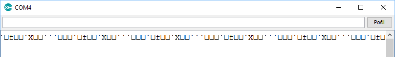

                    @dbemowsk so i added the usb device, it produces gibberish:
                    ~þx
                    different baud-rates, gibberish changes.....
                    gibberish from the node, but nothing from gateway, I also changed gateway to uno as a test without success, here is the code on gateway which i commented out:

                      @skatun
                      When working with serial communication, gibberish means that your nodes are talking at different baud rates. Once you get the same baud on both ends, you should see something readable. What baud rate do you have your node set to for the software serial connection? Whatever that is set to is the baud rate that you need to set the USB device to. Once you get that communicating, then check the software serial baud on the gateway. The problem could be that you have differing baud rates on both. If that is the case, your gateway is seeing similar gibberish that you are seeing on your USB adapter and thus does not know what to do with it.
                      Another thing is that if you have your baud rate set too high, even though both sides are using matching baud rates, you can still see gibberish. Try starting everything on a lower baud like 9600. If that works, try the next baud rate, and the next. You may be able to run at 115200, but if you have debugging turned on it may have trouble communicating at that speed.
                      Also, don't confuse your hardware serial with your software serial. This is the hardware UART serial baud definition:
                      Serial.begin(115200);
                      And this is the software serial baud definition:
                      RS485Serial.begin(9600);
                      These do not necessarily need to match. It is the software serial at all points that need to match.
                      Let me know if any of that helps.

                        @skatun
                        I found the solution.
                        Look at this
                        Place the following in your Node-Sketch e.g. for Node ID 23
                         #define MY_NODE_ID 23
                        and the communication between node and Gateway is ok.
                        I hope this works for you.

                          I faced similar situation when I was accidentally connected rx & tx wrong way around on my GW. The sensor node was constantly polling for parent but got no response.
                          The "gibberish" on RS485 bus might also be the control chars the transport uses.. SOH, STX, ETX and EOT.

                                      Serial.println(receivedOnRS485);

                                      @wimd As my reply stated in the other thread, it would be helpful to see all sketches being used so we can determine better where the problem may lie.

                                        @dbemowsk It are the standard examples.
                                        For the gateway (Uno) :
                                         * The RS485 Gateway prints data received from sensors on the serial link.
                                         * The gateway accepts input on seral which will be sent out on
                                         * the RS485 link.
                                         * Wire connections (OPTIONAL):
                                         * - Inclusion button should be connected between digital pin 3 and GND
                                         * - RX/TX/ERR leds need to be connected between +5V (anode) and digital pin 6/5/4 with resistor 270-330R in a series
                                         * LEDs (OPTIONAL):
                                         * - To use the feature, uncomment MY_LEDS_BLINKING_FEATURE in MyConfig.h
                                         * The gateway uses AltSoftSerial to handle two serial links
                                         * on one Arduino. Use the following pins for RS485 link
                                         *  Board          Transmit  Receive   PWM Unusable
                                         * Teensy 3.0 & 3.1  21        20         22
                                         * Teensy 2.0         9        10       (none)
                                         * Teensy++ 2.0      25         4       26, 27
                                         * Arduino Uno        9         8         10
                                         * Arduino Leonardo   5        13       (none)
                                         * Arduino Mega      46        48       44, 45
                                         * Wiring-S           5         6          4
                                         * Sanguino          13        14         12
                                        // Enable RS485 transport layer
                                        #define MY_RS485
                                        // Define this to enables DE-pin management on defined pin
                                        #define MY_RS485_DE_PIN 2
                                        // Set RS485 baud rate to use
                                        #define MY_RS485_BAUD_RATE 9600
                                        // Enable serial gateway
                                        #define MY_GATEWAY_SERIAL
                                        // Flash leds on rx/tx/err
                                        #define MY_LEDS_BLINKING_FEATURE
                                        // Set blinking period
                                        // Enable inclusion mode
                                        #define MY_INCLUSION_MODE_BUTTON_PIN  3
                                        #define MY_DEFAULT_ERR_LED_PIN 4  // Error led pin
                                        #define MY_DEFAULT_RX_LED_PIN  5  // Receive led pin
                                        #define MY_DEFAULT_TX_LED_PIN  6  // the PCB, on board LED
                                        void presentation() {
                                         // Present locally attached sensors
                                          // Send locally attached sensor data here
                                        For the sensor (Nano):
                                         * REVISION HISTORY
                                         * Version 1.0 - Henrik Ekblad
                                         * This is an example of sensors using RS485 as transport layer
                                         * Motion Sensor example using HC-SR501
                                         * http://www.mysensors.org/build/motion
                                         * The transport uses AltSoftSerial to handle two serial links
                                         * Wiring-S           5         6          4
                                         * Sanguino          13        14         12 *
                                        #define MY_RS485
                                        unsigned long SLEEP_TIME = 120000; // Sleep time between reports (in milliseconds)
                                        #define DIGITAL_INPUT_SENSOR 3   // The digital input you attached your motion sensor.  (Only 2 and 3 generates interrupt!)
                                        #define CHILD_ID 1   // Id of the sensor child
                                        // Initialize motion message
                                        MyMessage msg(CHILD_ID, V_TRIPPED);
                                          pinMode(DIGITAL_INPUT_SENSOR, INPUT);      // sets the motion sensor digital pin as input
                                          sendSketchInfo("Motion Sensor", "1.0");
                                          present(CHILD_ID, S_MOTION);
                                          // Read digital motion value
                                          boolean tripped = digitalRead(DIGITAL_INPUT_SENSOR) == HIGH;
                                          Serial.println(tripped);
                                          send(msg.set(tripped?"1":"0"));  // Send tripped value to gw
                                          // Sleep until interrupt comes in on motion sensor. Send update every two minute.
                                          sleep(digitalPinToInterrupt(DIGITAL_INPUT_SENSOR), CHANGE, SLEEP_TIME);
                                        skatunS 1 Reply Last reply

                                          @wimd include debug and remove inclusion from the sketches and it should be ok. I have ordered new rs485 shield, i expect that to be the issue..
