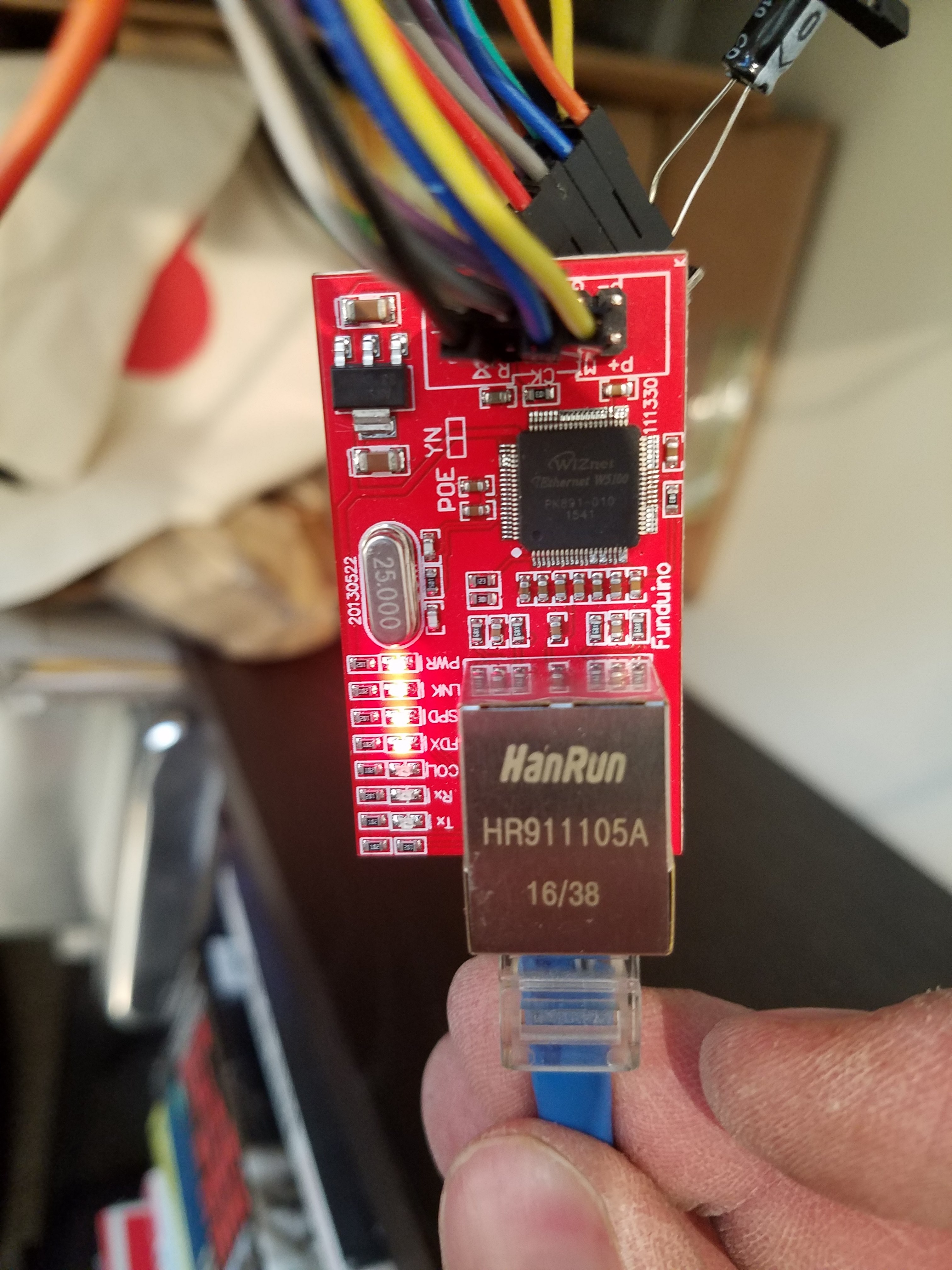

              What issues did you have? I'm trying to add an Ethernet gateway and I'm having a hell of a time. I get everything set up but when I press the include button, nothing.

                @hoggin Do you have the following in your gateway sketch?

                  @blacey Yes, I have that line included. My other thought was that I was using a MINI USB Nano V3.0 ATmega328P CH340G which is not the FT232RL. Do you think that will make a big difference? I have gone through the troubleshooting/debugging guide and cant seem to nail down the problem. I have even taken the working serial plugin on vera and tried to turn it into the ethernet plugin by adding the IP address and still, once I add the IP address, the include function stops working.

                    @hoggin I suggest that you step through the trouble-shooting steps below (in order):
                    1. Ensure the Vera can see your gateway over USB, the most basic part of the connection - https://forum.mysensors.org/topic/5289/ui5-to-ui7-update/4
                    2. Ensure that the right plugin files are installed on your vera - https://forum.mysensors.org/topic/5289/ui5-to-ui7-update/12
                    3. If #1 and #2 checkout, then try the Serial Port troubleshooting section here - https://www.mysensors.org/controller/vera#configuring-the-vera-plugin-for-the-serialusb-gateway

                      Im not sure if we are on the same page. I already have a hookup with my vera via USB and that is working fine. Separately, I was trying to add this Ethernet setup. I can get the ethernet to connect, or so I think but the inclusion mode is just totally not working. You can see the logs from the arduino and also the uploaded code. I have tried the different versions of the library and still nothing. Again, everything works fine with my current setup with the vera and the USB connection but not this new setup (Ethernet to the vera).

                      This is what I get out of the serial monitor. Everything seems to be normal. I even think that it acts like a repeater for other devices but it just wont all me to include other devices.
                      0;255;3;0;9;MCO:BGN:INIT GW,CP=RNNGA--,VER=2.1.1

                        @hoggin Ok, it seems that your Ethernet gateway is rebooting frequently, especially when it receives a message. This behavior is usually indicative of a power problem.
                        TSF:MSG:READ,2-2-0,s=3,c=1,t=2,pt=0,l=1,sg=0:0
                        TSF:MSG:ACK
                        That translates to (using the log parser):
                        1. Have you installed a capacitor between GND and VCC on your NRF? If so, what is the capacitance rating?

                            @hoggin said in Ethernet gateway shows up on vera , but doens't want to include devices:
                            On the radio I have a 4.7uF50v
                            Arduino IDE 1.6.12
                            1) Power
                            Ok, the 4.7uf50v should be ok - if you have a 47uf, that would be better. Given the capacitor is a bit on the low side with respect to capacitance, then check your power supply. For example, if you are powering the gateway over USB, then there may not be enough current to drive everything when the radio demands power. Try an external power source that can deliver up 1A of current. Another option would be to connect a powered USB hub to your Vera and connect the Gateway to the powered USB hub (that is exactly how I have connected my Ethernet Gateway to my Vera Plus).
                            2) Software
                            There was an issue with the Arduino IDE with certain Board revisions that caused MCU resets/crashes due to a compiler bug (sorry but I don't recall the exact version but it was circa 1.6.x). You might want to try upgrading your Arduino IDE to 1.8.1 and then check the Boards Manager within the IDE to ensure you are using Arduino AVR Boards 1.6.17. Recompile your sketch, re-upload and see if that mitigates the crashes.
                            Please try these one at a time and report back which one resolves the issue for you.

                              @blacey Thanks again for the suggestions. I tried several.
                              • I switched the capacitor to a 47uF 25v. When I did that, there was no change.
                              • I checked the boards manager and everything is as you said.
                              • I changed the power supply to a 1 amp and then also a 2 amp and tried to power everything VIA or THROUGH the arduino and then also I tried to power everything separtely and just split off to each device and still nothing.
                              • I also changed out the radio module just to make sure it wasnt a bad unit or something like that.
                              • I also upgraded IDE to the latest and uploaded that new code from the new IDE and still nothing.
                              • I used a powered USB hub and hooked it up to the computer so I could still read the serial and still, nothing.
                              • I tried to use the 3.3v from the nano and also separately from a voltage regulator that was suggested in the tutorial and still, nothing.
                              Everytime I try this ideas I get the same log as I did before.
                              I cant think of anything else to try. Im thinking there must be something wrong with my ethernet board? Is the wire I am using to small for this particular application. I used these same jumpers to make the USB gateway and everything seems to be fine. Attached is a pic of the ethernet module Im using and then another pic of the setup in case you see something glaring that is wrong. Let me know if you need more pics.
                              Thanks

                                @hoggin It sounds like you are doing all the right things but it still looks like a radio power problem, especially if you are now running the latest IDE and atmel boards file. For additional context, here is a good reference for solving NRF power issues - https://arduino-info.wikispaces.com/Nrf24L01-2.4GHz-HowTo#PP
                                Which 3.3VDC LDO did you use? I recently had power issues using an LE33ACZ regulator and had to switch to an AMS117 3.3V to solve the problem because the LE33ACZ couldn't deliver enough amperes.
                                That said, don't run anything off the nano built-in voltage regulator because it typically can't supply enough current. I would power the nano over USB, power a high-current 3.3v LDO regulator from an external 5VDC power supply for the radio with a 47uf capacitor and direct connect the 5VDC external power supply into the WS5100 Ethernet module (ensure there is a common ground between all).
                                I have a nano, NRF24L01+ and WS5100 on hand but I think if I try to repo your problem I won't be able to because it is something specific to your config...

                                  @blacey I was using the LE33ACZ. So are you pretty positive that this is a radio problem and not an ethernet problem? I ordered several of the AMS117 units and will have to wait for them to arrive to begin the testing.
                                  blaceyB 1 Reply Last reply
                                  • H hoggin
                                    blaceyB
                                    blaceyB
                                    blacey
                                    Yes, I am... Your gateway reboots when the radio sends an ACK. I had the exact same problem/symptoms that you are experiencing on a serial gateway and a couple nodes and switching the LE33ACZ out for an AMS117 to power the radio, albeit on a node, and in my case adding additional capacitors, resolved the issues. The gateway and nodes ran perfectly for years but failed when I upgraded to a newer version of the MySensors library - the root cause was that the MySensors protocol stack had been optimized significantly (thanks to @tekka) so it was able to drive the radio a bit harder which in turn increased the current. We even toyed with adding an option to slow the protocol stack down but quickly cast that aside.
                                    Please let us know the results when you replace the LE33ACZ LDO with an AMS117.

                                      @blacey Took a while to get the part for the new power supply but I finally got it. Turns out that it was not the problem. I reattached everything both with separate power supplies and with just one 2 amp power supply and still I got the rebooting. With all of this in mind I went hunting for more answers. I FINALLY figured it out. I found another post here and here that got me down the right path. I had upgraded everthing per everyones recommenations and that seemed to be causing the issue. I downgraded to "Arduino IDE 1.6.11" and that worked. I completely uninstalled arduino from my system and just started over with the older version. I assembled everything as I had done before and it just fired right up. The mysensors library I used was 2.0.0 and again it all worked perfectly. I was amazed. I didnt have to comment out the debug or do anything other than follow the tutorial EXCEPT only use 1.6.11 to upload it all.
                                      Thank you for all the help with everything.
