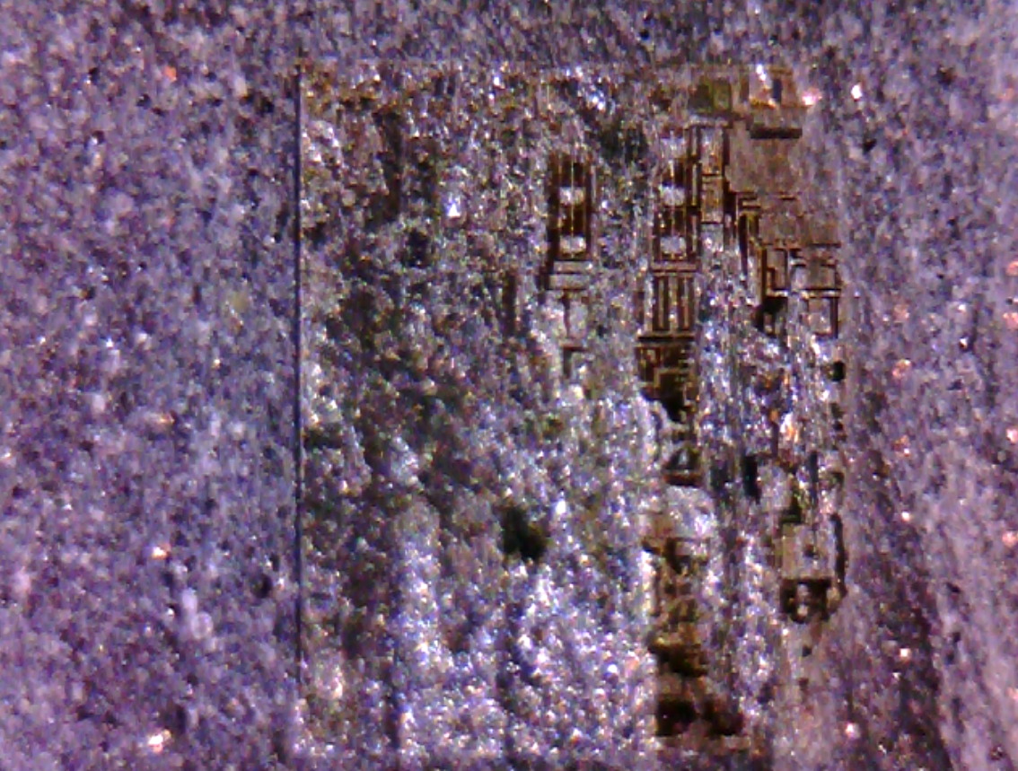

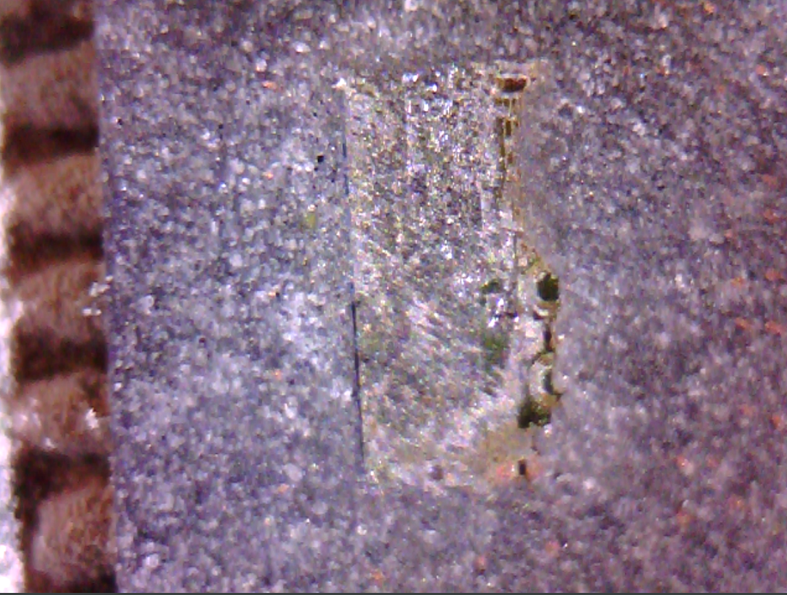

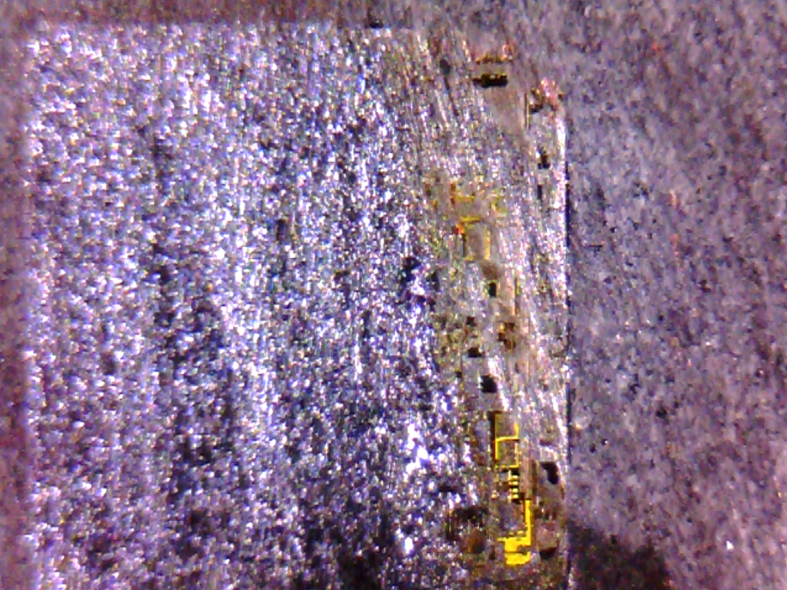

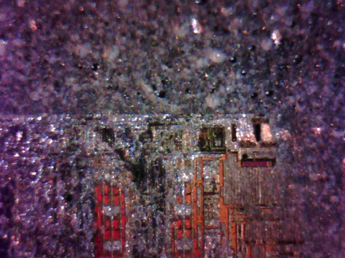

    Today, my colleague and me were checked some modules to find out if they are using counterfeit or genuine NRF24L01+ chips inside.
    We removed the top of the IC and compared the internals with the photos found here:
    https://zeptobars.com/en/read/Nordic-NRF24L01P-SI24R1-real-fake-copy
    In really cheap modules, we found counterfeit IC-s.
    Those modules are similar like the following one (however, they work surprisingly well, but they are counterfeit):
    https://www.aliexpress.com/item/Free-Shipping-Power-enhanced-version-SMD-NRF24L01-Wireless-Module-Mini-module-wireless-data-transmission-module/1885195107.html
    Edit - I have tested these modules (so they are counterfeit):
    https://www.aliexpress.com/item/10-pcs-Free-Shipping-2-4GHz-NRF24l01-Wireless-Module-Mini-Version/32297159921.html
    We also checked the modules bought here:
    https://www.aliexpress.com/item/2PCS-RF2401F20-FCC-Approval-nRF24L01-Chip-Module-RF2401F20-with-126-Channels-20dBm/32520822647.html
    It is an official store of Nicerf, the module can be found at their website here: http://nicerf.com/product_147_88.html
    In RF24L01F20, we found authentic NRF24L01+ IC inside.
    We also found original IC in these modules:
    https://www.aliexpress.com/item/2-pcs-L24L01-D03-1000-Meters-Distance-NRF24L01-PA-LNA-Wireless-Module-Original-NRF24L01P-with-Antenna/32335491233.html
    RF2401F20 module is better as it also has CE / IC / FCC certifications, so it is a much complete solution.
    These photos are not really good and the process was way too destructive, but we were able to clearly identify that RF24L01F20 and L24L01-D03 modules are built with genuine Nordic NRF24L01+ IC.
    Also, these modules produced the best performance of those I have tried. Good to know they both use original chips inside.
    I hope this experiment also helps others as well.
    Edit:
    Here is a photo of RF24L01F20 without metal cap:
    Here is the same module with three genuine ICs on the left which have been purchased from Mouser:
    This is a photo of the IC in L24L01-D03 module without metal cap:
    Above ICs are all genuine.
    Counterfeit ICs had also a bit different printout - for example, the top left square sign was circle on them and text alignment usually was not perfect, but it may not be a good way to identify if they are genuine or counterfeit.
    I hope this may be a good starting point for others who also looking for original products.
