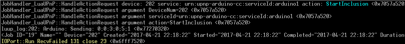

    After moving all my devices from my Vera light UI5 to a Vera Plus with UI7 today I flashed my controller that was working fine on ui5 with the latest mysensors software 2.1.
    I created a MySensor plugin device but seem to be unable to enter inclusion mode. A simple light level node is not included.
    Could you please advise me as to how I could get this going again?
    This is in the log
    ![0_1492806723766_upload-ef244203-7a28-411a-8d39-fb7e4892dea8](/assets/uploads/files/1492806697033-upload-ef244203-7a28-411a-8d39-fb7e4892dea8-resized.png) Insert Code Here
    ```JobHandler_LuaUPnP::HandleActionRequest device: 202 service: urn:upnp-arduino-cc:serviceId:arduino1 action: StartInclusion <0x7057a520>
    JobHandler_LuaUPnP::HandleActionRequest argument DeviceNum=202 <0x7057a520>
    JobHandler_LuaUPnP::HandleActionRequest argument serviceId=urn:upnp-arduino-cc:serviceId:arduino1 <0x7057a520>
    JobHandler_LuaUPnP::HandleActionRequest argument action=StartInclusion <0x7057a520>
    luup_log:202: Arduino: Sending: 0;0;3;0;5;1 <0x77270320>
    <Job ID="19" Name="" Device="202" Created="2017-04-21 22:18:22" Started="2017-04-21 22:18:22" Completed="2017-04-21 22:18:22" Duration="0.1657000" Runtime="0.1329000" Status="Successful" LastNote=""/> <0x77270320>
    IOPort::Run RecvFailed 131 close 23 <0x6fff7520>

                        As you confirmed you had your gw / sensors running on 2.x I gave it another try and started from scratch, and wiped the eeproms on both my gw and node.
                        New Install of Arduino IDE, new MySensors Library install. I used the ethernet gw sketch example and a temperature sensor node sketch.
                        This time it worked, I was able to finally include the sensor, what I can tell from the debug output communication seems to be working flawless.
                        Even when cutting power from gw or sensor and powering up again communication is recovering.
                        Now I will work on adapting my old sensor node sketch on lib 1.4 to new 2.1 requirements.
