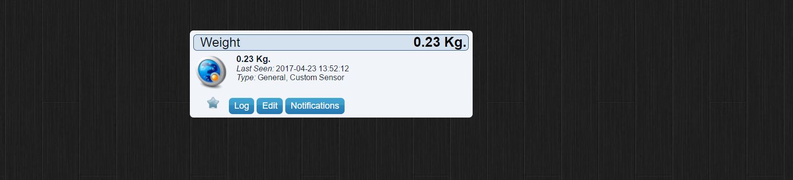

    I have been working on creating a Weighing scale using a 5 Kg Load Cell and HX711 Amp connected to a MySensor node. I plan to have a dynamic weighing scale for reporting weight of anything kept on the Load cell sensor (Aluminium Bar form factor load cell) . Ideal use case can be a Weight scale node kept in a refrigerator measuring the weight of a Milk bottle. The system will send out notification in case the milk bottle starts running low, which can be a trigger to go shop for groceries when your away from home.
    Initial code for calibration of Load cell was taken from this website and then factored into My Sensor code. I have since been able to make a working node in MySensor and able to display weight data in Domoticz. I would like to further refine the code and make it more practical.
    Source webiste: [http://circuits4you.com/2016/11/25/hx711-arduino-load-cell/](link url)
    I am beginner in MySensor and C/C++ coding so thought it would be best if the My Sensor community can help me out in below objectives:
    1. Ideally, I would want the sensor to be battery powered so I have ensured that I run a barebones Atmega 328p on 8 Mhz internal clock. Is it possible that
      the sensor node is always in deep sleep consuming min battery power and only wake up if only requested from the Controller (in my case Domoticz). This way
      the sensor will only report weight data when asked for and result in minimal battery usage and user can "Query" the node for the weight. Not sure if this will use
      an Interrupt function. The readings from the Load Cell sampled every 3 seconds in my code below vary by a very small amount say by .001 gms.
    2. Send a keep alive message say every 1 hour and update controller on the Weight.
    Any help suggestions are welcome and really appreciate the MySensors Team and Community for being awwsum every time!
    Thanks....

    Reading: 0.000 kg Weight Read by sensor: -0.000
    TSP:MSG:SEND 10-10-0-0 s=1,c=1,t=37,pt=7,l=5,sg=0,ft=0,st=ok:-0.000
    Reading: 0.001 kg Weight Read by sensor: 0.002
    TSP:MSG:SEND 10-10-0-0 s=1,c=1,t=37,pt=7,l=5,sg=0,ft=0,st=ok:0.002
    Reading: 0.229 kg Weight Read by sensor: 0.229
    TSP:MSG:SEND 10-10-0-0 s=1,c=1,t=37,pt=7,l=5,sg=0,ft=0,st=ok:0.229
    Reading: 0.229 kg Weight Read by sensor: 0.228
    TSP:MSG:SEND 10-10-0-0 s=1,c=1,t=37,pt=7,l=5,sg=0,ft=0,st=ok:0.228
    Reading: 0.228 kg Weight Read by sensor: 0.227
    TSP:MSG:SEND 10-10-0-0 s=1,c=1,t=37,pt=7,l=5,sg=0,ft=0,st=ok:0.227
    Reading: 0.227 kg Weight Read by sensor: 0.228
    Reading: 0.229 kg Weight Read by sensor: 0.227
