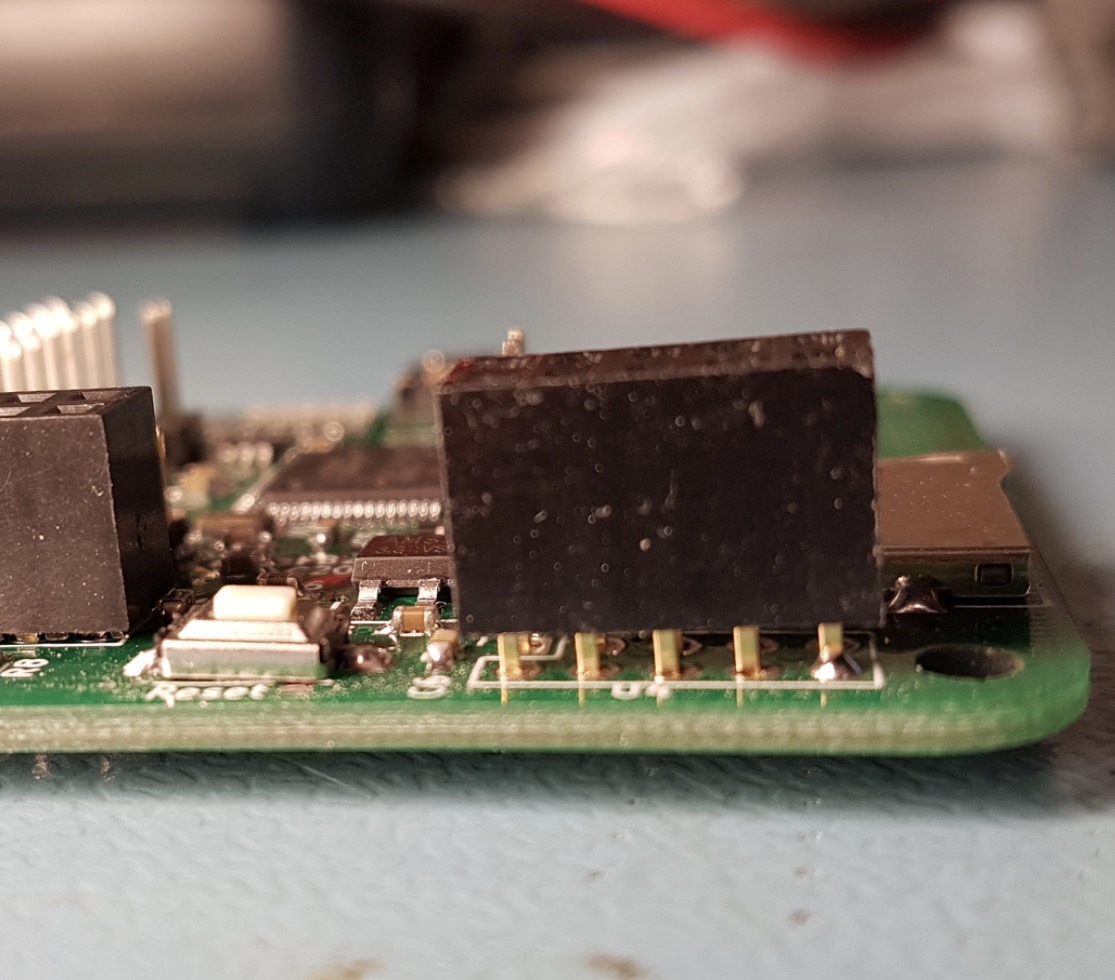

    Hi all,
    I have the Sensebender Gateway working fine with the default serial sketch.
    However, as soon as I load, the W5100 ethernet default sketch, I cannot get it to work. There are no messages in the terminal. The only way to force messages in the terminal is to take out the nrf24l01+ , connect the GW to the computer and insert the nrf24l01+ into the socket while running the terminal. I have the following message:
    0;255;3;0;9;TSM:FAIL:RE-INIT
    0;255;3;0;9;TSM:INIT
    0;255;3;0;9;!TSM:INIT:TSP FAIL
    0;255;3;0;9;TSM:FAIL:CNT=2
    0;255;3;0;9;TSM:FAIL:PDT
    0;255;3;0;9;TSM:INIT:TSP OK
    0;255;3;0;9;TSM:INIT:GW MODE
    0;255;3;0;9;TSM:READY:ID=0,PAR=0,DIS=0
    0;255;3;0;9;MCO:REG:NOT NEEDED
    IP: 0.0.0.0
    0;255;3;0;9;MCO:BGN:STP
    0;255;3;0;9;MCO:BGN:INIT OK,TSP=1
    This is very strange as I set IP to 10.1.1.120.
    When I connect the ethernet cable, I can ping 10.1.1.120, but the GW does not work
    Can anyone help please?
      Sorry if I ask, but what pins did you use to connect the W5100 and the nrf24 radio?

        alexsh1A Offline
        alexsh1A Offline
        alexsh1
        @gohan
        There is only one 10 pins socket - this is for W5100

          Hi I have exactly the same problem but now using the latest IDE environment and MySensors build. Did you manage to find out what was causing the issue? In my set-up seems like the ethernet module is not communication with the rest of the hardware.
          Fixed. The IDE was using the incorrect Ethernet library after a clean install of the Arduino IDE.
