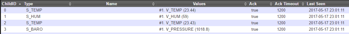

    The sensors are showing correctly in the children table with correct data too (I made the loop to send data on every cycle, so I'm pretty sure that sensor data are there)

        I see data updating in children's window. I guess data is coming in. I also pushed button to accept new devices for 5 minutes
          wrote on last edited by gohan

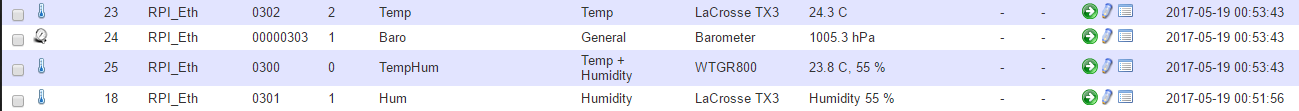

          This is how today (the other day they were not like this) they are seen in Domoticz... I don't know if I am happy to see that Domoticz is smart to consider them as a weather station or on the contrary I'd like it more stupid and let me decide. I know it is a test and not a real life use, but I just wanted to compare the 2 temp sensors on same graph to see if there is a trend in the different temperature measured by them being on the same breadboard.
          0_1495054858134_upload-797b1b9c-c54c-4ff5-94f3-43ece3684073
          0_1495054921204_upload-d3b40442-e739-4f9a-93b6-89aa40381839
          PS anybody knows why values are rounded to only one decimal even they are read with 2 decimals?

                    @gohan yes it confuses me too. I have a similar situation where my node with 2 sensors is recognized by Domoticz as 3 devices like: Temp, Hum, Temp+Hum.
                    Apparently Domoticz is able to recognize that the different sensors belong together, but sometimes, there is a disturbance or bad reception in one sensor message, and then Domoticz creates a new device for it.
                    That would not be such a problem, except that you do not know which device to show on the Domoticz dashboard. Personally, I choose the combined one, ignore the others, and live with it.
                    I do not know if this is a bug for the Domoticz people, maybe they can resolve this?
                    Regards, Michiel
                      I am fine if they get combined but still let me choose individual one: in my first screenshot you can see the sensors are all combined but no individual ones. I think also that playing with child ids could play a role in this.
