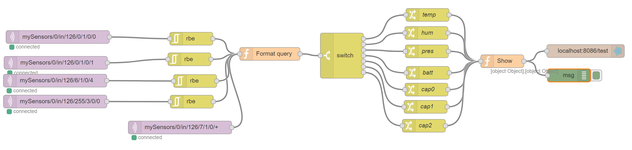

    Hey guys,
    I am running several sensors (mysensors) and would like to push them into an influxDB instance in order to visualize it with Grafana.
    Influxdb and Grafana are already running on my Pi3 but I'm not sure what is the most elegant and easy way to push the data into the database.
    Any hint is appreciated. :-)

      @MaKin I'm running an MQTT gateway and use Node-Red to glue things together:
      0_1495733276194_upload-44c705c1-bdd5-462f-9746-2c5fa8995e03
      Node-Red subscribes to some relevant MQTT topics. As data comes in it can be formatted or whatever is required; the RBE blocks make sure only changes in values are recorded.
      Then a query is created and depending on the MQTT topic the measurement is set and stored in an InfluxDB database.
      This is just one way to organize stuff, but I find it very flexible and powerful!
      If you like, I can post the 'code' behind the flow in the picture above, which can directly be imported in Node-Red.

          @MaKin Here you go:
          [{"id":"da963db0.0867b","type":"debug","z":"2f969f93.19b74","name":"","active":true,"console":"false","complete":"true","x":1329.2905349731445,"y":185.33306121826172,"wires":[]},{"id":"b83858ac.4ac2e8","type":"influxdb out","z":"2f969f93.19b74","influxdb":"3f3f1a0f.6ffe36","name":"","measurement":"","x":1367.6238708496094,"y":128.66622734069824,"wires":[]},{"id":"1ed7a7f.80dd758","type":"switch","z":"2f969f93.19b74","name":"","property":"topic","propertyType":"msg","rules":[{"t":"regex","v":"/0/1/0/0$","vt":"str","case":false},{"t":"regex","v":"0/1/0/1$","vt":"str","case":false},{"t":"regex","v":"6/1/0/4$","vt":"str","case":false},{"t":"regex","v":"/255/3/0/0$","vt":"str","case":false},{"t":"regex","v":"/7/1/0/24$","vt":"str","case":false},{"t":"regex","v":"/7/1/0/25$","vt":"str","case":false},{"t":"regex","v":"/7/1/0/26$","vt":"str","case":false}],"checkall":"true","outputs":7,"x":802.123908996582,"y":139.33292198181152,"wires":[["801cd988.7e82d8"],["c28e857e.6d6ed8"],["8354a90c.dcd808"],["60a92141.810fb"],["9b06911c.0fa8c"],["9dd58b0.4d51178"],["3c4b9e9c.e42232"]]},{"id":"801cd988.7e82d8","type":"change","z":"2f969f93.19b74","name":"temp","rules":[{"t":"set","p":"measurement","pt":"msg","to":"temp","tot":"str"}],"action":"","property":"","from":"","to":"","reg":false,"x":1000.7904052734375,"y":44.666215896606445,"wires":[["6c56a47c.b486ec"]]},{"id":"c28e857e.6d6ed8","type":"change","z":"2f969f93.19b74","name":"hum","rules":[{"t":"set","p":"measurement","pt":"msg","to":"hum","tot":"str"}],"action":"","property":"","from":"","to":"","reg":false,"x":998.2904052734375,"y":86.66621589660645,"wires":[["6c56a47c.b486ec"]]},{"id":"60a92141.810fb","type":"change","z":"2f969f93.19b74","name":"batt","rules":[{"t":"set","p":"measurement","pt":"msg","to":"batt","tot":"str"}],"action":"","property":"","from":"","to":"","reg":false,"x":1001.29052734375,"y":179.33305549621582,"wires":[["6c56a47c.b486ec"]]},{"id":"ad56ce03.4ea93","type":"function","z":"2f969f93.19b74","name":"Format query","func":"msg.payload = [\n    [{\n        value: parseFloat(msg.payload),\n    },\n    {\n        location:\"capacitive_rain_gauge\",\n    }],\n];\nreturn msg;","outputs":1,"noerr":0,"x":634.9572448730469,"y":135.33306884765625,"wires":[["1ed7a7f.80dd758"]]},{"id":"62ada75b.f34ab8","type":"mqtt in","z":"2f969f93.19b74","name":"","topic":"mySensors/0/in/126/0/1/0/0","qos":"2","broker":"fb1ad45d.04e528","x":142.6240234375,"y":95.99990844726562,"wires":[["bdf94461.98ebc8"]]},{"id":"f3a6161b.ee8328","type":"mqtt in","z":"2f969f93.19b74","name":"","topic":"mySensors/0/in/126/0/1/0/1","qos":"2","broker":"fb1ad45d.04e528","x":138,"y":156.00001525878906,"wires":[["bf2405b6.04e9c8"]]},{"id":"23239f4b.0508f","type":"mqtt in","z":"2f969f93.19b74","name":"","topic":"mySensors/0/in/126/255/3/0/0","qos":"2","broker":"fb1ad45d.04e528","x":136.68701171875,"y":245.9999542236328,"wires":[["ee4b3125.b6179"]]},{"id":"bdf94461.98ebc8","type":"rbe","z":"2f969f93.19b74","name":"","func":"rbe","gap":"","x":452.6239929199219,"y":99.9998779296875,"wires":[["ad56ce03.4ea93"]]},{"id":"bf2405b6.04e9c8","type":"rbe","z":"2f969f93.19b74","name":"","func":"rbe","gap":"","x":448.2809753417969,"y":147.83416748046875,"wires":[["ad56ce03.4ea93"]]},{"id":"ee4b3125.b6179","type":"rbe","z":"2f969f93.19b74","name":"","func":"rbe","gap":"","x":453.6869812011719,"y":246.33282470703125,"wires":[["ad56ce03.4ea93"]]},{"id":"8354a90c.dcd808","type":"change","z":"2f969f93.19b74","name":"pres","rules":[{"t":"set","p":"measurement","pt":"msg","to":"pres","tot":"str"}],"action":"","property":"","from":"","to":"","reg":false,"x":999.2905426025391,"y":129.33308601379395,"wires":[["6c56a47c.b486ec"]]},{"id":"d658a498.ae0158","type":"mqtt in","z":"2f969f93.19b74","name":"","topic":"mySensors/0/in/126/6/1/0/4","qos":"2","broker":"fb1ad45d.04e528","x":136.48825073242188,"y":197.4251708984375,"wires":[["8aebab69.e1b3f8"]]},{"id":"8aebab69.e1b3f8","type":"rbe","z":"2f969f93.19b74","name":"","func":"rbe","gap":"","x":461.5662536621094,"y":198.40170288085938,"wires":[["ad56ce03.4ea93"]]},{"id":"6b37c9c8.9da608","type":"mqtt in","z":"2f969f93.19b74","name":"","topic":"mySensors/0/in/126/7/1/0/+","qos":"2","broker":"fb1ad45d.04e528","x":426.3333282470703,"y":306.33333587646484,"wires":[["ad56ce03.4ea93"]]},{"id":"9b06911c.0fa8c","type":"change","z":"2f969f93.19b74","name":"cap0","rules":[{"t":"set","p":"measurement","pt":"msg","to":"cap0","tot":"str"}],"action":"","property":"","from":"","to":"","reg":false,"x":998.333366394043,"y":218.33333015441895,"wires":[["6c56a47c.b486ec"]]},{"id":"9dd58b0.4d51178","type":"change","z":"2f969f93.19b74","name":"cap1","rules":[{"t":"set","p":"measurement","pt":"msg","to":"cap1","tot":"str"}],"action":"","property":"","from":"","to":"","reg":false,"x":996.333366394043,"y":258.33335304260254,"wires":[["6c56a47c.b486ec"]]},{"id":"3c4b9e9c.e42232","type":"change","z":"2f969f93.19b74","name":"cap2","rules":[{"t":"set","p":"measurement","pt":"msg","to":"cap2","tot":"str"}],"action":"","property":"","from":"","to":"","reg":false,"x":992.333366394043,"y":302.3333549499512,"wires":[["6c56a47c.b486ec"]]},{"id":"6c56a47c.b486ec","type":"function","z":"2f969f93.19b74","name":"Show","func":"node.status({text:(msg.payload+'')});\nreturn msg;","outputs":1,"noerr":0,"x":1174.3332481384277,"y":152.3333339691162,"wires":[["da963db0.0867b","b83858ac.4ac2e8"]]},{"id":"3f3f1a0f.6ffe36","type":"influxdb","z":"","hostname":"localhost","port":"8086","protocol":"http","database":"test","name":""},{"id":"fb1ad45d.04e528","type":"mqtt-broker","broker":"localhost","port":"1883","clientid":"","usetls":false,"verifyservercert":true,"compatmode":true,"keepalive":15,"cleansession":true,"willQos":"0","birthQos":"0"}]
