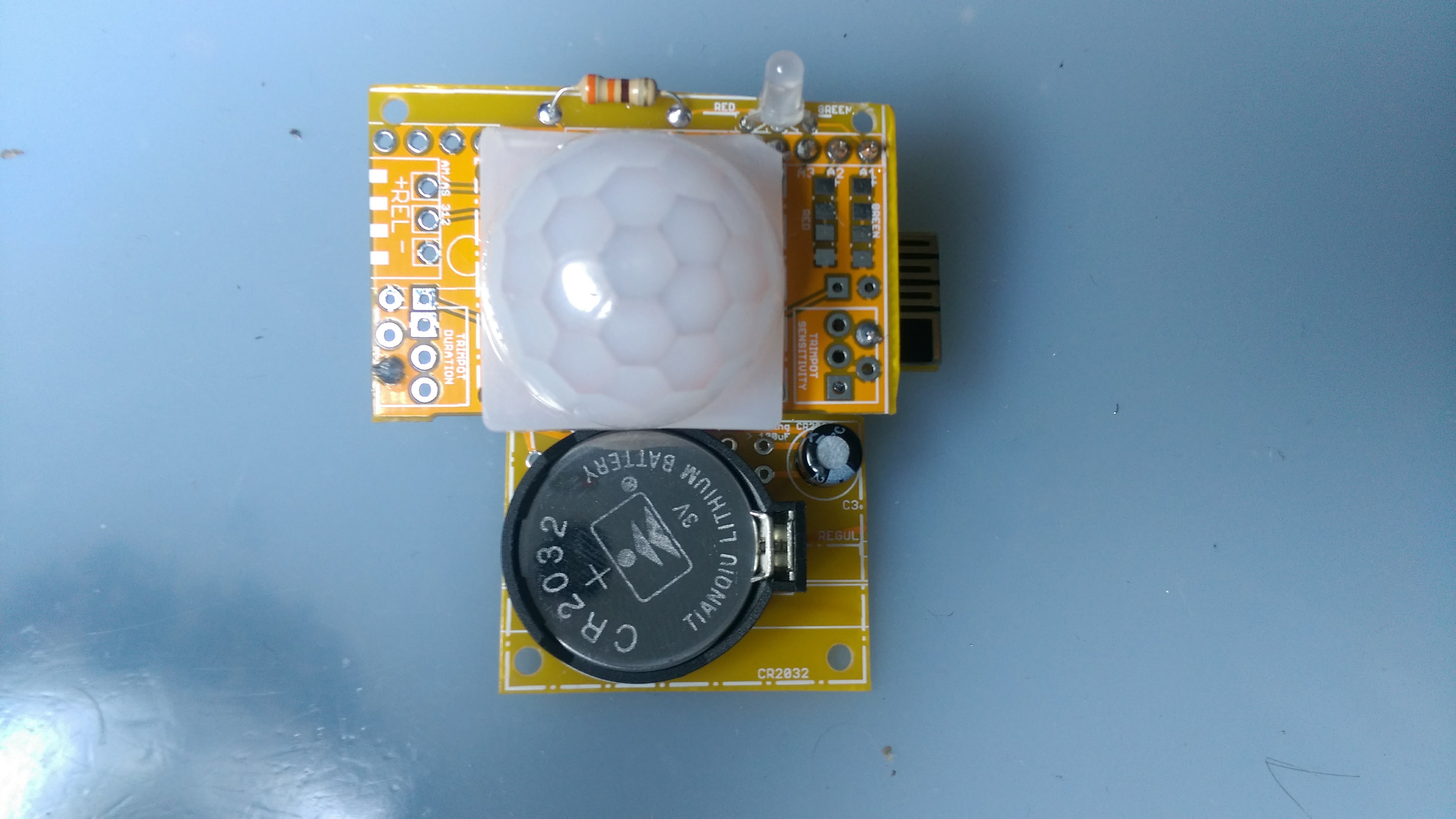

                So I made a test for the basic functionality of this shield (with 2s ontime and max sensitivity) and it works, but as I said in the other thread even with the SR501 lens it seems to have similar problem than the am312: some "blind" areas where it doesn't detect movement.
                @NeverDie you will tell me when you receive the shield if the PIR fits better than on the PCB I made, as I fixed the footprint on the version that I uploaded on OpenHardware.io following discovery of PDF with exact measurements. It was a bit difficult to put in place on mine :)

                  i wouldn't choose a CR2032 with a PIR (regarding lifetime...) but it looks nice :+1:
                  too bad for the PIR sensor, not tried yet, i should receive some soon. not a problem on my side, i can use both analog & digital types on my board. Still curious to test those though

                    @scalz said in 💬 NModule PIR sensor shield:
                    Just wanted to test it and this was the only NModule board that was completely soldered :P
                    It can use 2*AA or CR123 for PIR.
                    And no, not looking so good I have butchered the boards when separating them from the panel :D
