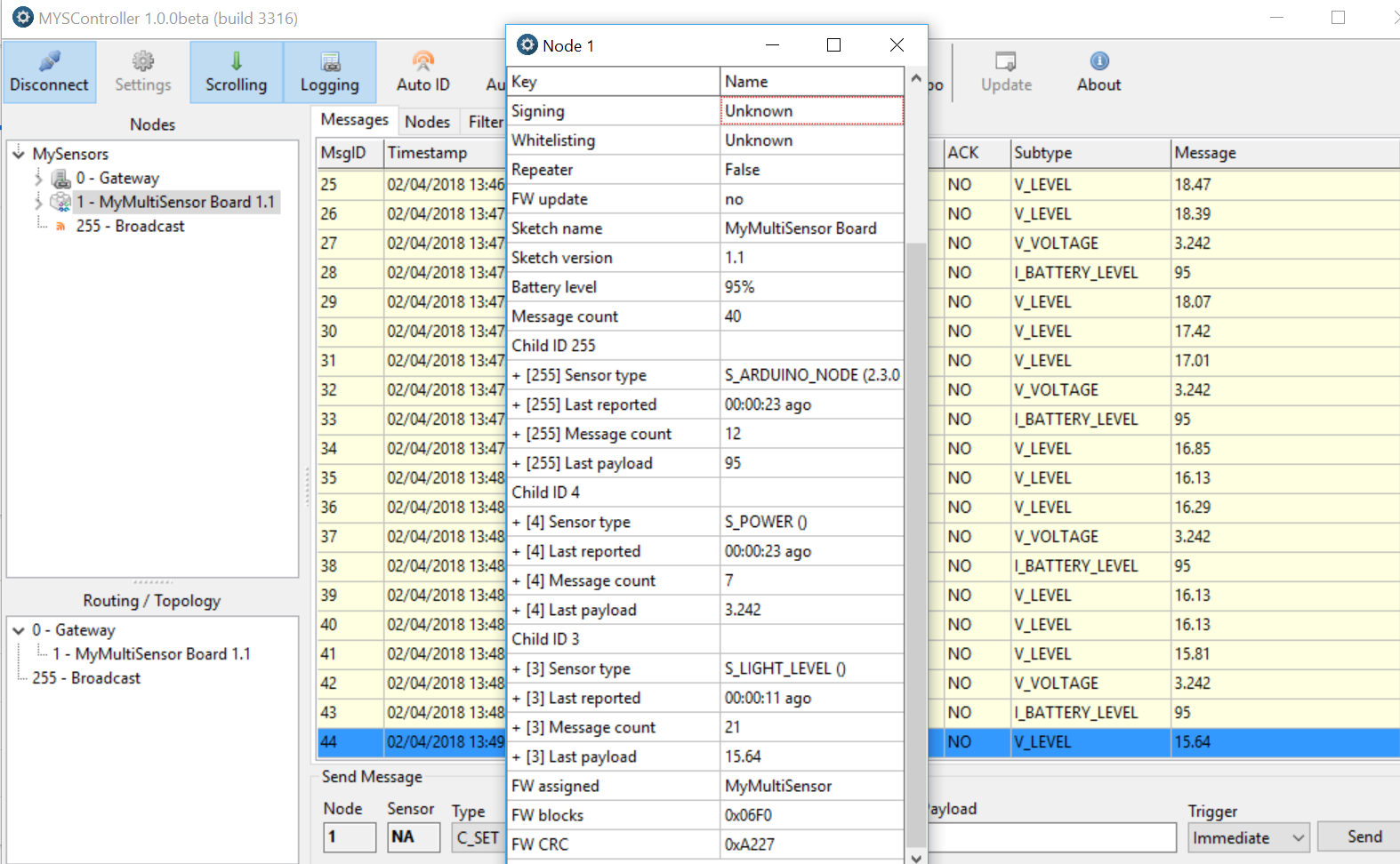

    Hello
    I cannot figure out why my OTA setup is not working.
    I have a node with Sensebender bootloader, a sketch with #define MY_OTA_FIRMWARE_FEATURE. However, when I assign the FW in MYSController nothing happens.
    The node is not sleeping - I put flash.initialize(); in setup and wait (..) in the loop.
    Can anyone assist please?

      @alexsh1 Please post your sketch and a full node log to understand what is going on.

        OK, I simplified sketch as follows and right now something has been going on, but it says "NO UPDATE" in the log:

        This is the log:
        voltage = 3.24
        144547 TSF:MSG:SEND,2-2-0-0,s=1,c=1,t=38,pt=7,l=5,sg=0,ft=0,st=OK:3.242
        145156 TSF:MSG:SEND,2-2-0-0,s=255,c=3,t=0,pt=1,l=1,sg=0,ft=0,st=OK:95

        Flash DeviceID: 1F65
        6981 MCO:BGN:INIT OK,TSP=1
        voltage = 3.24

        33294 TSF:MSG:READ,0-0-2,s=0,c=4,t=1,pt=6,l=8,sg=0:14000100F00627A2
        33300 OTA:FWP:UPDATE
        33583 OTA:FRQ:FW REQ,T=0014,V=0001,B=06EF
        33726
        TSF:MSG:SEND,2-2-0-0,s=255,c=4,t=2,pt=6,l=6,sg=0,ft=0,st=OK:14000100EF06
        33927
        TSF:MSG:READ,0-0-2,s=255,c=4,t=3,pt=6,l=22,sg=0:14000100EF06FFFFFFFFFFFFFFFFFFFFFFFFFFFFFFFF
        33937 OTA:FWP:RECV B=06EF

        35346 !OTA:FWP:WRONG FWB

        44283 !OTA:FRQ:FW UPD FAIL
        44406
        TSF:MSG:READ,0-0-2,s=255,c=4,t=3,pt=6,l=22,sg=0:14000100E9060000FFFFFFFFFFFFFFFFFFFFFFFFFFFF
        44417 !OTA:FWP:NO UPDATE

            @alexsh1 Looks like an RFM69 link issue: a missed ACK from the node after requesting FW block 14000100EB06. Since you are on 2.3.0-alpha it's worthwile testing with 2.2.0 (as we have some ongoing work on the RFMxx drivers). Also, what HW are you using on the gateway?

              @tekka GW is 2.3.0-alpha as well (Sensebender + RFM69W). I am using new rfm69 driver. Shall I try both the GW and the node switching to 2.2.0?

                @alexsh1 Yup :+1:

                  @tekka OK, I cannot setup
                  #define MY_RFM69_NEW_DRIVER
                  under 2.2.0 - the parent cannot be found so I had to go back to the old driver.
                  This is the log from the node (partially cut - too long):

                  Does this mean that the OTA FW update done?

                    17467 TSF:MSG:READ,0-0-2,s=255,c=4,t=3,pt=6,l=22,sg=0:14000100EC06FFFFFFFFFFFFFFFFFFFFFFFFFFFFFFFF
                    17477 OTA:FWP:RECV B=06EC
                    17481 OTA:FRQ:FW REQ,T=0014,V=0001,B=06EB
                    17494 TSF:MSG:SEND,2-2-0-0,s=255,c=4,t=2,pt=6,l=6,sg=0,ft=0,st=OK:14000100EB06
                    17553 TSF:MSG:READ,0-0-2,s=255,c=4,t=3,pt=6,l=22,sg=0:14000100EB06FFFFFFFFFFFFFFFFFFFFFFFFFFFFFFFF
                    17565 OTA:FWP:RECV B=06EB
                    17567 OTA:FRQ:FW REQ,T=0014,V=0001,B=06EA
                    17580 TSF:MSG:SEND,2-2-0-0,s=255,c=4,t=2,pt=6,l=6,sg=0,ft=0,st=OK:14000100EA06
                    17641 TSF:MSG:READ,0-0-2,s=255,c=4,t=3,pt=6,l=22,sg=0:14000100EA06FFFFFFFFFFFFFFFFFFFFFFFFFFFFFFFF
                    17651 OTA:FWP:RECV B=06EA
                    17655 OTA:FRQ:FW REQ,T=0014,V=0001,B=06E9
                    17668 TSF:MSG:SEND,2-2-0-0,s=255,c=4,t=2,pt=6,l=6,sg=0,ft=0,st=OK:14000100E906
                    17731 TSF:MSG:READ,0-0-2,s=255,c=4,t=3,pt=6,l=22,sg=0:14000100E9060000FFFFFFFFFFFFFFFFFFFFFFFFFFFF
                    17741 OTA:FWP:RECV B=06E9
                    17745 OTA:FRQ:FW REQ,T=0014,V=0001,B=06E8
                    17758 TSF:MSG:SEND,2-2-0-0,s=255,c=4,t=2,pt=6,l=6,sg=0,ft=0,st=OK:14000100E806
                    17819 TSF:MSG:READ,0-0-2,s=255,c=4,t=3,pt=6,l=22,sg=0:14000100E80640240D0A006E616E00696E66006F7666
                    17831 OTA:FWP:RECV B=06E8
                    17833 OTA:FRQ:FW REQ,T=0014,V=0001,B=06E7
                    17846 TSF:MSG:SEND,2-2-0-0,s=255,c=4,t=2,pt=6,l=6,sg=0,ft=0,st=OK:14000100E706
                    17909 TSF:MSG:READ,0-0-2,s=255,c=4,t=3,pt=6,l=22,sg=0:14000100E70600000000C224F8256224A02434244E24
                    17920 OTA:FWP:RECV B=06E7
                    17922 OTA:FRQ:FW REQ,T=0014,V=0001,B=06E6
                    17934 TSF:MSG:SEND,2-2-0-0,s=255,c=4,t=2,pt=6,l=6,sg=0,ft=0,st=OK:14000100E606
                    17997 TSF:MSG:READ,0-0-2,s=255,c=4,t=3,pt=6,l=22,sg=0:14000100E6060000781D481D191D471D1C1D241D381D
                    18008 OTA:FWP:RECV B=06E6
                    18012 OTA:FRQ:FW REQ,T=0014,V=0001,B=06E5
                    18024 TSF:MSG:SEND,2-2-0-0,s=255,c=4,t=2,pt=6,l=6,sg=0,ft=0,st=OK:14000100E506
                    18085 TSF:MSG:READ,0-0-2,s=255,c=4,t=3,pt=6,l=22,sg=0:14000100E506656E6442617474657279203D20000000
                    18096 OTA:FWP:RECV B=06E5
                    18100 OTA:FRQ:FW REQ,T=0014,V=0001,B=06E4
                    18112 TSF:MSG:SEND,2-2-0-0,s=255,c=4,t=2,pt=6,l=6,sg=0,ft=0,st=OK:14000100E406
                    18173 TSF:MSG:READ,0-0-2,s=255,c=4,t=3,pt=6,l=22,sg=0:14000100E406616765203D20004F5054333030310073
                    18184 OTA:FWP:RECV B=06E4
                    18188 OTA:FRQ:FW REQ,T=0014,V=0001,B=06E3
                    18200 TSF:MSG:SEND,2-2-0-0,s=255,c=4,t=2,pt=6,l=6,sg=0,ft=0,st=OK:14000100E306
                    voltage = 3.23
                    19464 !TSF:MSG:SEND,2-2-0-0,s=1,c=1,t=38,pt=7,l=5,sg=0,ft=0,st=NACK:3.233
                    19681 TSF:MSG:SEND,2-2-0-0,s=255,c=3,t=0,pt=1,l=1,sg=0,ft=1,st=OK:95
                    19689 OTA:FRQ:FW REQ,T=0014,V=0001,B=06E3
                    19701 TSF:MSG:SEND,2-2-0-0,s=255,c=4,t=2,pt=6,l=6,sg=0,ft=0,st=OK:14000100E306
                    19812 TSF:MSG:READ,0-0-2,s=255,c=4,t=3,pt=6,l=22,sg=0:14000100E306656E736F7220426F61726400766F6C74
                    19822 OTA:FWP:RECV B=06E3
                    19826 OTA:FRQ:FW REQ,T=0014,V=0001,B=06E2
                    19838 TSF:MSG:SEND,2-2-0-0,s=255,c=4,t=2,pt=6,l=6,sg=0,ft=0,st=OK:14000100E206
                    19900 TSF:MSG:READ,0-0-2,s=255,c=4,t=3,pt=6,l=22,sg=0:14000100E20670686100312E31004D794D756C746953
                    19910 OTA:FWP:RECV B=06E2
                    19914 OTA:FRQ:FW REQ,T=0014,V=0001,B=06E1
                    19927 TSF:MSG:SEND,2-2-0-0,s=255,c=4,t=2,pt=6,l=6,sg=0,ft=0,st=OK:14000100E106
                    19988 TSF:MSG:READ,0-0-2,s=255,c=4,t=3,pt=6,l=22,sg=0:14000100E10641434B0021003F00322E332E302D616C
                    19998 OTA:FWP:RECV B=06E1
                    20002 OTA:FRQ:FW REQ,T=0014,V=0001,B=06E0
                    20015 TSF:MSG:SEND,2-2-0-0,s=255,c=4,t=2,pt=6,l=6,sg=0,ft=0,st=OK:14000100E006
                    20076 TSF:MSG:READ,0-0-2,s=255,c=4,t=3,pt=6,l=22,sg=0:14000100E006443A20003C4E4F4E43453E004F4B004E
                    20088 OTA:FWP:RECV B=06E0
                    20090 OTA:FRQ:FW REQ,T=0014,V=0001,B=06DF
                    20103 TSF:MSG:SEND,2-2-0-0,s=255,c=4,t=2,pt=6,l=6,sg=0,ft=0,st=OK:14000100DF06
                    20164 TSF:MSG:READ,0-0-2,s=255,c=4,t=3,pt=6,l=22,sg=0:14000100DF06697400466C6173682044657669636549
                    20176 OTA:FWP:RECV B=06DF
                    20178 OTA:FRQ:FW REQ,T=0014,V=0001,B=06DE
                    20191 TSF:MSG:SEND,2-2-0-0,s=255,c=4,t=2,pt=6,l=6,sg=0,ft=0,st=OK:14000100DE06
                    20254 TSF:MSG:READ,0-0-2,s=255,c=4,t=3,pt=6,l=22,sg=0:14000100DE0667682D4C696D6974004C6F772D4C696D
                    20264 OTA:FWP:RECV B=06DE
                    20269 OTA:FRQ:FW REQ,T=0014,V=0001,B=06DD
                    20281 TSF:MSG:SEND,2-2-0-0,s=255,c=4,t=2,pt=6,l=6,sg=0,ft=0,st=OK:14000100DD06
                    20342 TSF:MSG:READ,0-0-2,s=255,c=4,t=3,pt=6,l=22,sg=0:14000100DD0630303120446576696365204944004869
                    20353 OTA:FWP:RECV B=06DD
                    20357 OTA:FRQ:FW REQ,T=0014,V=0001,B=06DC
                    20369 TSF:MSG:SEND,2-2-0-0,s=255,c=4,t=2,pt=6,l=6,sg=0,ft=0,st=OK:14000100DC06
                    20430 TSF:MSG:READ,0-0-2,s=255,c=4,t=3,pt=6,l=22,sg=0:140001001400000000002C76D888DC674F0823DFC1DF
                    324265 OTA:FWP:RECV B=0014010002000C944F040C944F040C944F040C944F04
                    331968 OTA:FWP:RECV B=0002
                    331970 OTA:FRQ:FW REQ,T=0014,V=0001,B=0001
                    331982 TSF:MSG:SEND,2-2-0-0,s=255,c=4,t=2,pt=6,l=6,sg=0,ft=0,st=OK:140001000100
                    332046 TSF:MSG:READ,0-0-2,s=255,c=4,t=3,pt=6,l=22,sg=0:1400010001000C944F040C944F040C94A6040C944F04
                    332056 OTA:FWP:RECV B=0001
                    332060 OTA:FRQ:FW REQ,T=0014,V=0001,B=0000
                    332072 TSF:MSG:SEND,2-2-0-0,s=255,c=4,t=2,pt=6,l=6,sg=0,ft=0,st=OK:140001000000
                    332136 TSF:MSG:READ,0-0-2,s=255,c=4,t=3,pt=6,l=22,sg=0:1400010000000C9427040C945E220C9485220C944F04
                    332146 OTA:FWP:RECV B=0000
                    332150 OTA:FWP:FW END
                    334950 OTA:CRC:B=06F0,C=A227,F=A227
                    334954 OTA:FWP:CRC OK
                    alexsh1A Offline
                    alexsh1A Offline
                    alexsh1
                    @tekka Now it says "403195 OTA:FWP:UPDATE SKIPPED" when try to update it.
                    EDIT: Despite getting
                    48732 OTA:FWP:RECV B=0000
                    48736 OTA:FWP:FW END
                    48865 OTA:CRC:B=0050,C=46D4,F=46D4
                    48867 OTA:FWP:CRC OK
                    Firmware is not updated
