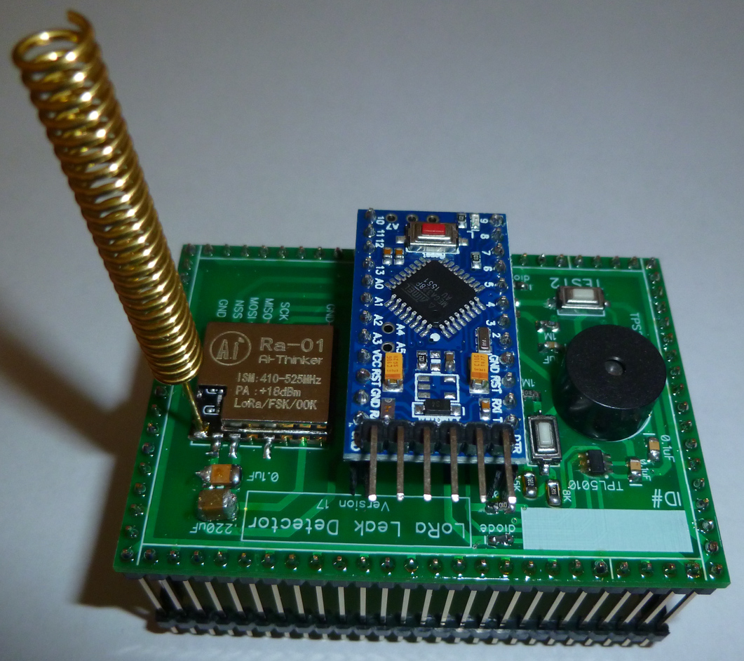

      As a "for instance," a TPL5010 external watchdog consumes just 35na. In https://www.openhardware.io/view/534/Extremely-Simple-Arduino-Pro-Mini-LoRa-Water-Leak-Detector I use it to periodically wake-up a sleeping atmega328p, but it could just as easily be used to turn-on a mosfet or load switch to then turn-on a completely powered down mcu of any type, including an ESP32 or an ESP8266.
      You can see the TPL5010 mounted on it here:
      That was 4 years ago. I haven't re-surveyed the market, but maybe by now there exist watchdogs that consume even less.
