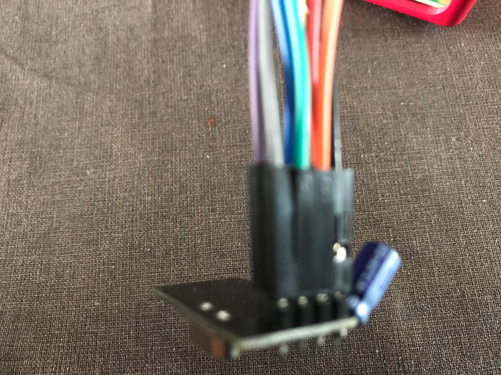

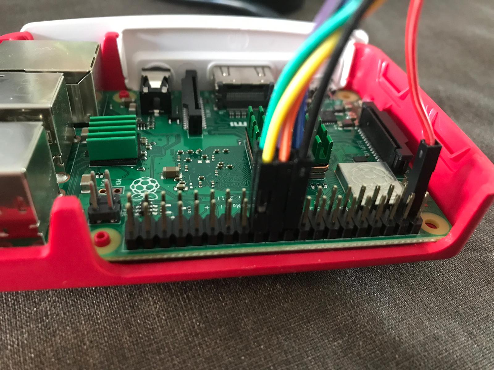

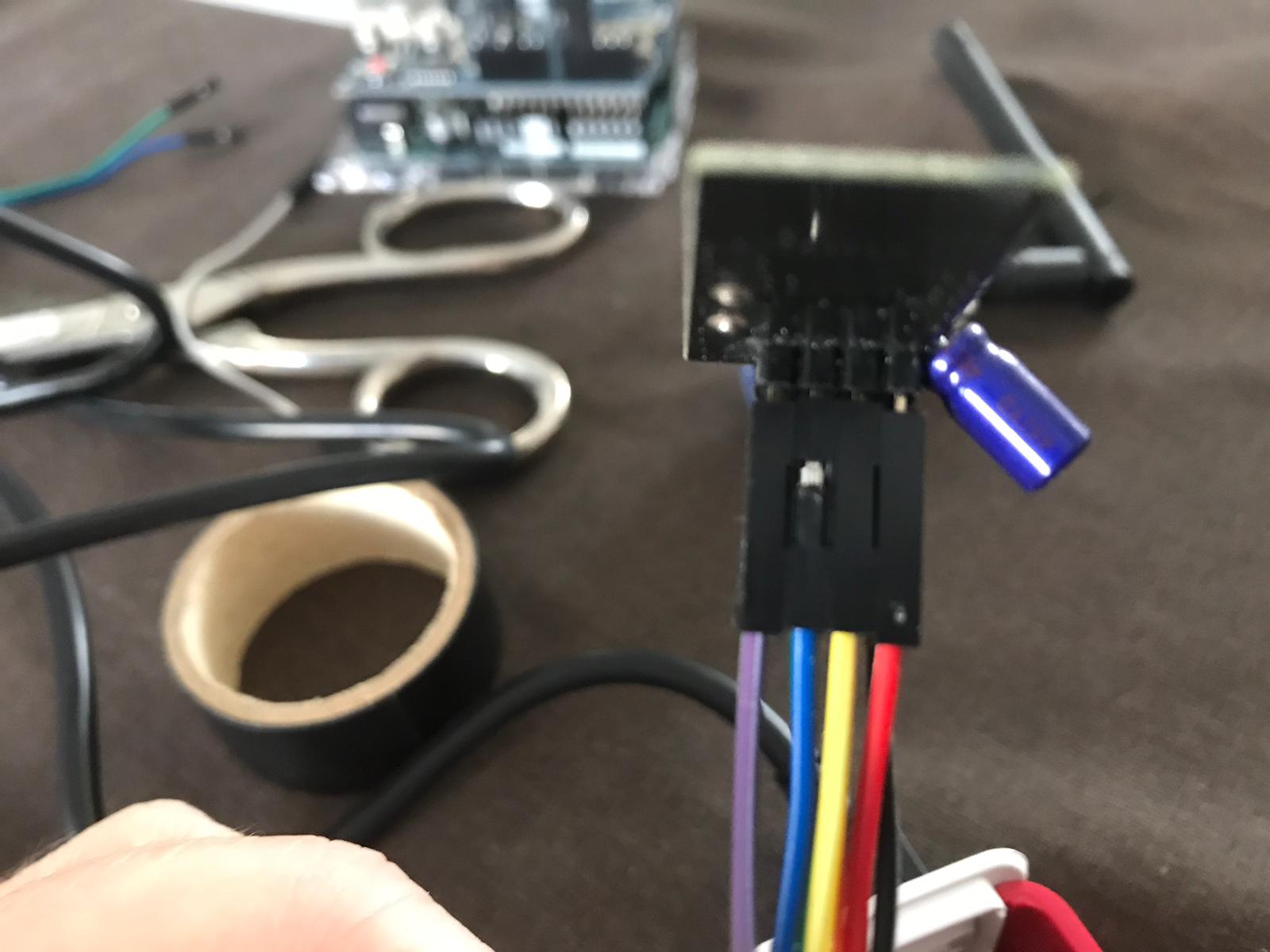

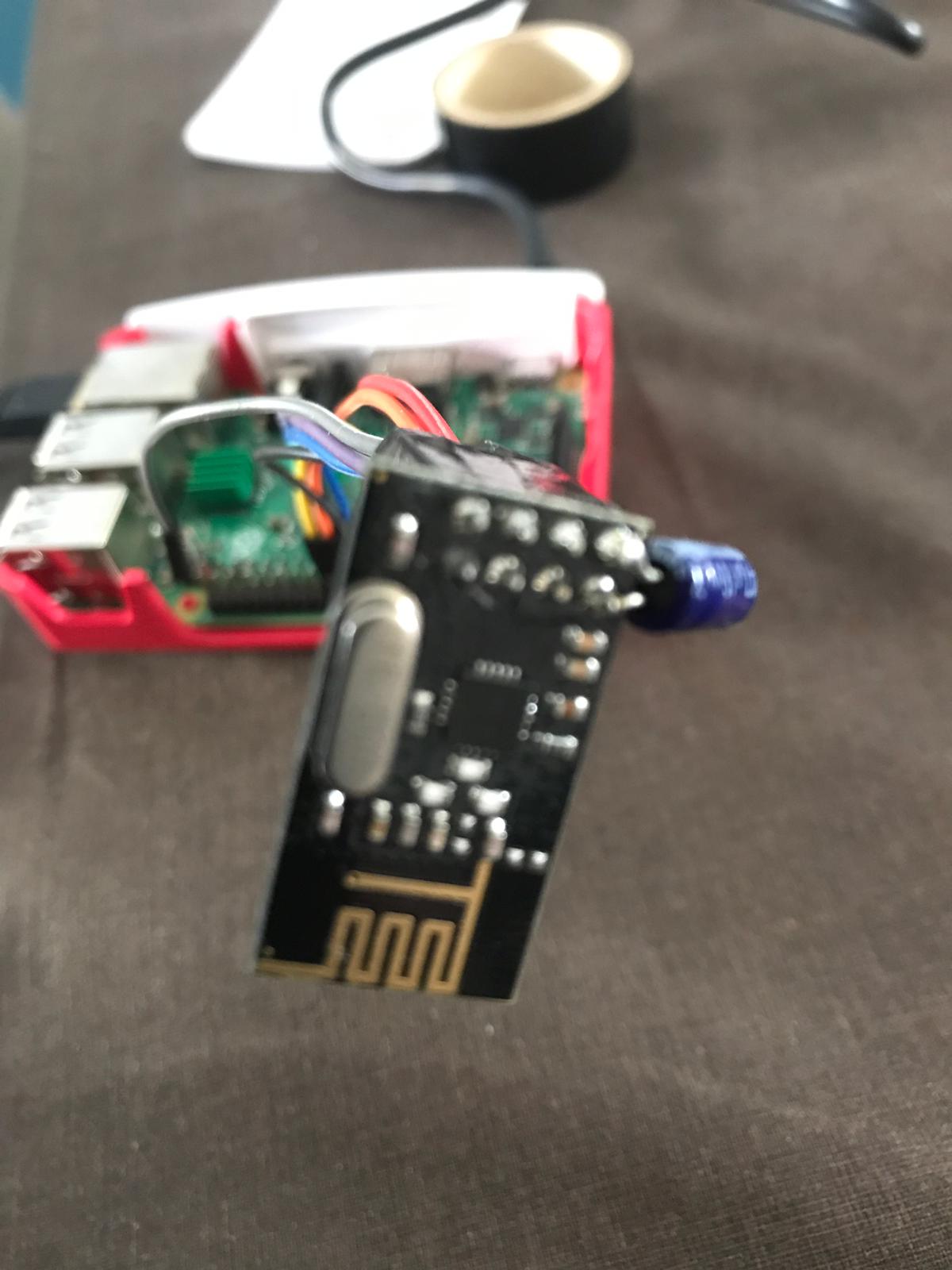

  • M
    martim
    I have build the Raspberry PI 3 b+ gateway project as here https://www.mysensors.org/build/raspberry
    unfortunately the radio won't work. I have checked the wires multiple times but I think I did look to often :)
    I used:
    ./configure --my-transport=nrf24 --my-gateway=ethernet --my-controller-ip-address=192.168.10.5
    then
    make
    sudo ./bin/mysgw

      @martim looks to me that the grey and purple wires have switched positions on the radio?

        martim
        @mfalkvidd thanks!! I have looked three times , i guess too tired. 😃
