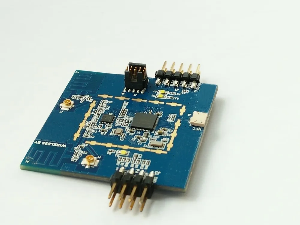

        Just started testing my new NRF52805 breakout board. I added a new generic variant to sandeepmistry/arduino-nRF5, added a new board to mysensors nRF5, now I'm testing compatibility.
        This new NRF52805 chip is interesting. Way stripped down compared to the rest of the NRF5 line. No PWM, no LPCOMP, only 10 GPIO (maybe 8 usable).
        But, it's cheap, ~$2.50 for the EBYTE BT104-BT5005 module, compact, and appropriate for most low-power use cases.
        Interestingly, the chip does not support the current MySensors default, but deprecated, data rate of 250Kbps. Today I also learned that modules can only communicate on the same data rate. So I created a ESP8266 + NRF24L01+ gateway at MY_RF24_DATARATE RF24_1MBPS, and it worked!
        Still need to test a few things:
        • I2C
        • SPI
        • Power consumption
        If all goes well, I'll submit the merge requests and publish this board schematic on openhardware sometime in the next week.

            Update on my NRF52805 Breakout:
            • I2C is now working, just a few small changes to select the right interface
            • Power consumption looks good, around 1.8uA. The Si7021 module is reading 2.5uA in isolation.
            Just need to test SPI and figure out a clever name for the board, and should be good to go.
