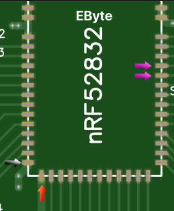

    Carefully soldered some wires to your board, and connected it a programming tool. The cheapest simplest option is to get an ST-Link v2 ($3).
    Connect:
    gnd ->gnd (in the corner)
    3.3v -> vcc (in the same corner)
    SWDIO -> SWDIO
    SWDCLK -> SWDCLK

    First the chip you are using must be 'wiped'. This removes the bluetooth functionality. Wipe the chip by clicking "tools -> burn bootloader". You'll get an error but that's normal.
    Next, when your sketch is complete, choose "sketch -> upload via programmer".

            I am starting to experiment with NRF51822. Thank you all for this thread. I am stuck with setting up IDE on Win10 and my MCU is not communicating. What is the correct setup for Arduino IDE?
            I have Port still grayed out and error: The selected port not exist
            Could that be related to drivers? I've run Zadig, there are more options and I've tried all four of them
            I am not able to upload even erase sketch. Any suggestion where to focus (IDE/Zadig/other)?

                @xmonika have you tried to erase it? In most cases if is start with a new module I first need to erase is once.
                Shortcut => burn bootloader, this will give an error but you should be good to go from there.

                  @omemanti @mfalkvidd Thank you, I think I did it. It works now - or I hope so from the code.
                  ** Programming Finished **
                  ** Verify Started **
                  nrf51.cpu: target state: halted
                  target halted due to breakpoint, current mode: Thread
                  xPSR: 0x61000000 pc: 0x2000002e msp: 0x20004000
                  verified 1412 bytes in 0.038633s (35.692 KiB/s)
                  ** Verified OK **
                  ** Resetting Target **
                  shutdown command invoked
                  What I was confused is that there is erase sketch, but to make it erased there is this trick with burn bootloader. Still the port is greyed out, but it seems I am able to flash blank sketch. Thanks

                                    @ileneken3
                                    After giving up on the cheap (illegal?) ST-LINK and J-LINK boards, I decided to make my life easy and get a NRF-DK. Unfortunately, even that is not easy enough . I did manage to use nRFgo Studio to flash a pre-built .hex file (blinky_pca10040.hex) to the EBYTE E73 module. I know it works because I attached an LED to a pin on the module and I see it blinks. But I can't do what I really want - flash a simple Mysensors sketch (preferably with the Arduino IDE).
                                    Everything compiles OK, I'm using the very latest MyBoardNRF5 board definition (including the Sandeep Mistry libraries). But the Arduino IDE won't recognize the J-LINK programmer that is built into the DK board. (Maybe that's not expected to work?)
                                    As a workaround, from the Arduino IDE, I select "Export compiled Binary", and then use the resultant .hex file with nRFgo Studio to flash the board. Everything seems fine, but I get no indication from the gateway that any wireless traffic is received from the board - so I assume it is not working at all. Below is the sketch.
                                    #define MY_RADIO_NRF5_ESB

                                    P.S.
                                    I have not managed to get any console output using the TX/RX pins to work either.
                                    It would really brighten up my holidays if someone could point me in the right direction!
                                    Thanks,

                                      @ileneken3 1. how did you wire the DK tot the target module?
                                      https://forum.mysensors.org/topic/6961/nrf5-action/1744
                                      1. What is the error the Arduino IDE produces?
                                      2. Can you also post the myboardnrf(sounds like..) files?
                                      FYI, I both use the stlink and nrf52832-DK for programming. And I'm pretty sure the stlink I use is not so original. 2 dollar each.
                                      ileneken3I 1 Reply Last reply

                                        @omemanti
                                        1. I wired the DK to the target exactly as described in the article, and as drawn in the picture:
                                          https://devzone.nordicsemi.com/f/nordic-q-a/20536/programming-external-custom-nrf52832-board-using-nrf52-dk
                                          I am assuming everything is correct in the wiring, because I was able to flash the blinky pre-compiled hex file and it works.
                                        2. When selecting J-Link as the programmer, the error from the Arduino IDE is:
                                        C:\Users\krakman\AppData\Local\Arduino15\packages\sandeepmistry\tools\openocd\0.10.0-dev.nrf5/bin/openocd.exe -d2 -f interface/jlink.cfg -c transport select swd; set WORKAREASIZE 0; -f target/nrf52.cfg -c program {{C:\Users\krakman\AppData\Local\Temp\arduino_build_268238/MyBoardNRF5tst.ino.hex}} verify reset; shutdown;
