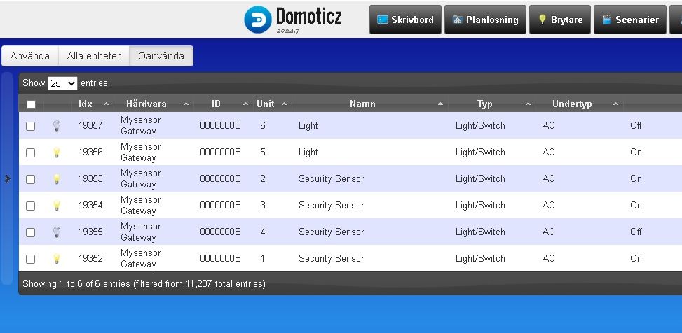

    I want change state for the LEDS but they both lights when i Press on in Domoticz.
    How to solve the last stage with if (message.type == V_STATUS) // Change relay state
    If command A = Led 1 lights or command B = Led 2 Lights.
    Best regards!

      @Knightan
      I believe that your problem may be related to this block of code. See my thoughts as comments....
       if (message.type == V_STATUS) {  //This is true for all messages received
          state_1 = message.getBool(); //This sets state for state_1 to the received value.
          digitalWrite(LED_PIN_Channel_1, state_1?RELAY_1_ON:RELAY_1_OFF);
          // Store state in eeprom
          saveState(CHILD_ID_5, state_1);
           // Write some debug info
           Serial.print("Incoming change for sensor: STATE 1");
           Serial.print(message.sensor);
          state_2 = message.getBool();  //This sets state for state_2 to the received value.
          digitalWrite(LED_PIN_Channel_2, state_2?RELAY_2_ON:RELAY_2_OFF);
          saveState(CHILD_ID_6, state_2);
           Serial.print("Incoming change for sensor: STATE 2");
      It seems to me that state_1 = message.getBool(); AND state_2 = message.getBool(). So they both get set to the incoming value.
      I think you need to not set both to the same value and instead differentiate them to unique values. I could be wrong as I have not had chance to do anything related to mysensors for a long time now - I also don't use Domoticz.
      Have a look at the code on this page, it might help you a lot.... https://www.mysensors.org/build/relay

        You don't check for which sensor the message is send - message.getSensor() - and in both cases you set the relays both on Like Skywatch said.
        So you could do something like:
        if ( message.type == V_STATUS ) { // check if GW send a status change
             if ( message.getSensor() == sensor 1 ) {
                  // handles sensor 1
             else if ( message.getSensor() == sensor 2 ) {
                  // handles sensor 1
            etc
