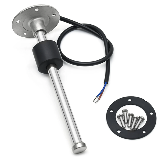

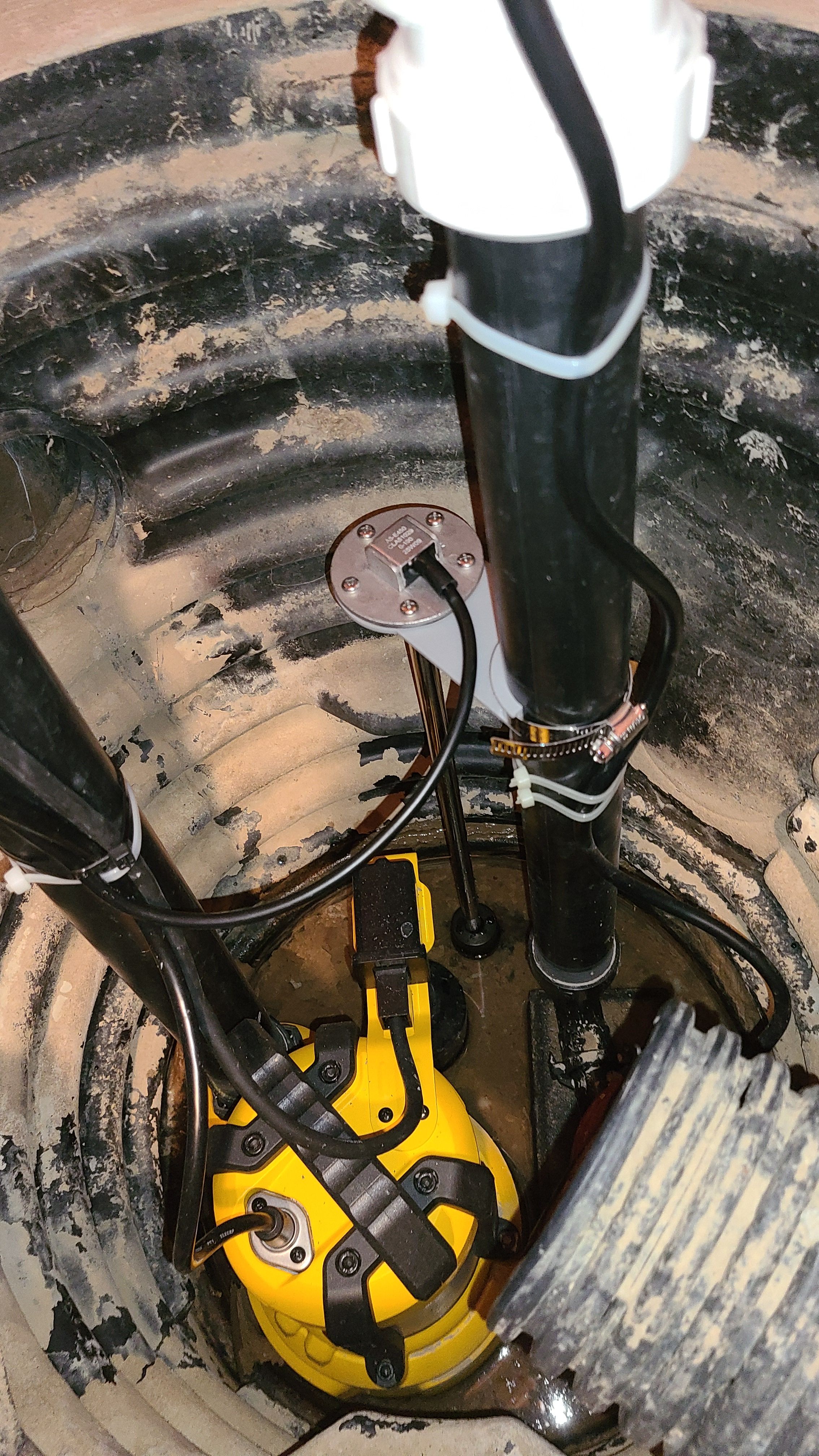

    I recently replaced my sump pit pump and installed a battery backup pump at the same time. Naturally, when I saw all the alarms available on the backup system, I wanted to integrate them into my home automation system. I also wanted to add a water level sensor to get a better idea of how often the pump ran and also create a water level alarm.
    Water level sensor installed.

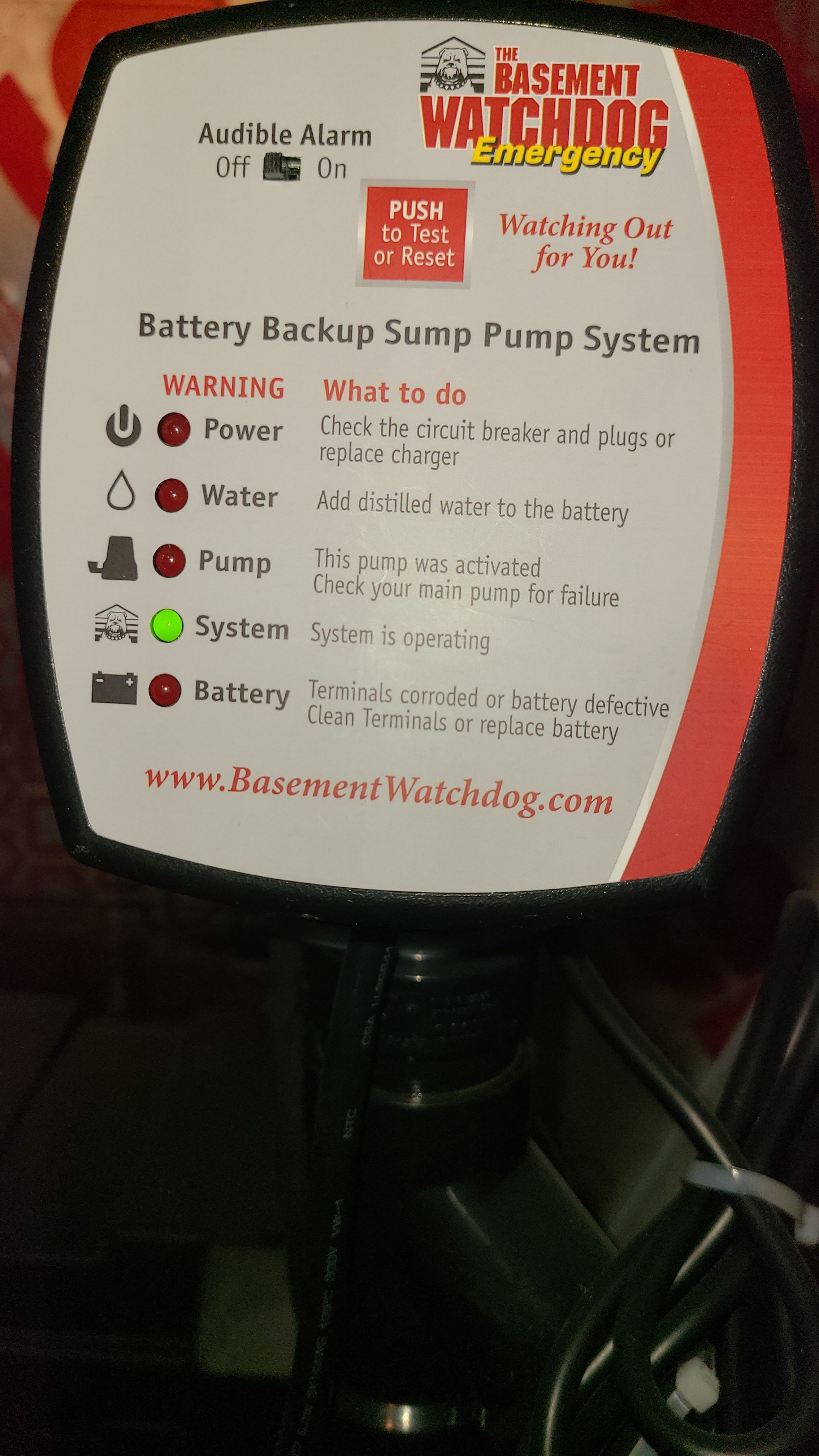

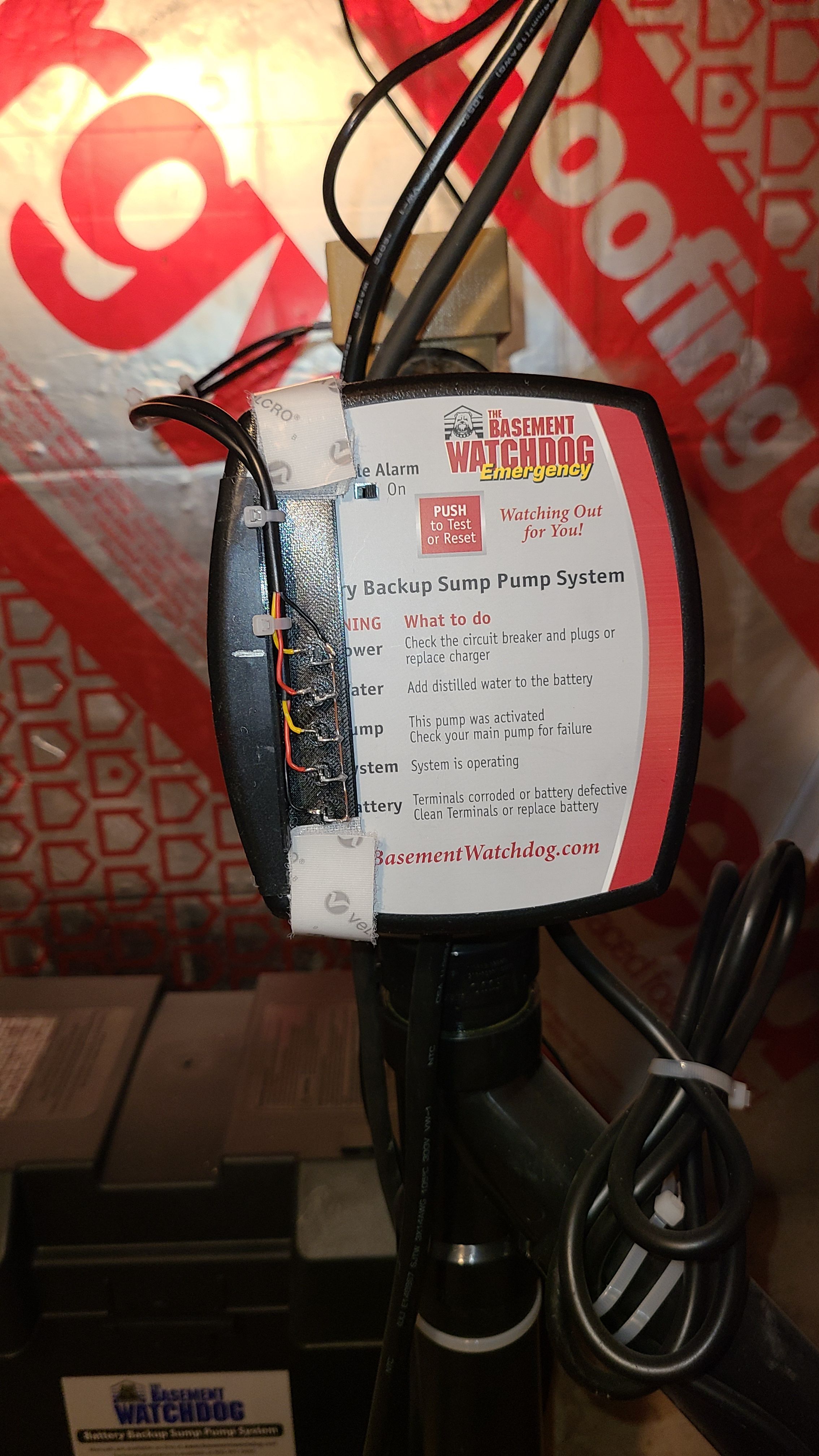

    I looked at the backup controller and realised it would be difficult to pull signals from it since it isn't easy to disassemble. So, I opted to used photo transistors to read the state of the alarm LEDs.
    The photo transistors are held in place with velcro strips for easy removal.

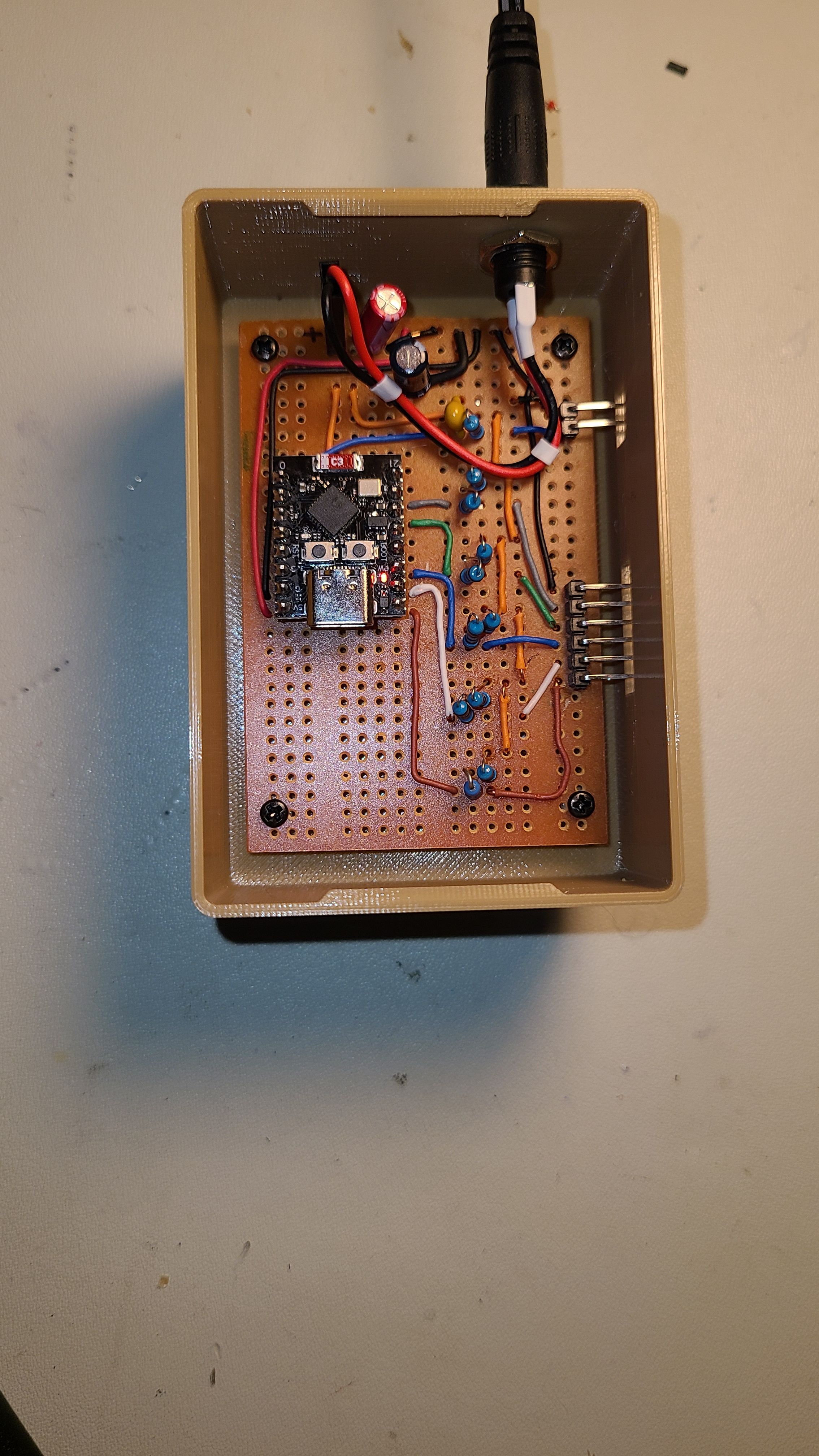

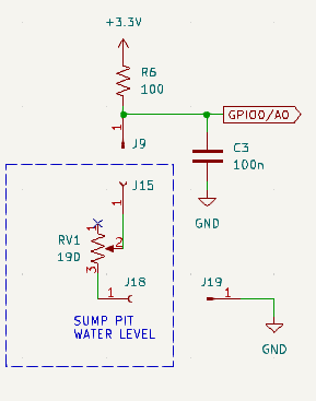

    My monitoring node consists of an ESP32C3 Super Mini ucontroller configured with 5 digital input channels and 1 analog channel to read the alarm LEDs and water level. I'm using MQTT, for this project, to send the data to Home Assistant.

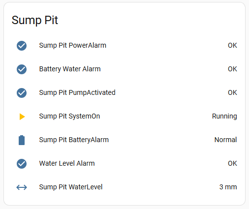

    Integrated into Home Assistant
    Overall, after a few adjustments, the systems works really well and provides some peace of mind.

      @KevinT That is a great project. How do you measure the water level?

        I have exactly the same level sensor but not the controller. The level sensor output is essentially a variable resistor. When the float is at the top, the resistance is minimum, at the bottom, maximum. I have the 0-190 ohm sensor.
        My "reader" is an ESP-12F (ESP8266). Put a 470 ohm resistor from 3.3V to the Analog input and one of the leads of the sensor and the other lead to ground. The program is Tasmota configured for analog input

          @TheoL Thanks. As @OldSurferDude says, it's an analog sensor I got off AliExpress Fuel level sensor. I chose a 0-190 ohm sensor, 450 mm long. I wired a 100 ohm resistor in series with the sensor and read the voltage with an analog channel. I do a little extra math to linearise the measurement.

              @TheoL that would probably be a hall effect sensor that draws in the microamp range. Per @KevinT 's circuit, it would draw 33mA full and 11.3mA empty, somewhere in between depending on the depth. MySensors and a controller like Home Assistant (with the MySensors Integration) can monitor the battery level as well as the level of the sensor.
