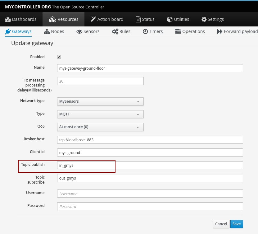

                                  @FotoFieber MyController is getting the MQTT msg, but doesn't like it's format, i've had continuous error msg like below:
                                  2017-02-16 18:17:34,657 ERROR [Thread-4] [org.mycontroller.standalone.provider.mysensors.MySensorsProviderBridge:60] Unable to process this rawMessage:RawMessage(gatewayId=2, data=2;0;1;0;23;36, subData=mysensors/1/out/, isTxMessage=false, networkType=MY_SENSORS)
                                  org.mycontroller.standalone.message.RawMessageException: Unknown message format, Topic:mysensors/1/out/, PayLoad:2;0;1;0;23;36
                                  at org.mycontroller.standalone.provider.mysensors.MySensorsRawMessage.updateMQTTMessage(MySensorsRawMessage.java:114) ~[mycontroller-dist-standalone-0.0.3.Alpha2-single.jar:0.0.3.Alpha2]
                                  MyController is set up with the correct topic, as seen in above Topic:/mysensors/1/out/ (i've also tried without the ending /).

                                      @Frank-C Current approach of MyController on MQTT see only payload on message. Other data(nodeId, sensorIds, etc) from topic. Kindly create a request on MyController issue page. I will address this. If we address this I am not going to create separate service to parse serial-to-real-mqtt service type.
                                      F 1 Reply Last reply
