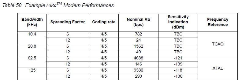

          @mihai.aldea it actually seems like the fastest LoRa mode supports 9380 bps. I found this in the datasheet:
          The datasheet also says this
          So by using the "special use case" of SF6, it should be possible to get close to your selected transfer speed, at the cost of losing 15dB of sensitivity (compared to SF12).
          If I understand correctly, this is what RFM95_BW31_25CR48SF512 does?
          If that's the case, what is left to configure? Or does MySensors not support using RFM95_BW31_25CR48SF512 ?

              @mihai.aldea yes that is a LoRa mode.
