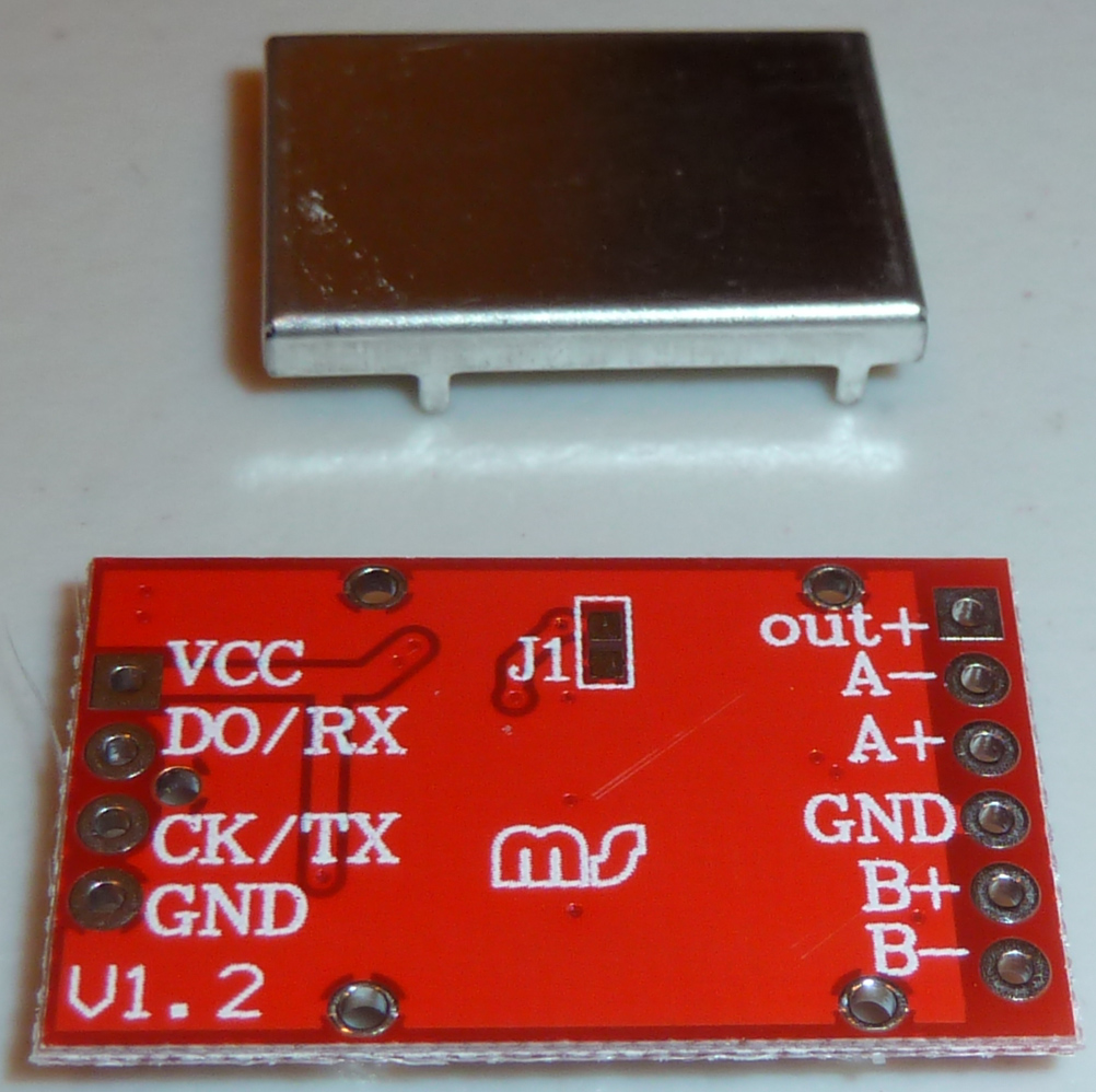

                            Thanks! It looks a bit complicated to me. I've used one of these breakout boards (https://www.amazon.com/gp/product/B00OPVBEQO/ref=oh_aui_search_detailpage?ie=UTF8&psc=1) as a way to measure 24-bit voltage on capacitors, and it works really well. As you can perhaps tell from the photo:
                            the chip is fairly simple to use. What I especially liked is that there was already a demo arduino sketch for interfacing with it. That was a real time saver. If I were to build something, I might try that first, if only because it seems like it might be easier (though perhaps, in part, because I'm already comfortable with it). Would using it in conjunction with a sense resistor be all it would take to make an accurate, high resolution current sensor?

                                  It sounds like I was mistaken then. In my quick read I thought that I had to implement the entire schematic, not just add a couple of resistors to a pre-made breakout board. I suppose if the schematic were more of a block diagram, that might be clearer for other future readers to quickly grasp, or maybe it's just me.
                                  Why would the ADS1220 be a better ADC? I really haven't looked into doing a comparison. I bought the breakout board that I pictured above from Amazon , but I see that it's out of stock now. I believe the company which made it is in India. I seem to recall that it's open source, so there's always that I suppose. I didn't mind ringing the till for the maker: it was all pre-made, it did what I needed at the time (which was watching in real-time the voltage leakage from supercapacitors that I was testing), it was available with free Amazon Prime delivery, and I wanted something sooner rather than later. So, it fit what I needed at the time. Most of those reasons relate to rapid availability though rather than technical reasons.

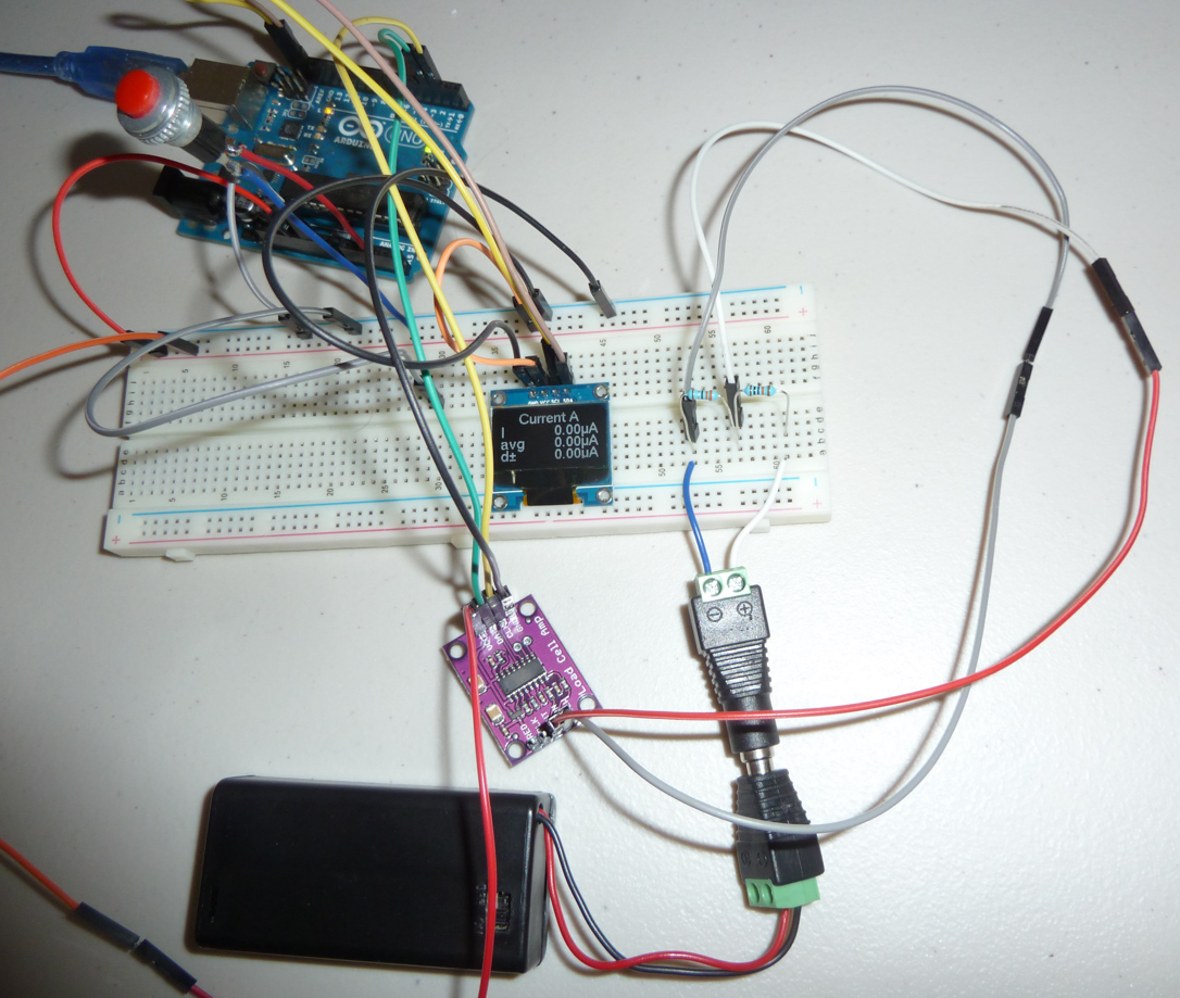

                                    OK, I received an HX711 and have partially hooked it up. I have it connected to an UNO and powered by the 3.3v pin. I also have AWI's sketch running on the UNO. I haven't yet connected a OLED screen to it, so at the moment I'm just looking at the output of the serial consol, which gives a running output of "average" and "spread". I have 10mv connected between A+ and A- to just to see what it will do.
                                    Looking at the code, it looks as though the button (A2) is normally pulled high. Is the button supposed to be connected to GND through a 330 ohm resistor? I don't see any schematic with a button on it.

                                      @NeverDie the sketch uses the internal pullup:
                                      Button myBtn(buttonPin, true,  true, 40);				// Declare the button( pin, pullup, invert, debounce ms)
                                      NeverDieN 1 Reply Last reply

                                        Right. So that's one leg of the button. Is the other leg connected to GND through a 330ohm resistor? Or....?

                                          @NeverDie sorry. Of course you knew that already :)
                                          I found this in the instructions:
                                          Solder the Button to A2 and Gnd of the nano
                                          I guess that means the other leg is connected directly to GND, no resistor is involved there?
