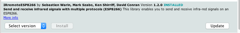

                    I ordered some of the MySweMosIRShield PCBs (after som minor modifications) an now while I wait for them to arrive I started looking into creating a sketch. I thought I would start from the example @emc2 provided but I cannot get it to compile and I don't know why.
                    Seems like it has something to do with the data types used. I tried both the github version and the latest available version via the Library manager of the IRremoteESP8266 Lib but same problem.
                    Arduino IDE 1.6.11
                    My Copy/paste coding skills are to no use if I don't have something that works to start from :(
                    C:\Users\Tomas\Documents\Arduino\MySWeMosIRShield\MySWeMosIRShield.ino: In function 'void handleIr()':
                    MySWeMosIRShield:316: error: no matching function for call to 'IRsend::sendRaw(unsigned int [83], unsigned int, int&)'
                             irsend.sendRaw(eufyAUTO, sizeof(eufyAUTO) / sizeof(eufyAUTO[0]), khz);
                    C:\Users\Tomas\Documents\Arduino\MySWeMosIRShield\MySWeMosIRShield.ino:316:77: note: candidate is:
                    In file included from C:\Users\Tomas\Documents\Arduino\MySWeMosIRShield\MySWeMosIRShield.ino:127:0:
                    C:\Users\Tomas\Documents\Arduino\libraries\IRremoteESP8266\src/IRsend.h:37:8: note: void IRsend::sendRaw(uint16_t*, uint16_t, uint16_t)
                       void sendRaw(uint16_t buf[], uint16_t len, uint16_t hz);
                    C:\Users\Tomas\Documents\Arduino\libraries\IRremoteESP8266\src/IRsend.h:37:8: note:   no known conversion for argument 1 from 'unsigned int [83]' to 'uint16_t* {aka short unsigned int*}'
                    • Tomas
                    • E Offline
                      E Offline
                      emc2
                      Short and not perfect answer, they changed everything when they updated the library to >2.0.
                      For a quick way to test your board etc, you can compile the example sketch by reverting to version 1.2.0
                      Ideally you may want to upgrade your sketch to be compatible with version 2.0 according to this https://github.com/markszabo/IRremoteESP8266/wiki/Upgrading-to-v2.0
                      I wanted to do it, but completely forgot about it... Will try to have a look at it tonight, but hopefully you can start testing everything using the old library version.
                      May also ask what minor modifications you did? Always open to suggestions to improve the board.
                      • E Offline
                        E Offline
                        emc2
                        wrote on last edited by emc2
                        Actually was not too bad to update.
                        I pushed the updated example sketch to github and openhardware, compatible with IRremoteESP8266 v2.0 and up.
                        I did a quick test here, no errors, and the vacuum cleaner already escaped to the bedroom, so good to go!
                        As for the board, feel free to share any sketch here or on github.
                        • korttomaK Offline
                          korttomaK Offline
                          korttoma
                          Thanks emc2 for your fast responce. I almost got it working myself but I guess I missed the:
                          #include <IRutils.h>
                          Compiles fine for me now also. Now to see if I can change it to my needs.
