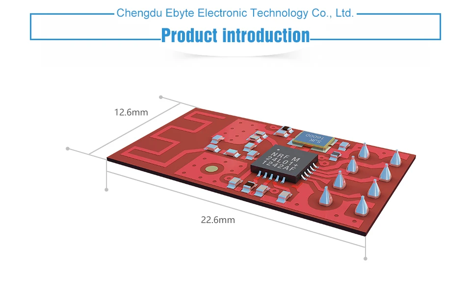

                            while takling with a manufacterer of nRF52 modules I have seen the product catalog. This http://www.ebay.com/itm/2pcs-E01-ML01D-100m-nRF24L01-2-4GHz-RF-wireless-transmitter-and-receiver-module-/191974998709 looks like an compatible module with original chip.
                            There are other modules available:
                            • http://www.ebay.com/itm/2pcs-E01-ML01S-2-4GHz-0dBm-110m-nRF24L01-Wireless-RF-transceiver-module-/191975027028
                            • http://www.ebay.com/itm/2pcs-E01-ML01SP2-1-2km-nRF24L01-PA-SPI-RF-wireless-receiver-transmitter-module-/191975030838
                            • http://www.ebay.com/itm/2pcs-E01-ML01DP4-2-4GHz-800m-nRF24L01-PA-LNA-SPI-Wireless-RF-transceiver-module-/191974974697
                            • http://www.ebay.com/itm/2pcs-Ebyte-E01-ML01DP5-2-4GHz-nRF24L01-PA-LNA-RF-wireless-transceiver-module-/191966308256

                                I don't know that. The ebay page says the chips are direct imports from Nordic. I have ordered nRF52 modules. In comparison with other shops the modules are well documented and complete (DCDC inductor, two oscillators). After placing my order I got the datasheet. I have ordered a lot of different nRF5 modules via eBay or Aliexpress. This is the first time I've got a documentation. I have asked a question and god a fast response. My question is discussed with the R&D at Friday.
                                This manufacturer sells nRF5 and a lot of other modules. As I know, there are no clones for nRF5 available. If they selling fake nRF24 modules, I think they god problems to order nRF5 chips from Nordic. If they selling bad modules, they have problems to sell other modules. There are only positive ratings at eBay and Aliexpress.
                                Ratings for nRF24 modules:
                                • "Smaller then the ordinary black one, and wakes up faster from sleep, All good"
                                • "Works fine and very fast delivery, will order another one still"
                                • "Absolutely the best NRF I could get, Top , Top ,Top..."
                                • "First seller which sells GENUINE NRF24L01+ from NORDIC.Thank you very much!!!"
                                I have ordered two nRF24 modules for testing.
                                  Let's hope for the best 😀

                                    Yes I have ordered NRF24 modules from EByte too (small SMD version) in addition to NRF52.
                                    If the range keeps the promises (with better antenna and genuine chips) I will only use those.
                                    They also have through hole version that use a much smaller crystal (the same than on SMD version), which will allow thinner modules even with non SMD version as crystal on classic NRF24 module sucks. They have a "shop" on AliExpress too, with little extra discount at the moment.
                                    https://cdebyte.aliexpress.com/store/2077046

                                          It turns out I have this product already. I purchased it two years ago from a different seller on ebay. A couple small observations about it:
                                          1. I really do doubt that it's a 4-layer board as they are claiming. The board is very thin, and I don't see any evidence of there being more layers than just top and bottom.
                                          2. The NRF24L01 chip on the module I have is rotated 180 degrees relative to the one in the Ebyte rendering.
                                            However, all the lettering on the chip is exactly the same.
                                          Here are some photos of it:
                                          N 1 Reply Last reply
