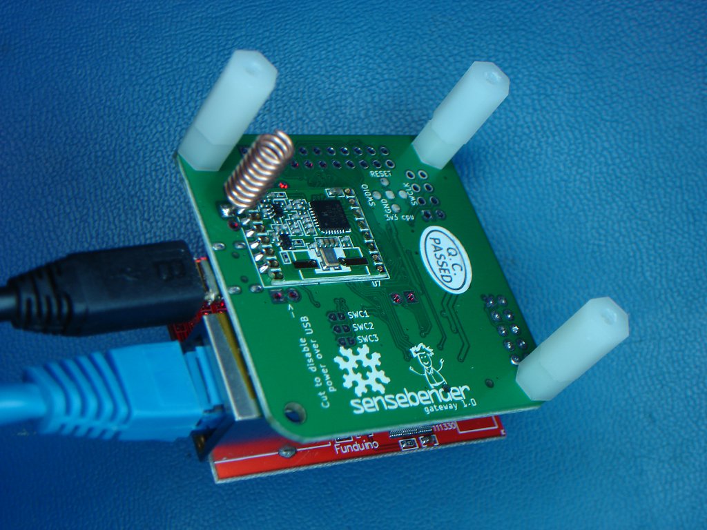

    Now with the remaining hardware on hand the next step was to assemble the gateway (aka GW).
    My gateway parts:_
    Radio, Sensebender_GW, Ethernet Adapter
    === PHOTO === PARTS ===
    _Soldering the radio: _
    I used 0.020” diameter no-clean 63/37 solder. While this is not “no lead” solder, it is best for hand soldering many parts. The reason is that 63/37 has no solidus phase which means it essentially goes from liquid to solid reducing the possibility of “cold” solder joints. The diameter is not critical, however the small solder diameter makes it much easier to control the solder amount and get nice looking joints. If you are not good at soldering small parts I suggest you get some small diameter solder.
    Soldering the radio to the gateway
    === PHOTO ==== Soldering radio ===

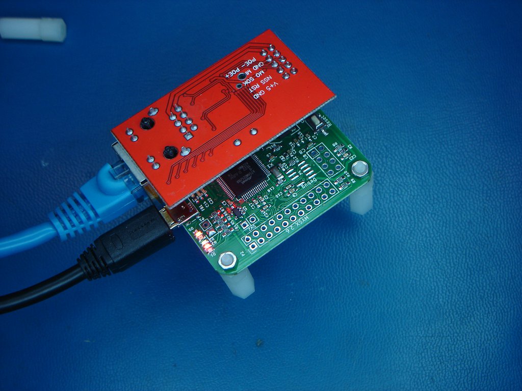

    Ethernet Header:
    When soldering the Ethernet (W5100) header, the instructions on the MySensors website tells you to raise the header as high as possible. Because the Ethernet jack is taller than the header socket. When doing this be sure you can see the outline of the header pins through the solder. If not you could have a condition where the solder bridges the hole and not reaches the pin. This would result in a poor connection which if it becomes intermittent could be a bear to troubleshoot.
    === PHOTO === Ethernet header ===
    One issue I found when installing the Ethernet board was a possible interference between a resistor on the gateway board and the metal Ethernet jack housing. I put two layers of Kapton tape on the jack housing to keep them from shorting.
    The Final Gateway Assembly:

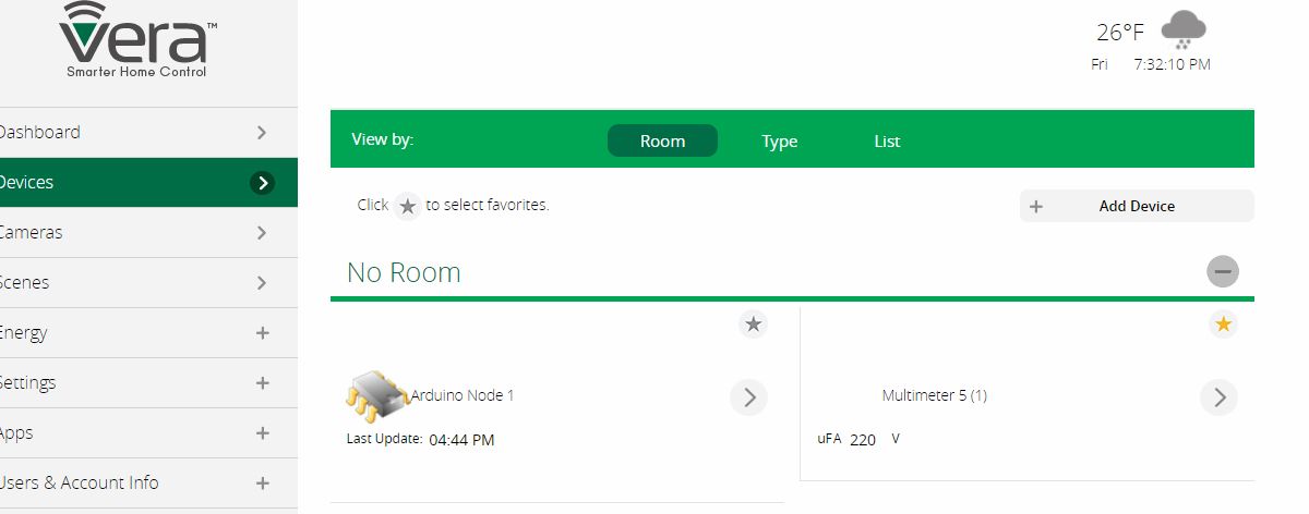

    I ended up with a device in Vera that looked like this:
    ===Vera MySensor device ===

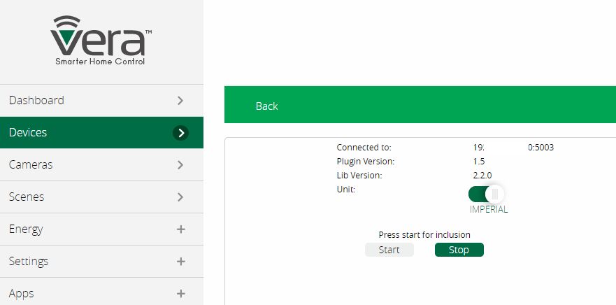

    In the above device under “settings” I found the below screen:
    === Vera Include Screen ===
    How I included my node:
    • Turn off power to the node.
    • Press the “Start” button in Vera (see above)
    • You will see 0 devices found
    • Power on the Node
    • In a few moments you will see 2 devices found.
    • I waited for the inclusion to time out
    Vera then showed two new devices: (see below)
    === Vera device screenshots ===
    The Multimeter is only setup to report Volts (see node code). The displayed value incremented in steps of 5 as programmed by the node code.
    All worked well!! Amazing.
